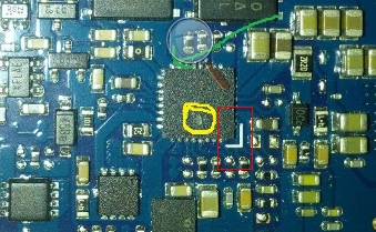

    How do you know that's PC205?
    I've got a volt reading here:
    Here are some extra images you can see to look for DCBATOUT:
      Re: Sony VPCSB (MBX-237) dead after bios flash
      This chip has 32 pins, so, if pin 1 is the one near the white angle mark, then you can count pins anticlockwise, and you have it.
      Now, having a look to schematic, PC205 is connected to pin 7 (and its value is 4.7U_10V, so it has to be a big ceramic cap) and PC259 is connected to pin 6. (just the one beside PC205)
      I can be wrong, and I would need a closed look to the burnt circuit to be completely sure.

        How many volts should I be reading in PC205 and PC259?
        Here are some closed up pictures:
          PC205= +5VALW_LDO should have 5 volts
          PC259= ? (I have no data, I am trying to get SN0608098RHBR its data-sheet, but with any luck)
          You should make sure you have +5VALW_LDO (its extremely important)
          Regards.
            I don't have correct readings, I'm getting 0.09v and 0.5v in PC205/PC259, so do you think the issue is in SN0608098RHBR?

              Could be that SN0608098RHBR is in short-circuit state, if so, you have to check PR324 not to be open.
              PC205 is connected to pin 6, and this chip is powered via this pin.
              BTW, SN0608098RHBR is equivalent to ISL6236.

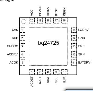

                                          Hi, orientalsniper. Here you have the bq24725 data-sheet.
                                          I hope you can find this chip in your Sony laptop, and also the BQ24725_VCC_R voltage from one of it´s pin. (you can locate this pin using an ohmmeter)
