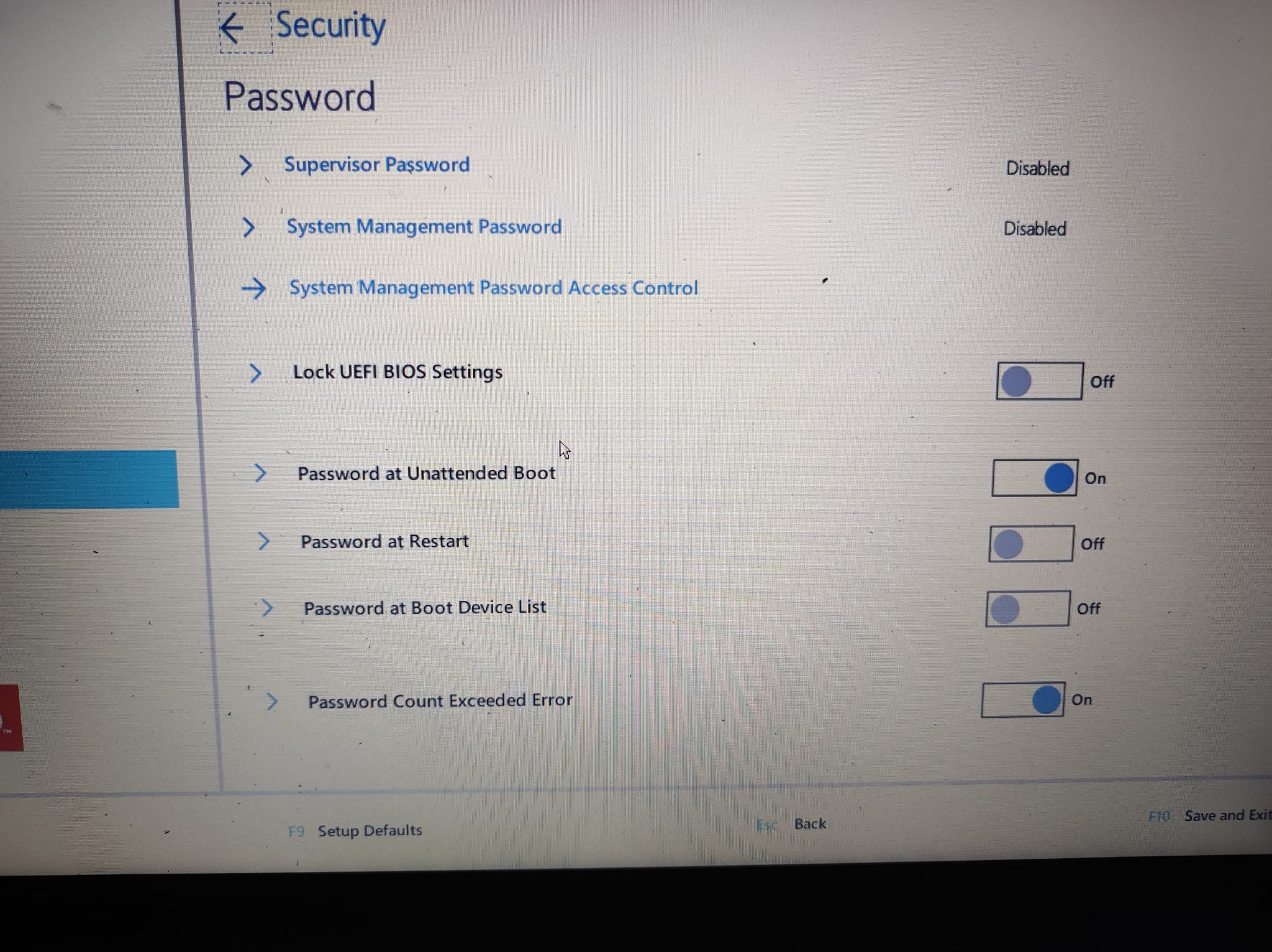

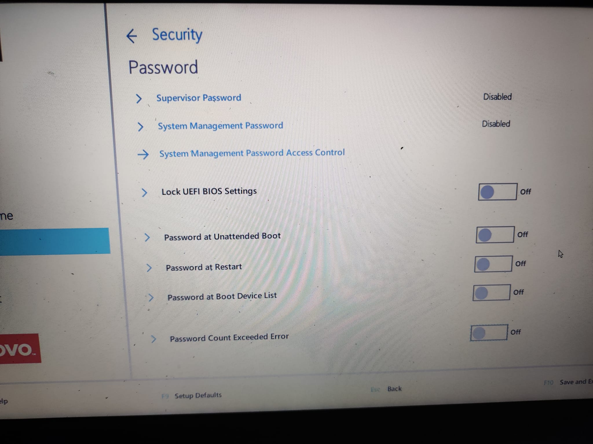

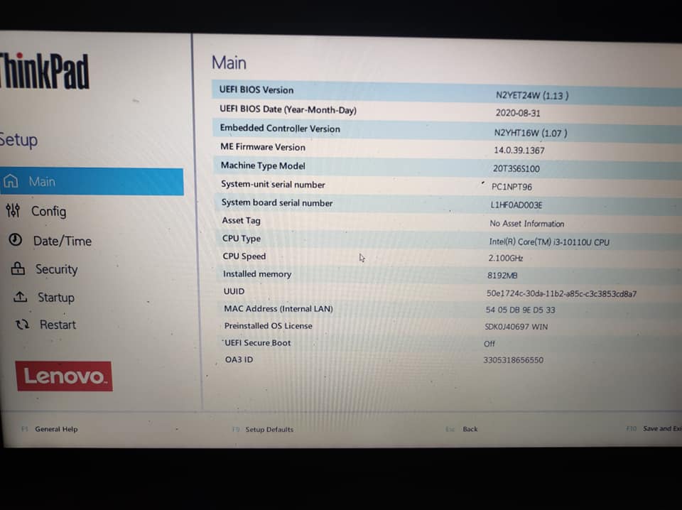

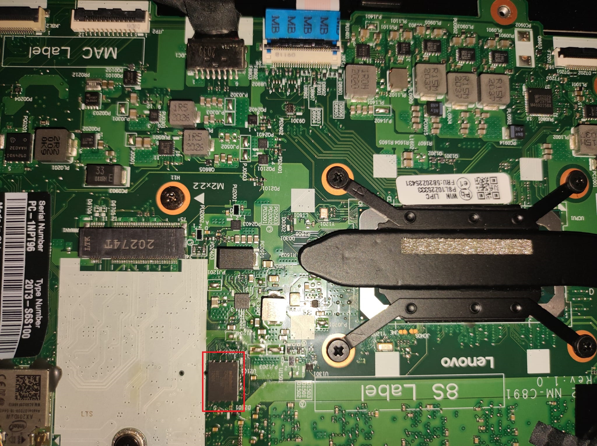

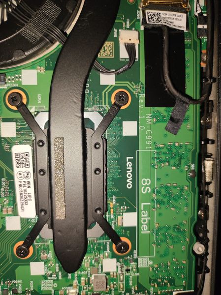

    hello guys
    i have a Lenovo X13 GEN 1 ( 10th)
    MOBO : GT4A3/GX3A2 NM-C891 REV 1.0 with a bios password
    i remove the main chip ( U2101) to try with lenovo patcher but it give an error ( 32mb ) chip READ only i didn't write any thing
    i remove the battery and the rtc battery
    after 1 hour i put back again the main chip and the surprise the password gone
    entring Bios restore default config
    without any moding the main bios file
