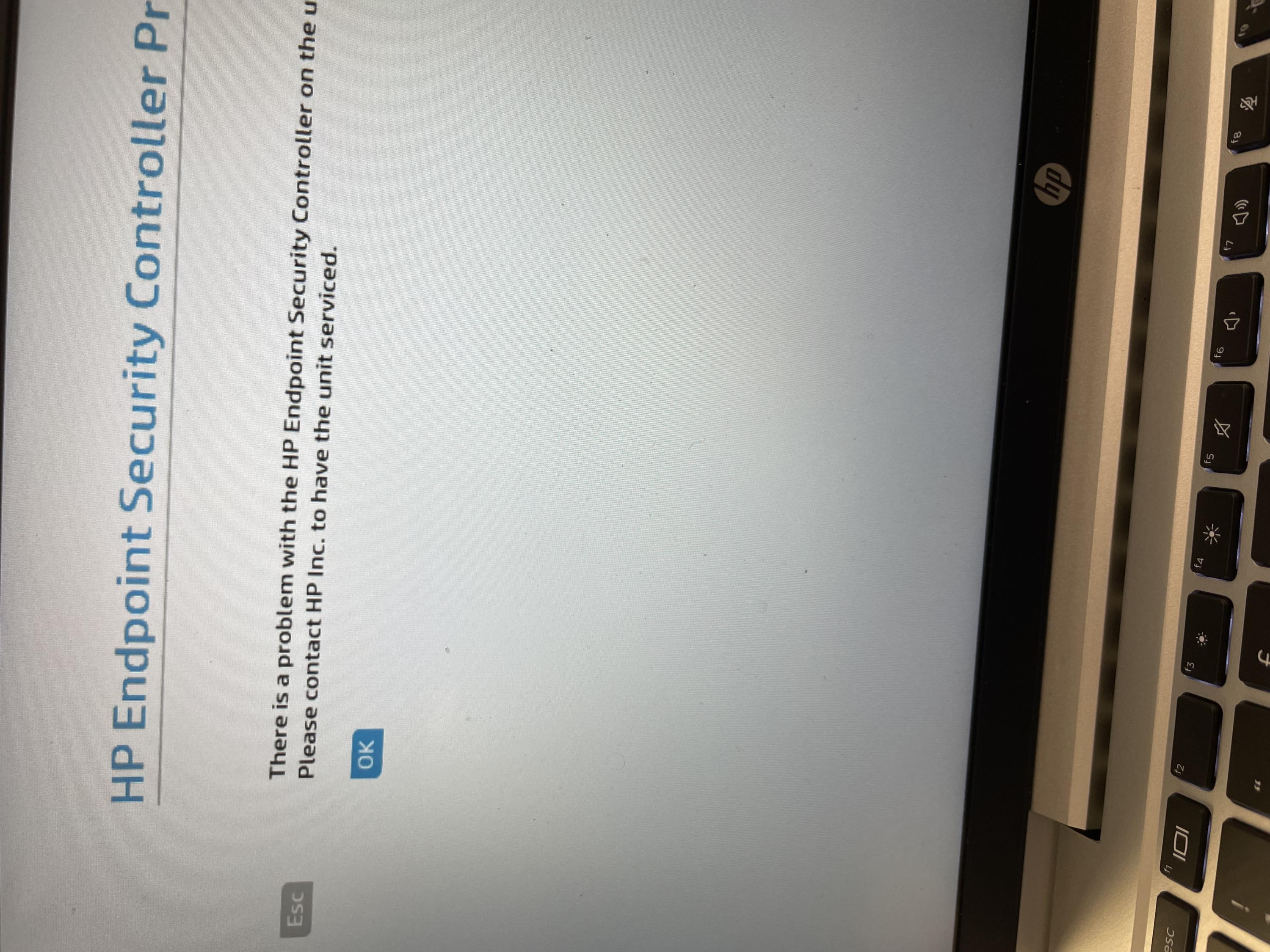

HP Probook 635 Aero G7 Endpoint Security Controller Problem
  • alfredodinolfo
    • Jan 2013
    • 128
    • N/A
    ProdID: 2W8R7EA#ABZ
    SN: 5CG10171VK
    mb code: LINDEN 6050A3147201-MB-A01
    Thank you

            sorry, now no end point but is in MPM mode and no serial on bios information. I tried to write with HP BIOS Configuration Utility sp143621.exe but no chance to write information sn etc.
            can you help me?

              Hi, I have a problem with the "endpoint security controller problem" error.
              Can someone help me?
              I am attaching the Bios file in the attachment
              HP ProBook 635 Aero G7
              SN# 5CG10171CO

                    Hi, I dumped bios and EC.
                    SN# 5CG10171CO​

                        Are these ok ?
                        • alfredposadas09
                          • Aug 2020
                          • 343
                          • Philippines
                          Originally posted by Matteo Setti
                          Are these ok ?
                          just program u368
                          first boot press f10 go to bios setup and reset the settings to default
                          • Matteo Setti
                            • Apr 2024
                            • 12
                            • Italia
                            It doesn't work, the caps lock led flashes 7 times, as it did before
