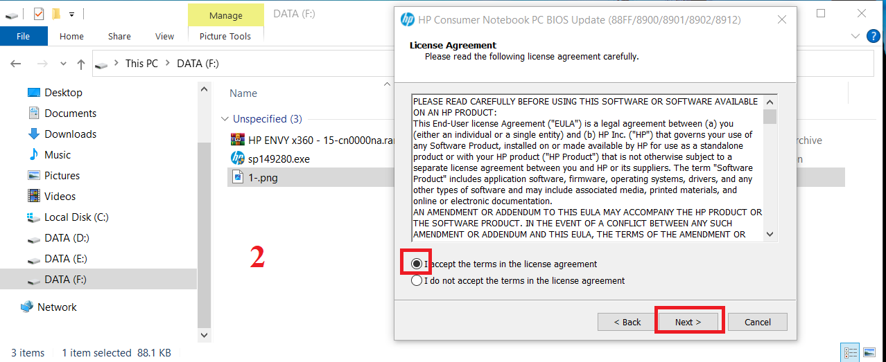

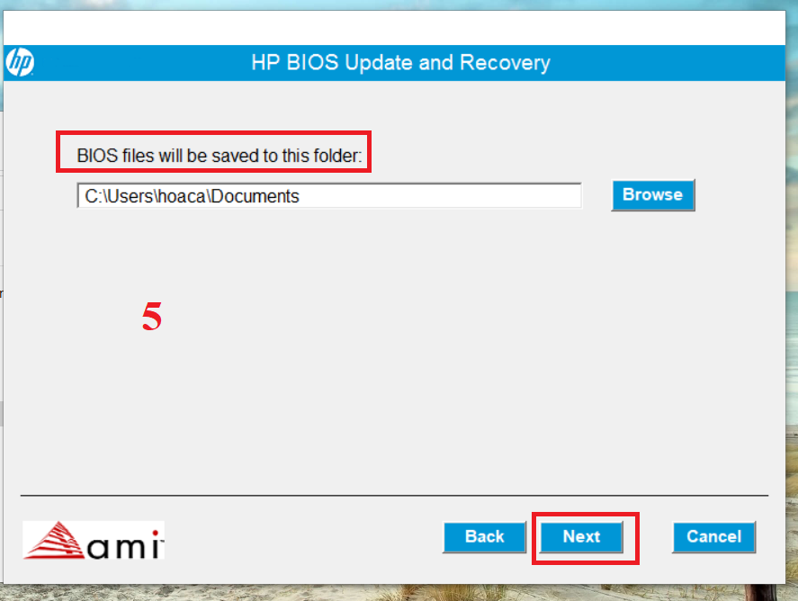

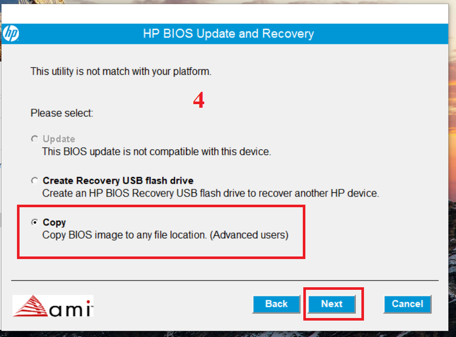

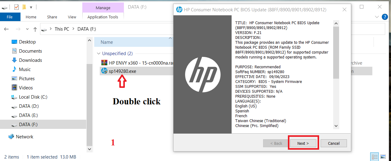

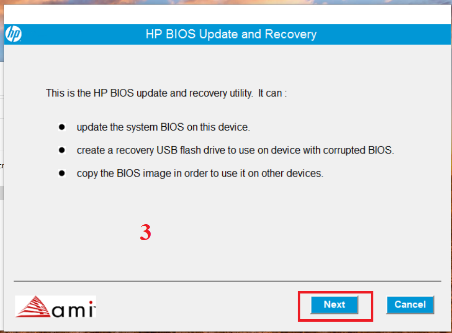

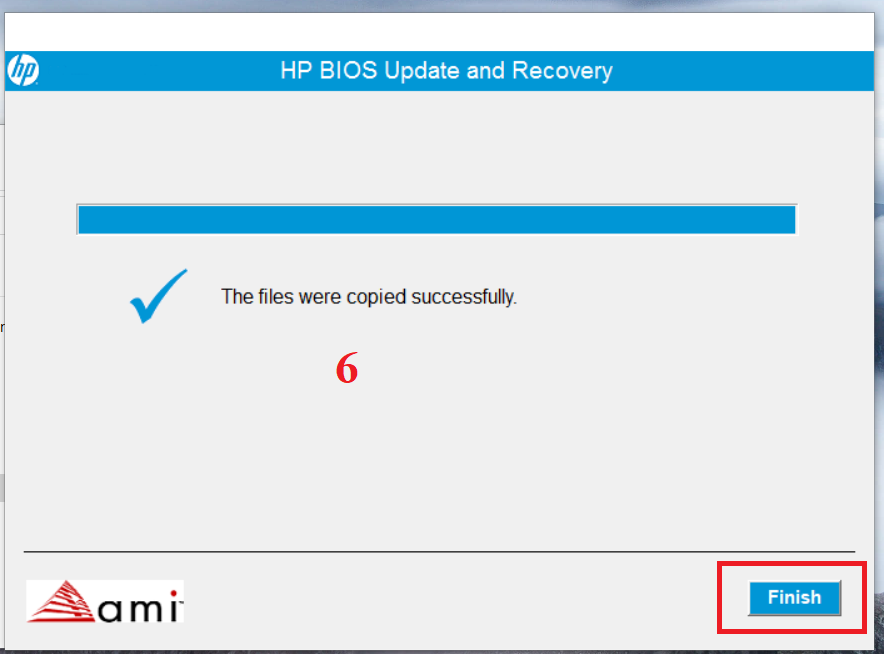

    Hello
    Can anybody help me with extracting this package? All older methos i was using don't work for this.
    HP Omen 16-c0215nw
    thanks

      Re: new hp omen amd bios extract help
      Thank You
      Can You tell me how to do this?
        Originally posted by thunderleg12
        Thank You
        see pictures
          ok it is then lastest windows update becouse when i start it nothing happens...
