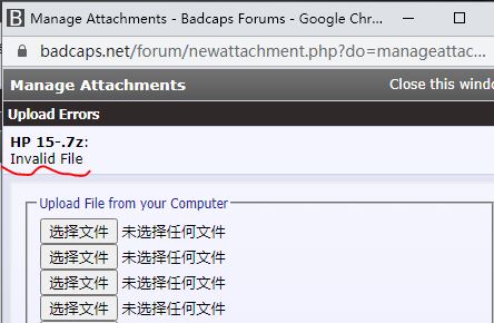

    Re: HP Omen15 2020 en0023dx bios unlock
    why i can not upload file attached ?
    • osman68i
      • May 2015
      • 348
      • The Netherlands
      Valid file extensions: bmp doc gif jpe jpeg jpg pdf png psd rar svg txt xls xlsx zip
      not.7z
