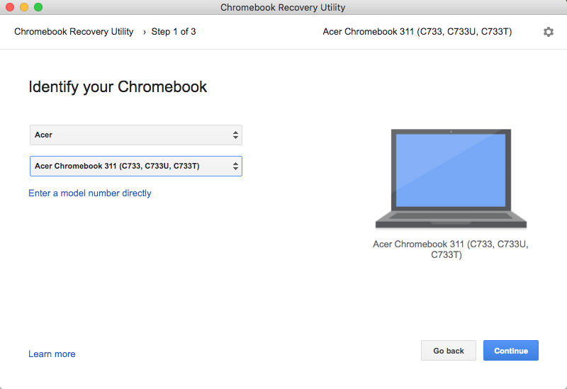

                              it should work if you REINSTALL from USB stick made for your model: Acer Chromebook 311 (C733, C733U, C733T)

                                Re: ACER ChromeBook C733-C5AS
                                Thanks for the info @volinakis., I will surely try this one more time. The photo which you have showed me, I made the exact USB (8GB) restore as per the model's description. I will keep you updated.
