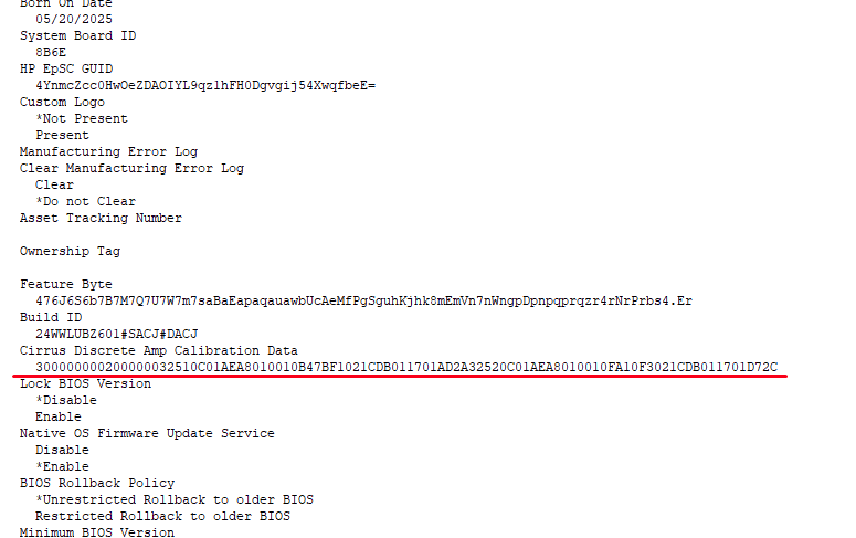

                  First try this value : 30000000020000001A1111015DAD0A00A017742FF782D80100018F2A1A0F11015DAD0A0010A0E132F782D80100018D2A
                  If not working you need to rewrite the original dump
                  Start Windows and use BCU tool to GET your CONFIG file and there you will find the needed data.
                  Write back the patched file use BCU tool and insert the needed line/data
                  As example look on this picture (Yours can be other...just an example)
                  Click image for larger version  Name:	image.png Views:	0 Size:	11.1 KB ID:	3754529

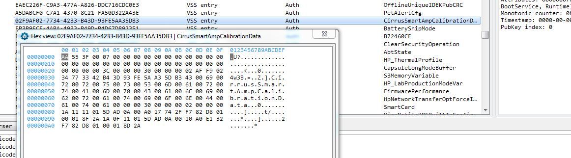

                    • 24906
                    #69
                    Originally posted by alext28
                    Work thanks ! but i have an error with Cirrus Discrete Amp Calibration data , Where is this information?
                    UEFITool search
Name:	Capture cirrus.jpg
                    • alext28
                      • May 2020
                      • 56
                      #70
                      Originally posted by Stefan Steff
                      Well...you need to do some work to get that info...
                      Thank you very much, everything works
                      you rock !! 🤘
