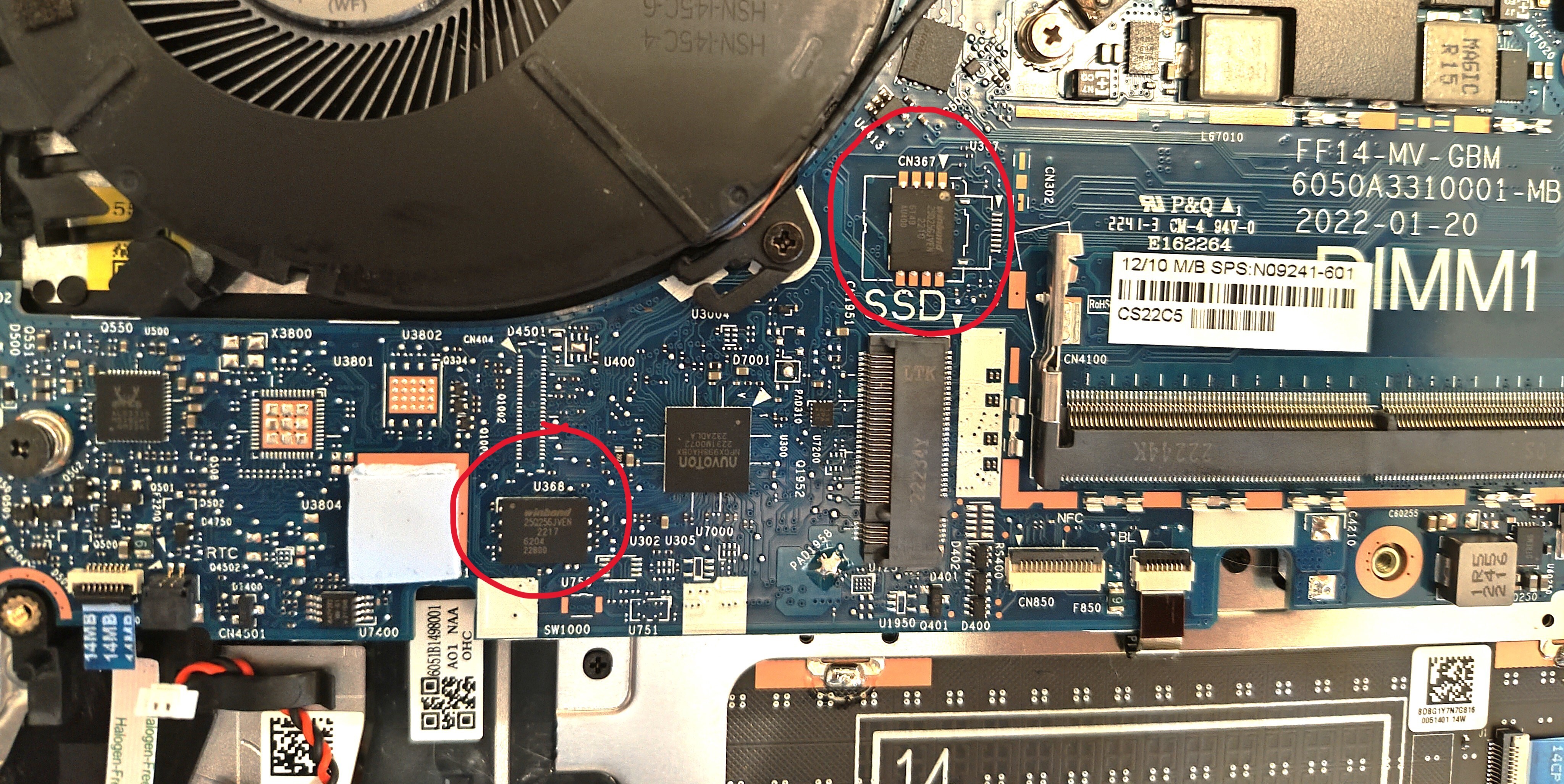

                        • trepachka
                          • Oct 2022
                          • 457
                          Please, help me remove bios lock for HP Zbook Firefly 14 G9 with Serial# 5CG3161CFB
                          I am providing 2 bin files, one from each 25W256JVEN chip I found. One chip is located at the front and the other chip is located on the back of the motherboard.
                          I am not sure which files is needed, so I am providing both.
                          Thank you kindly.
                          • hoaca388
                            Badcaps
                            • Jan 2022
                            • 12333
                            Thank you kindly.
                            Unlocked
                            • trepachka
                              • Oct 2022
                              • 457
                              Thank you. The bios lock is gone. However, I am getting "Device in manufacturing mode" message on boot. Is there a command I can run similar to Dell's Alt-F to exit this mode?
                              • qayyum786
                                • Aug 2018
                                • 1959
                                • INDIA
                                you can use hp tool BCU fill the further detail from bottom panel or from sticker
                                • trepachka
                                  • Oct 2022
                                  • 457
                                  It took me a while to figure out how to install the utility and use it successfully but the manufacturing mode has been disabled.
                                  Thank you for all your help.
                                  • volinakis
                                    • Jan 2021
                                    • 2874
                                    • N/A
                                    if you restart laptop how many times MPM counter shows it will exit from manufacturing mode (MPM). BCU have to be used under cmd.
                                    • trepachka
                                      • Oct 2022
                                      • 457
                                      The MPM counter started @ 35 and went down all the way to 1 but wouldn't go down any further until I provided the information provided by hoaca388 such "Feature Byte", "CT Number", etc.
                                      Only after I provided all of this information, the message on the screen came up and asked me whether I wanted to submit this file. Once I answered "Yes", then MPM went away.
                                      • redoxy
                                        • Sep 2018
                                        • 100
                                        Can someone please tell me what the part # of the BIOS chip is? I need to unlock my BIOS but when I opened the laptop, I see two Winbond 25W256JVEN chips (U367, U368) and I'm confused about which one is the correct chip to read/backup. Thanks in advance.
                                          SMDFlea commented
                                          Editing a comment
                                          Theres a clue in the filename at post 14. If youre still unsure just post both.
