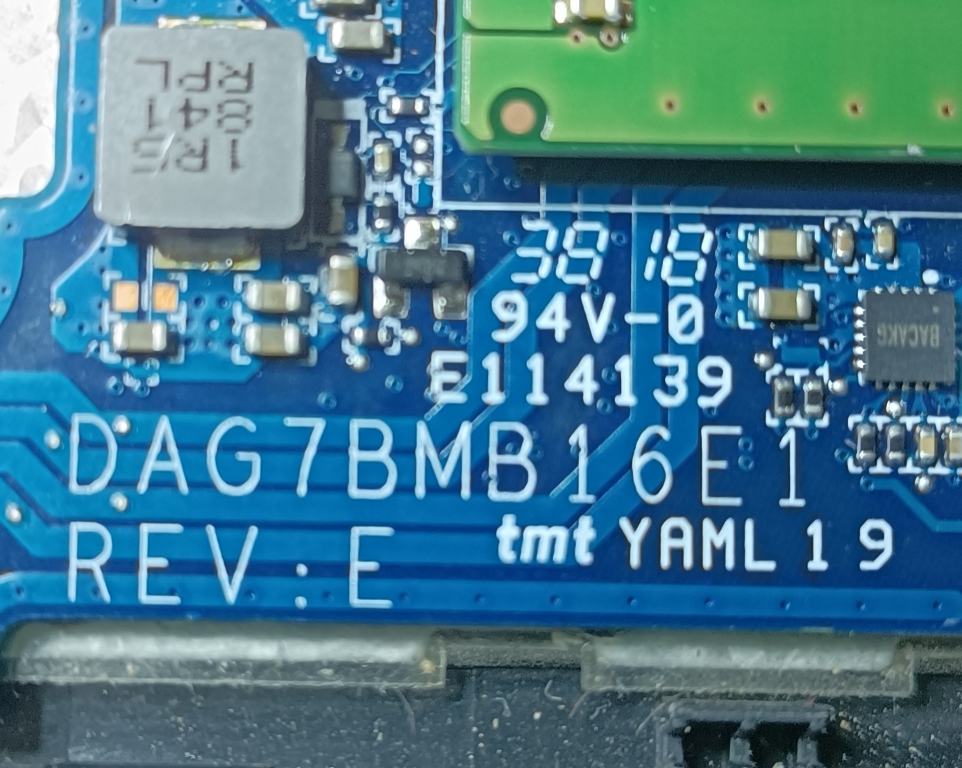

    Please could someone assist me with a working Bios for an HP Pavilion 15-eg1008ni - Motherboard is a DAG7BMB16E1 REV:E and I have attached the current BIOS BIN file. Thank you!

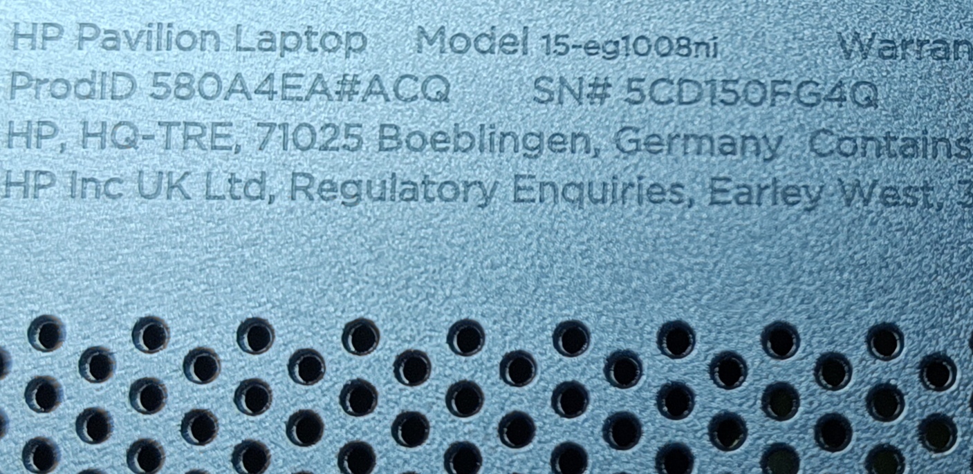

    The bios you posted is for a 15-cs0xxx .Can you post the serial number thats on the base.

      I have attached a photo of the bottom cover details

        Here is the board model

            Thank you, the board powers up, I get fan spin but the caps lock light blinks 5 long and 3 short blinks. The board is drawing 450mA when the caps light blinks

              according to the s/n posted, this should be the bios...probably someone else wrote a bios with a different BID before...

                It could be the right bios posted.The DAG7BMB16E1 REV:E motherboard is for 8th and 10th gen i think. The 15-eg1008ni is 11th gen, so maybe its a different base cover,or sticker ? .

                  The BIOS chip is a GD25Q64x [3.3V] 64 Mbits, 8 Mbytes, so a 16Mb bin file can't be correct. The processor is an 8th gen i7 and the board has an Nvidia GPU
