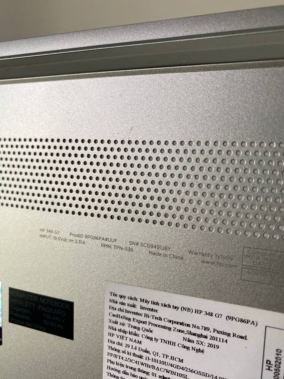

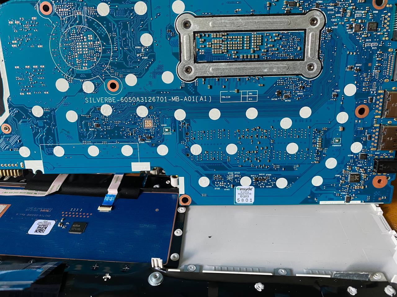

    Hello everyone, I wish you all good health, I have a HP 348 G7 laptop
    main code SILVERBE-6050A3126701-MB-A01( A1 ) please help me, thanks everyone

          bios extracted from the HP website update, the laptop has four bios variants, yours is 086CD..
          DMI+KEYWIN 380000 - 38103F

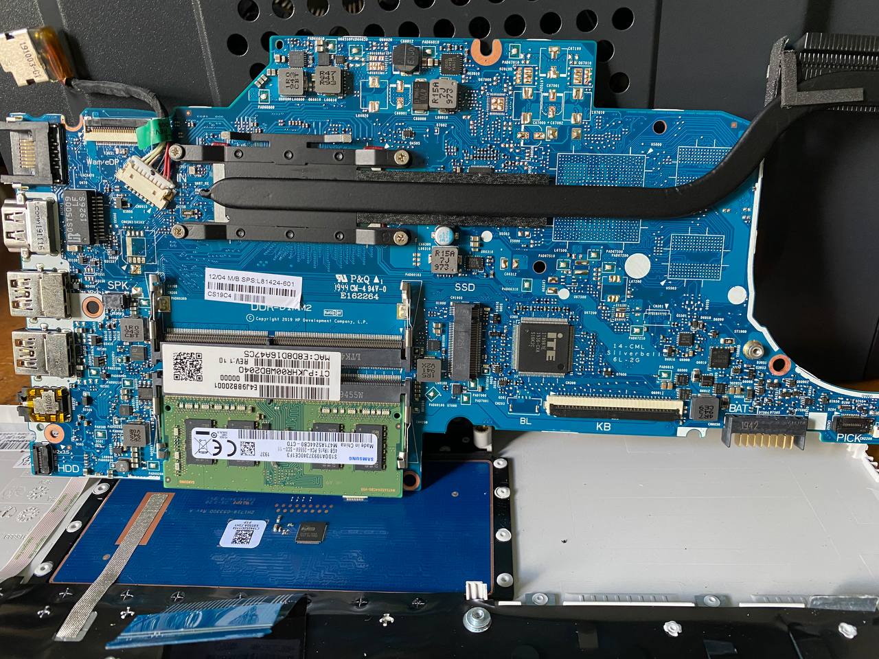

            i need to exclude bios , i am suspecting my bios has problem , thanks

                  Go to the HP support site,enter the laptop serial number,download the bios update.Run the exe ,it will give an option to update,make a recovery drive or copy to a location.If you choose the copy option all of the bios that are included within the exe are decrypted and saved to the location you chose.Sometimes there are multiple bios included in the update,they are not all for the same machine/model.Finding out which of the bios is the right one for your machine is the next step by looking at your backup with a hex editor to see if any of the new bios names match with the names in your backup.
