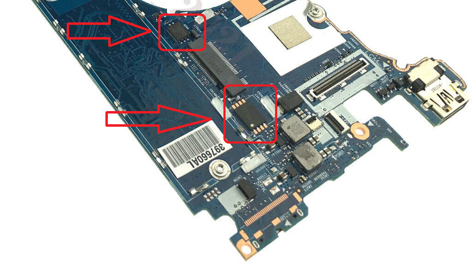

    Can you please tell me the actual location of the 16MB chip? I have the same board and can't find it anywhere...Can you help me out?

      • patcopley1
        • Jun 2021
        • 11
        Re: HP Elitebook 1040 g6 need dump bios
        Originally posted by Vesko356
        OK good, I got the dump off the right one...
        Attached are my main and EC dumps

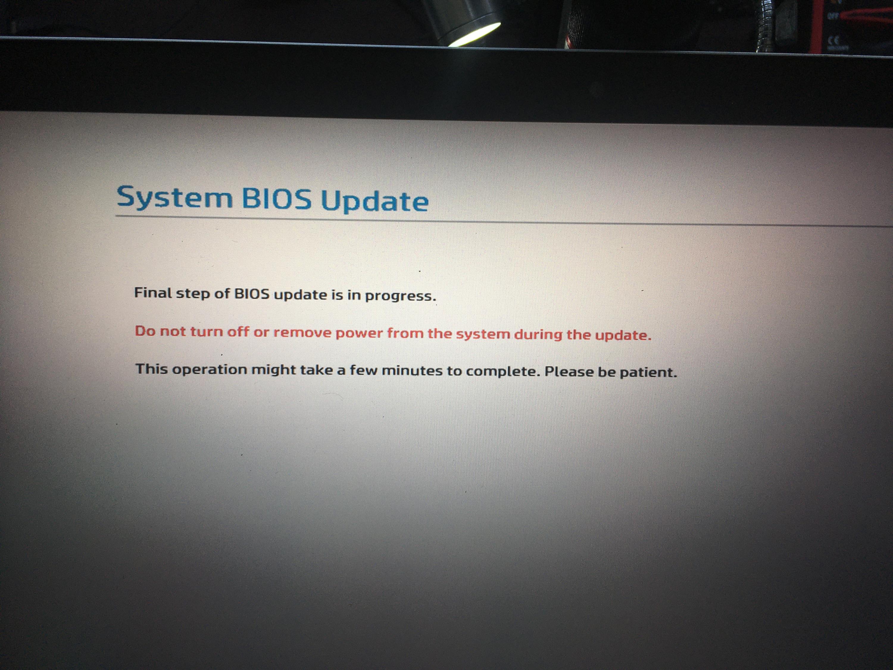

            Hp elitebook x360 1040 g6 Bios need
            Hi everyone here
            I need your help, i'm looking for bios bin for this Hp elitebook x360 1040 g6
            Board number: BRIGHTON_6050A3037501_MB_A1
            S/N:5CG021BBTF
            the laptop was working fine until i decide run window update, after updating ,
            system reboots severy times and get stuck on bios updating(see image below). After 24 hours waiting for the progress, i off it. Now if you on it , it stays stuck on Bios updating.
            i tried flushing bios with another bios dump but the system didn't turn on.
            here is the original dump if sombody could help me repairing it.
            thank you

              • alas3376
                • Nov 2011
                • 382
                • BENIN
                Re: Hp elitebook x360 1040 g6 Bios need
                Originally posted by hoaca388
                ccccc
                thank you very much,
                i tried with the one you sent, but still get stuck on system bios update; no possibility to enter into bios setup

                  • hoaca388
                    Badcaps
                    • Jan 2022
                    • 12330
                    Originally posted by alas3376
                    still waiting for your help
                    thank you
                    Try without DMI

                    • alas3376
                      • Nov 2011
                      • 382
                      • BENIN
                      Try without DMI
                      thank you very much
