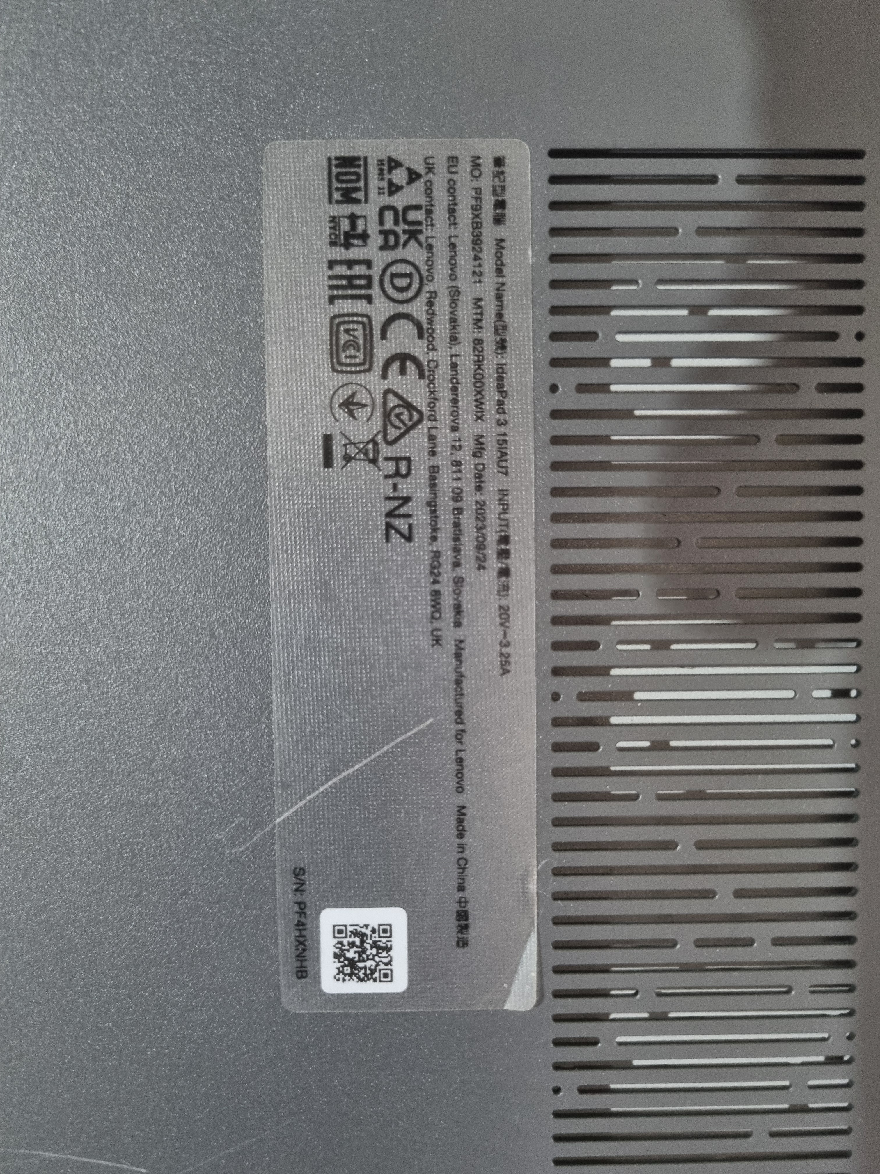

        • ministeri
          • Mar 2020
          • 12
          • Italia
          #84
          Hi everyone, the serial number is correct. I attach a photo of the plate with the model and serial number. Thank you
          • peste
            • Dec 2016
            • 14052
            • ROMANIA
            #85
            well, the letter "B" is missing at the end...
            go back to post #4..I solved the problem there..
