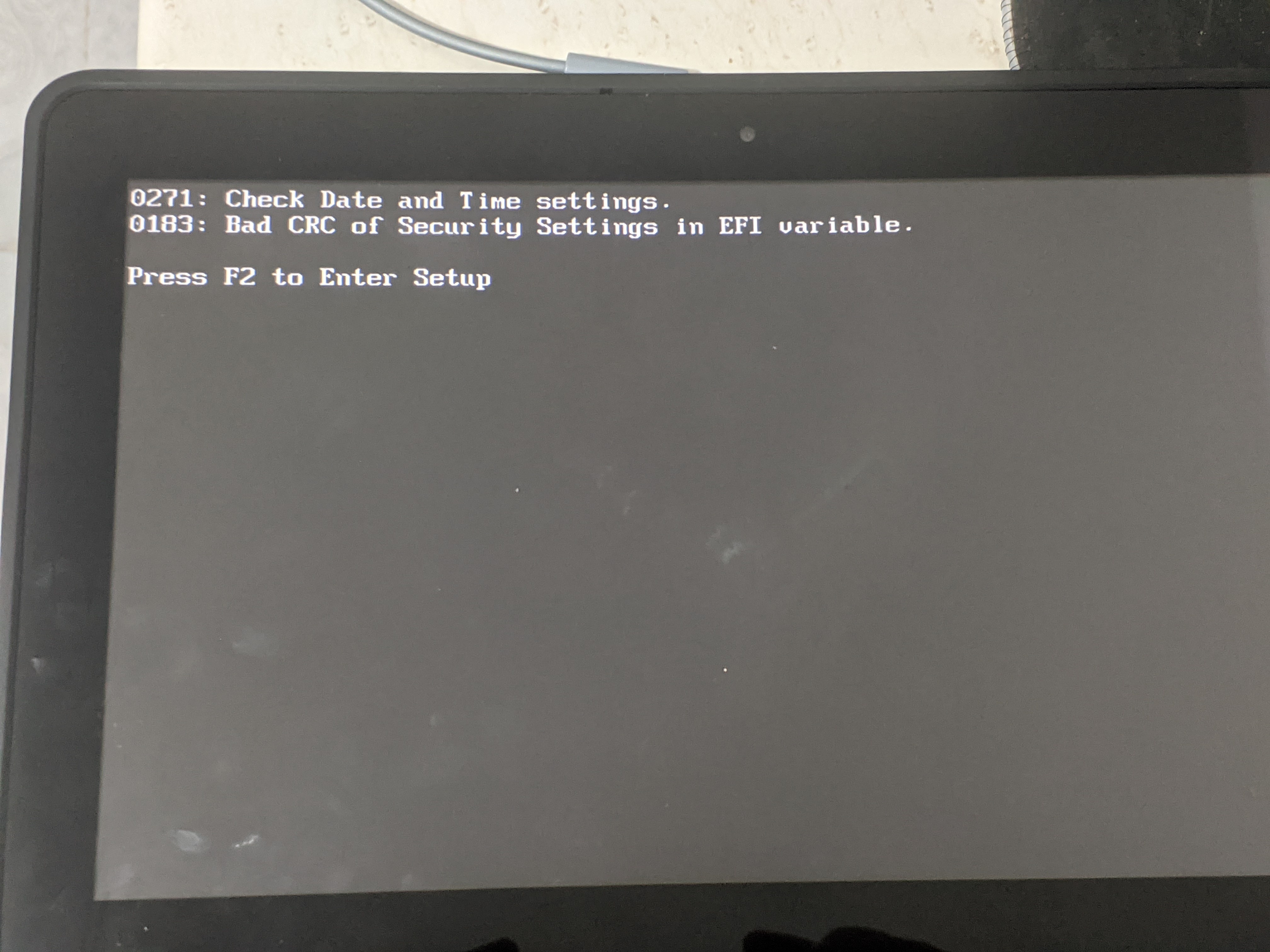

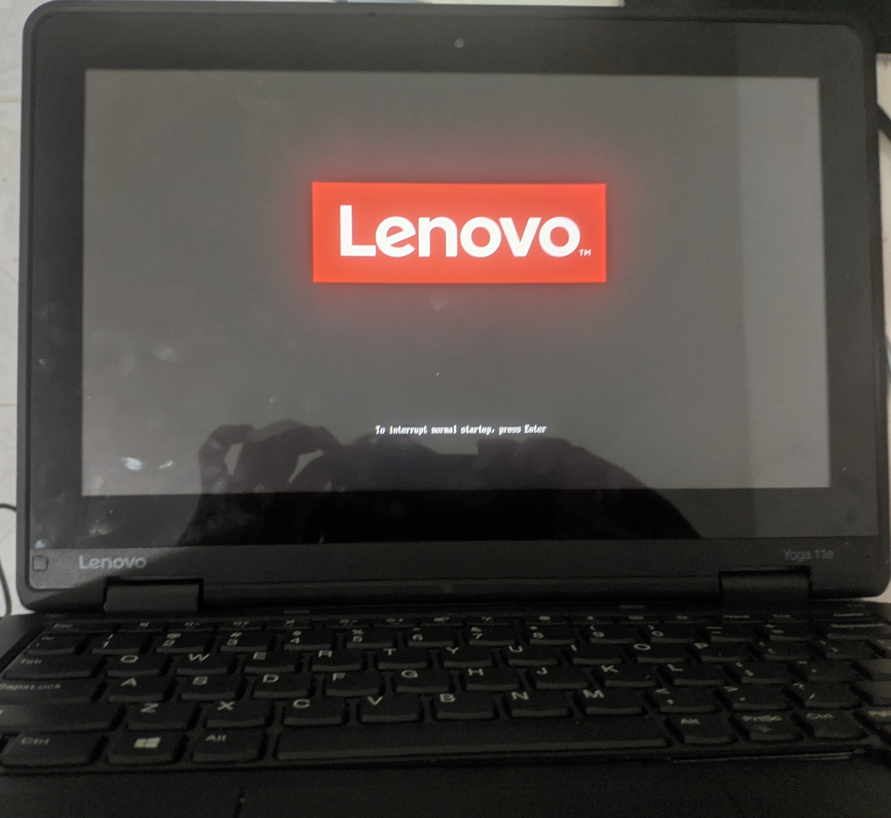

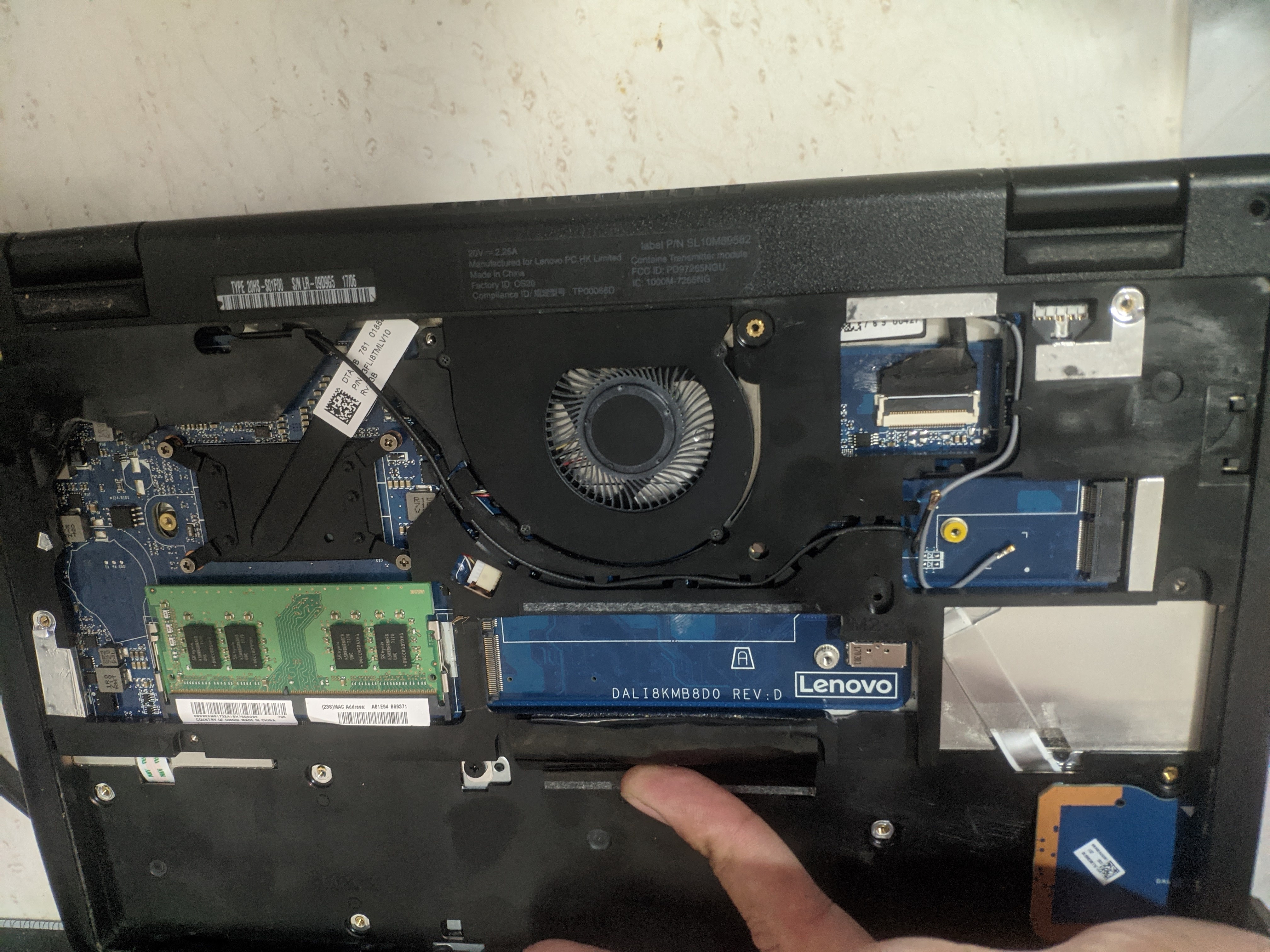

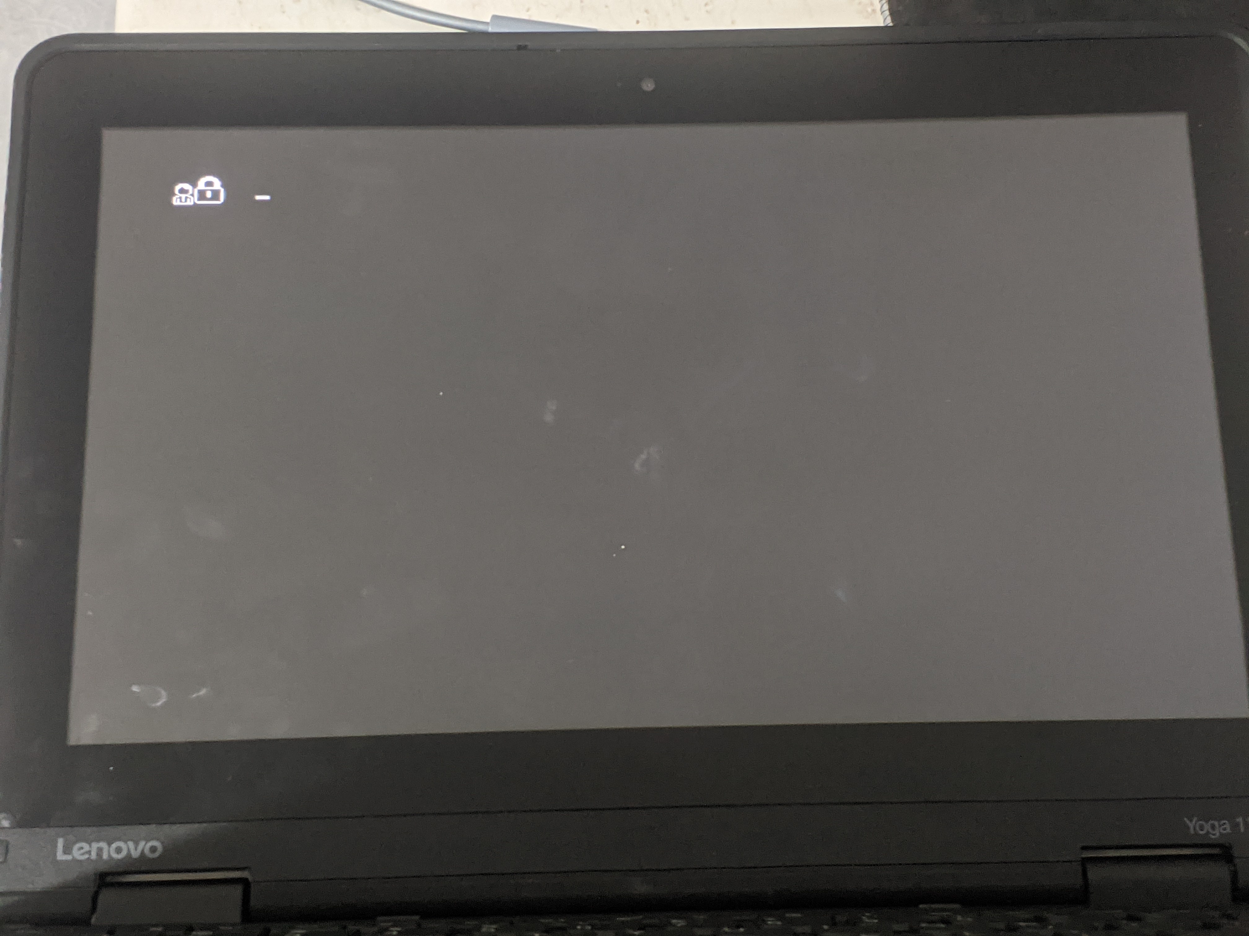

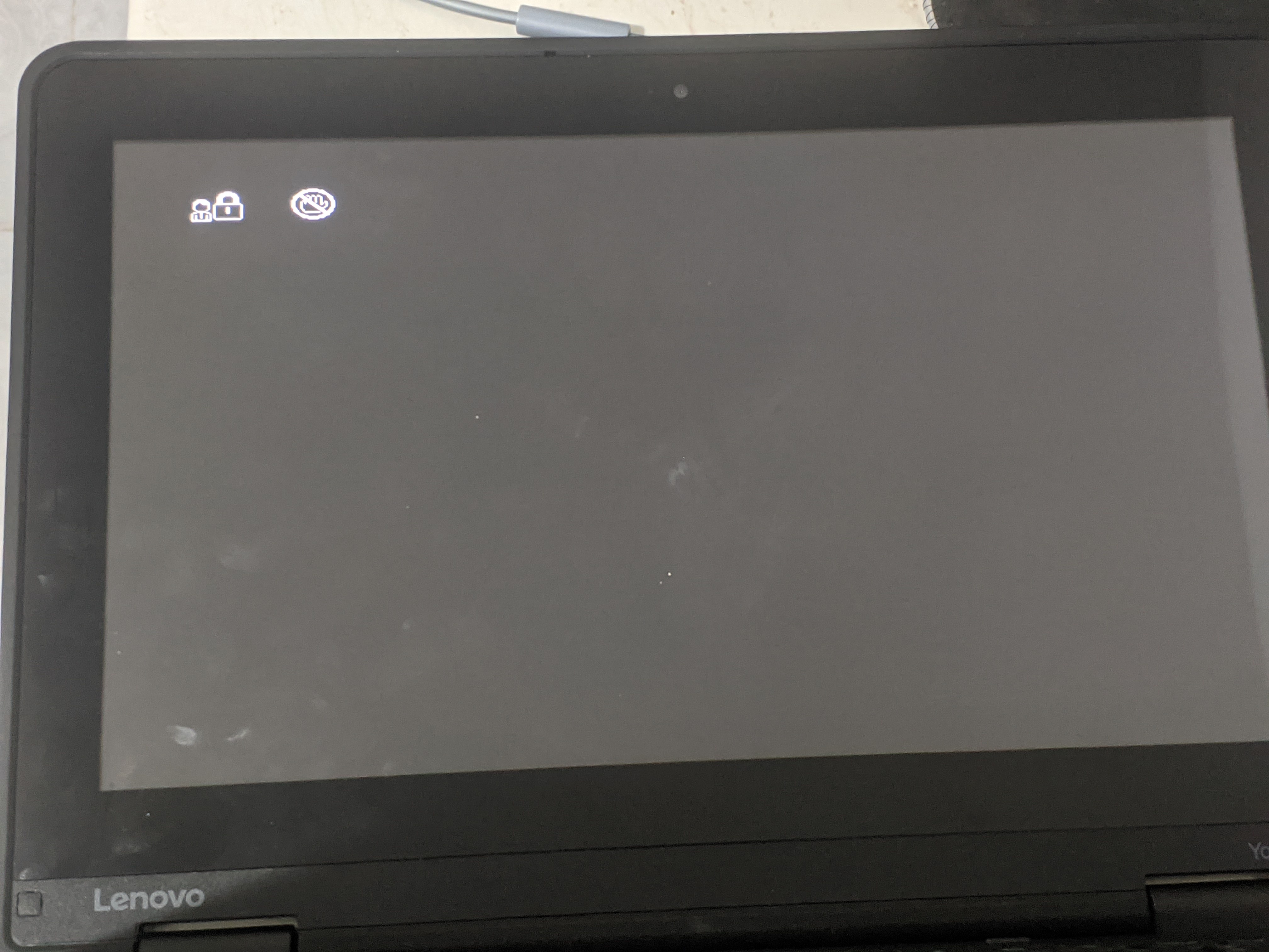

Lenovo Yoga 11e(4th gen) bios
HI TRYAttached Filesif you find these attachements useful please consider making a small donation to the site
Leave a comment:
i flashed another bios file, machine turns on but when i type F1 ask for password already tried 1234, nothing, zeros, fail again and turn off the laptop, today tried with the backup i made before and now doesnt work, fan at full speed with no video :cLeave a comment:
I updated bios with lenovo update before backup, rollback was enabled, computrace are enabled too, admin password are clean, i mean ask for password at "F1" key press, just type enter and go to bios but i cant modify anything, i cant disable tmp and secureboot to install S.O., i dont know if this extra info helps in any way :c, with a few tries of files from here the password at "F1" screen was not "nothing to write" just press enter no more...Leave a comment:
tryAttached Filesif you find these attachements useful please consider making a small donation to the site
Leave a comment:
DALI8KMB8D0 I mean, srryHi, can you help me with this bios? got computrace and supervisor password i flashed a few bios from here but always ask for password at "F1" screen, i entered 1234, nothing and zeros, then the machine turns off :c cause fail.
Model: Lenovo Thinkpad Yoga 11e 4th gen (Core i3 7th gen)
Type: 20HS-S01F00
S/N: LR-09D9G5 17/06
Motherboard code: DALI8KMB8D8 REV: D
Here is the backup from original bios. many thanksLeave a comment:
Hi, can you help me with this bios? got computrace and supervisor password i flashed a few bios from here but always ask for password at "F1" screen, i entered 1234, nothing and zeros, then the machine turns off :c cause fail.
Model: Lenovo Thinkpad Yoga 11e 4th gen (Core i3 7th gen)
Type: 20HS-S01F00
S/N: LR-09D9G5 17/06
Motherboard code: DALI8KMB8D8 REV: D
Here is the backup from original bios. many thanks
Attached Filesif you find these attachements useful please consider making a small donation to the site
Leave a comment:
Leave a comment:
RULES UPDATE for BIOS requests/offers AVOID BANNING, READ BEFORE POSTING
https://www.badcaps.net/forum/troubl...before-posting -
PLEASE HELP ME. I AM LOOKING FOR BIOS LENOVO YOGA 11e Intel Core M 5Y10c WITH MAINBOARD CODE DAOLI6MBAD0 REV: D.
THE BACKUP BIOS I HAVE IS CORRUPT.Leave a comment:
Yoga 11e 4th Gen Laptop (ThinkPad) - Type 20HS
​Attached Filesif you find these attachements useful please consider making a small donation to the site
Leave a comment:
ThisAttached Filesif you find these attachements useful please consider making a small donation to the site
Leave a comment:
post your original bios backup and laptop serial number https://www.badcaps.net/forum/troubl...before-posting -
I use a bios bin from here.after flashing bios mainboard hv no power.3v and 5v and 1v also present.powwr button hv volt and battery connector hv data clk 3.3v also.after pressing reset botton power supply show 0.045 load.before flash a bios ,there is no display issue.thwn reflash old backup file same condition,no power.then I noticed this mainboard is hv ci5 7th gen CPU DDR4 RAM.any suggestions please,3 PhotosLeave a comment:
tryAttached Filesif you find these attachements useful please consider making a small donation to the site
Leave a comment:
by to5it0Need Clean BIOS/EC Bin File for Lenovo ThinkPad Yoga 11e - Stuck with 0275 Error CMS
I am attempting a repair on a Lenovo ThinkPad Yoga 11e that is currently stuck at boot with the error: "0275 error CMS" even after setup new bios battery and will not allow me to enter the BIOS/Setup.
This is a critical issue that I believe requires flashing the BIOS chip directly using a programmer (e.g., CH341A/RT809H), as standard software updates or resets are not possible.
I have opened the laptop and identified the main BIOS chip...2 Photos-
Channel: BIOS Requests ONLY!
by maesonHi dear Badcaps-Community,
Somehow an auto update, which I triggered before I left my laptop unattended, bricked my BIOS.
I was able to extract the 2MB BIOS and 16MB BIOS which I will attend. (CH341B black with NeoProgrammer 2.2.0.10)
The Device is a Lenovo Yoga L13 Gen3 and I was able to identify the following specifications:
Lenovo Yoga L13 Gen 3 AMD:
Lenovo Modell: Type 21BB
Artikelnr.21BB006GGE
Seriennummer: PW0A6207
AMD Ryzen™ 5 PRO 5675U
Memory 16 GB DDR4-3200MHz
SSD: 512 GB SSD, M.2 2242, PCIe Gen4, TLC,...-
Channel: BIOS Requests ONLY!
by DiddiAbRecently I used the official Lenovo bios updater software on my ThinkBook 13s G3 ACN (20YA0005GE). The updating process failed and I got a black screen after powering the device. Of course I did not make an own backup before using the Lenovo bios updater.
I bought a CH341A programmer and was able to make a connection to the chip while it is still soldered on board. But I did not realise that the chip was a 16MB size and selected the wrong size (8Mbit / 1 MByte) before reading the content of my chip. So the dump I did before erasing the chip is only 1MByte big. I fear that I lost...-
Channel: BIOS Requests ONLY!
by WahazHello,
I found 3 bios chips on the board, which I read with a bios programmer: two XMC model bios chips and a Winbond model bios chip. Each XMC model bios chip has two partitions named XM25QH128A [3.3V] and XT25F128A [3.3V]. And the Winbond model bios chip has three partitions named W25Q80BL 3.3V, W25Q80xV 3.3V and W25Q80DV 3.3V....-
Channel: BIOS Requests ONLY!
by beogeekI've currently got a Lenovo Yoga Slim 7 14APU8 that is not posting. Its fan spins, the keyboard lights up, and the caps lock doesn't work. It was taken to some shop for cleaning, and then they updated or tried to update the bios. After that, there was no display and no post. I've removed the bios ic from the board and made a bios dump. I need some assistance going forward, as I suspect this is probably just a bad bios issue. I've tried searching for a dump, but no luck; if anyone can throw me a bone, it would be much appreciated!
Attached is the bios dump in the state I received it...-
Channel: BIOS Requests ONLY!
- Loading...
- No more items.
Leave a comment:
