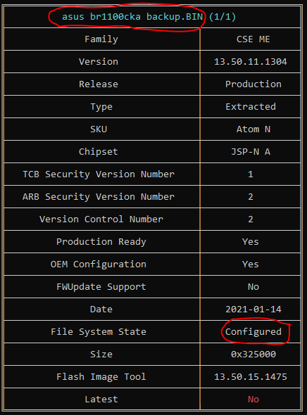

    Asus Vivobook BR1100CKA bios clear ME please help.
    This is the original bios and this is a full laptop type

      Here's your New BIOS, try it and let me know.
      Serial Number: M6NXLP01V14024C.
      Your Dump file was already "Configured", perhaps someone tried to clean it.
        I thank you in advance for helping me. but this bios file doesn't work for me
