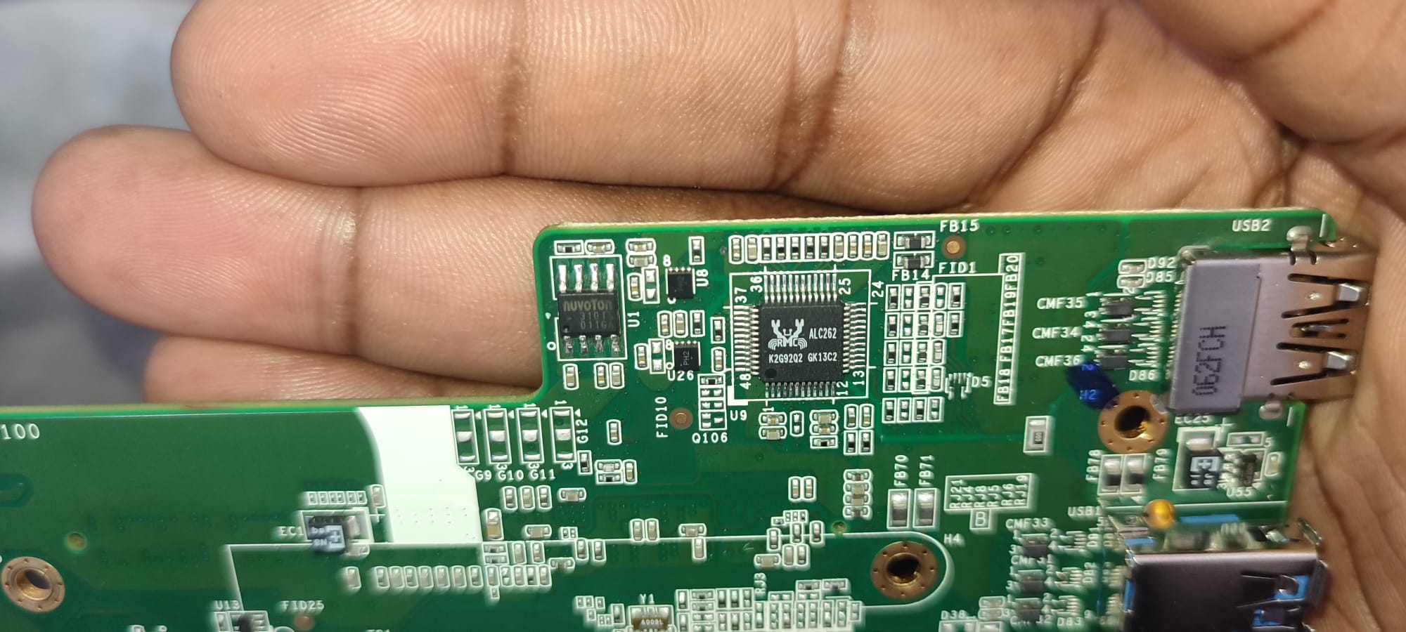

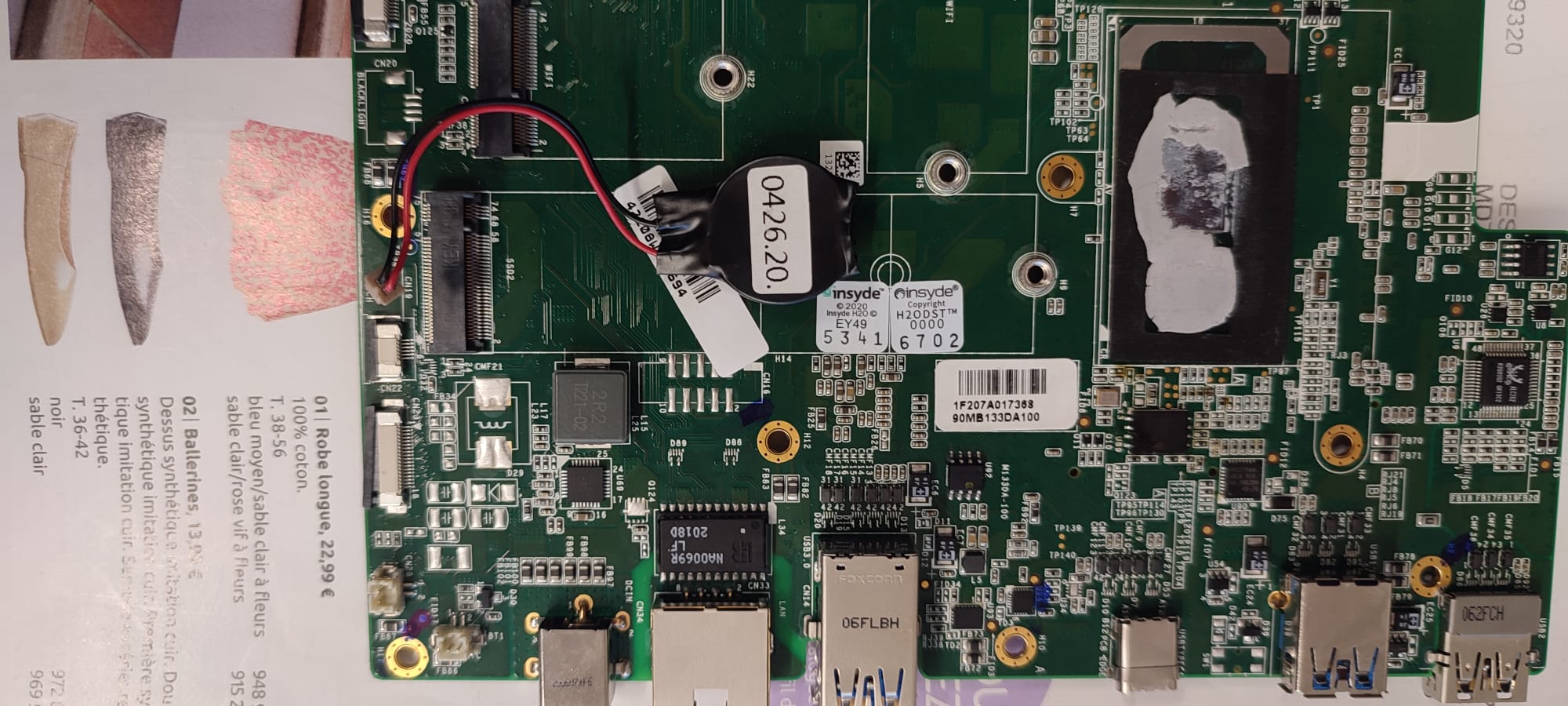

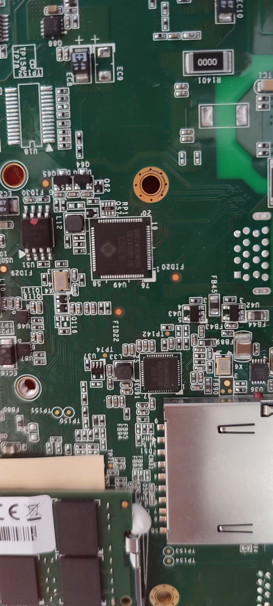

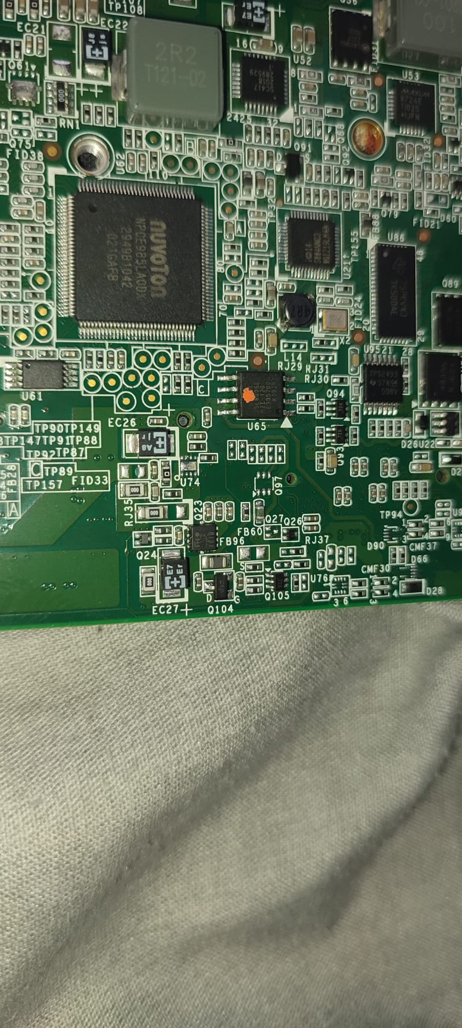

    Hi everybody,
    I looking for password of my tablet Mercedes Benz, because I can't install the update of the update.
    I have EC_133WK.bin and BIOS_M133KW_Corporate.bin files.
    I did update the bios via windows with the EC_133WK.bin file but still same, the password is there. (U92 GD 25Q20CT)
    I unsoldered the chip U89 (U89 WINBOND 25Q256JVEQ), erase and write file BIOS_M133KW_Corporate.bin with CH341A. But still same.
    I already dumped all chip around.
    There is a 25L8006E chip (U65 25L8006GE M2I-12G 5E395700) I have just dumped. Someone told me password should there.
    I let you pictures of my motherboard. And link to the files I got and dumped.
    is there a way to find password from these files (I guess into the 1 mb file)
    Thanking in advance.

          Re: Winmate M133WK - Xentry Diagnosis Pad 2 BIOS Locked
          @Bugeur
          I've spent quite some time checking your BIOS file, I have 2 passwords to try, please try each and provide feedback as to which of them worked (password found is case sensitive, but may not make a difference according to other findings):
          password1 = mMc3!AaW=s
          ( mike, MIKE, charlie, digit[3], ExclamationMark[!], ALFA, alfa, WHISKY, EqualSign[=], sierra)
          password2 = Mm3cA!Was=
          ( MIKE, mike, digit[3], charlie, ALFA, ExclamationMark[!], WHISKY, alfa, sierra, EqualSign[=] )

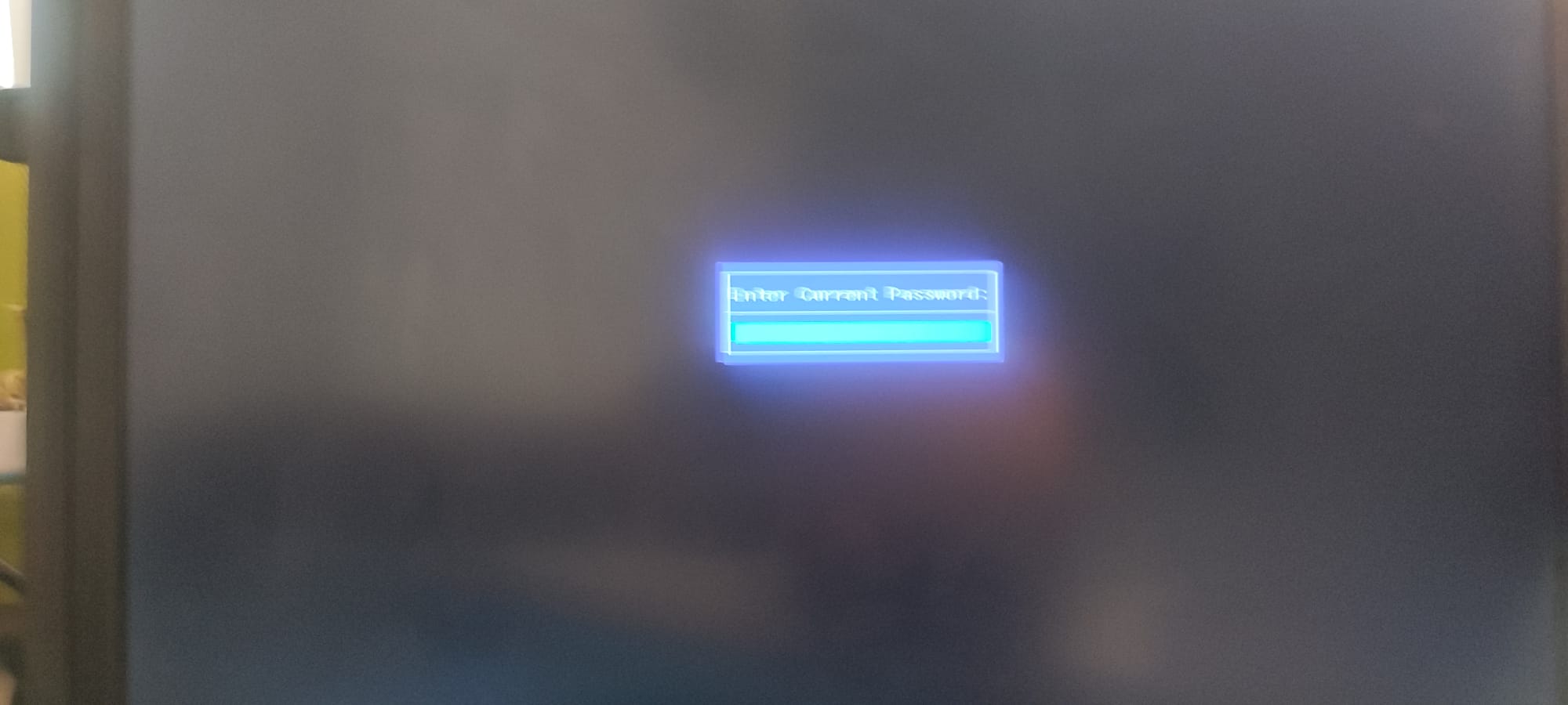

              thanks for the feedback. It took me quite some time as I did check all the other files and finally checked every variable/driver name/contents of the BIOS file. The password is hard-coded into one of the BIOS DXE drivers, that's why you cannot remove it. It's a tiny DXE driver with 1,662-byte size, one option is to delete this file and save the new BIOS, update chip and then check, but you may not be able to set a password at all, or the other option is to set your own password into this dxe driver file and update the BIOS file with changes.
              You are looking for this:
              UUID: 09802933-8BA2-4789-A744-3B3500576E49
              Would like to see a picture of the password prompt, as this driver is a little different from what I've seen, couldn't fine any reference to it from other parts of the code making the CALL.

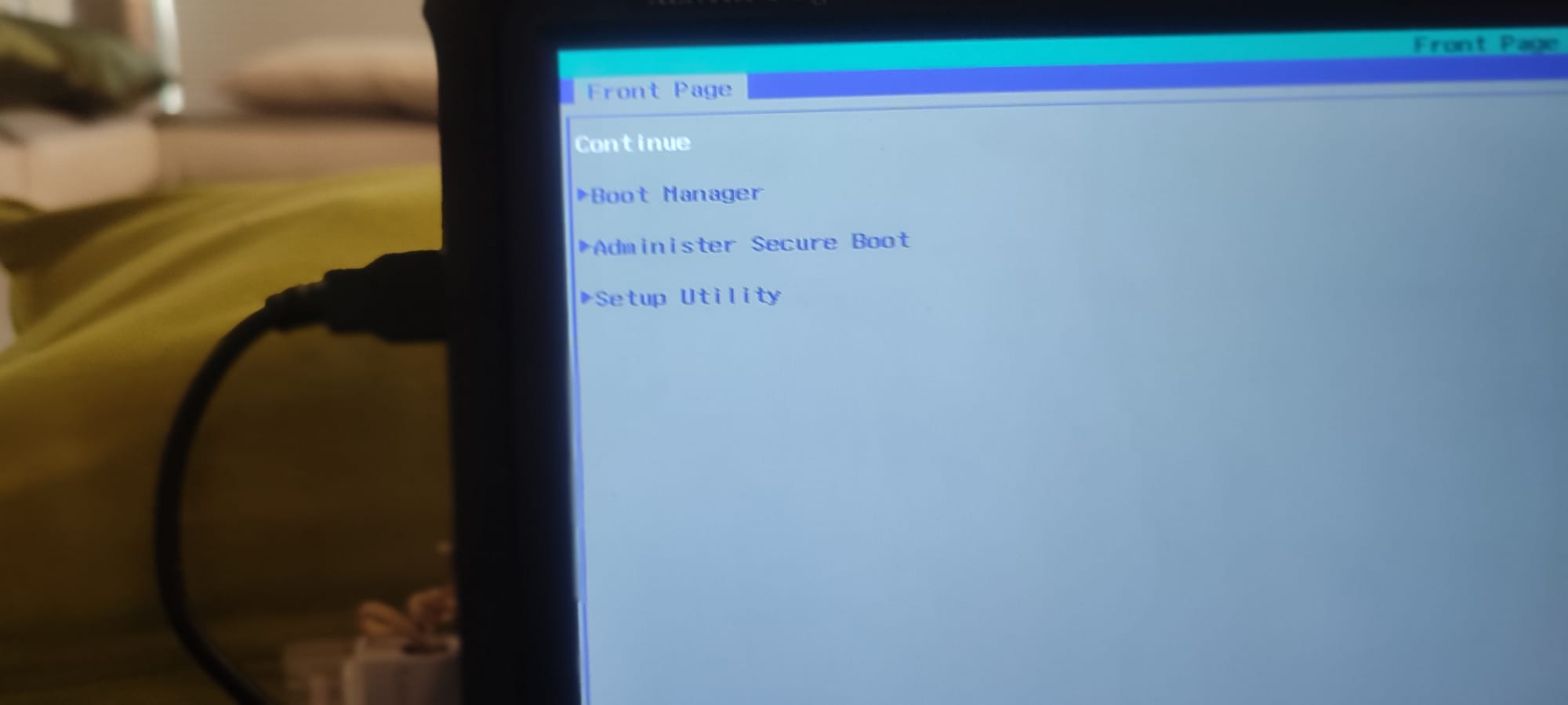

                Here is the password prompt on the picture.
                Whatever I did choose (except Continue) I got Password prompt.
                Where would I find information about :
                "Name: "DefaultPasswordDxe"
                UUID: 09802933-8BA2-4789-A744-3B3500576E49"
                From bios files ?
                Best regards
