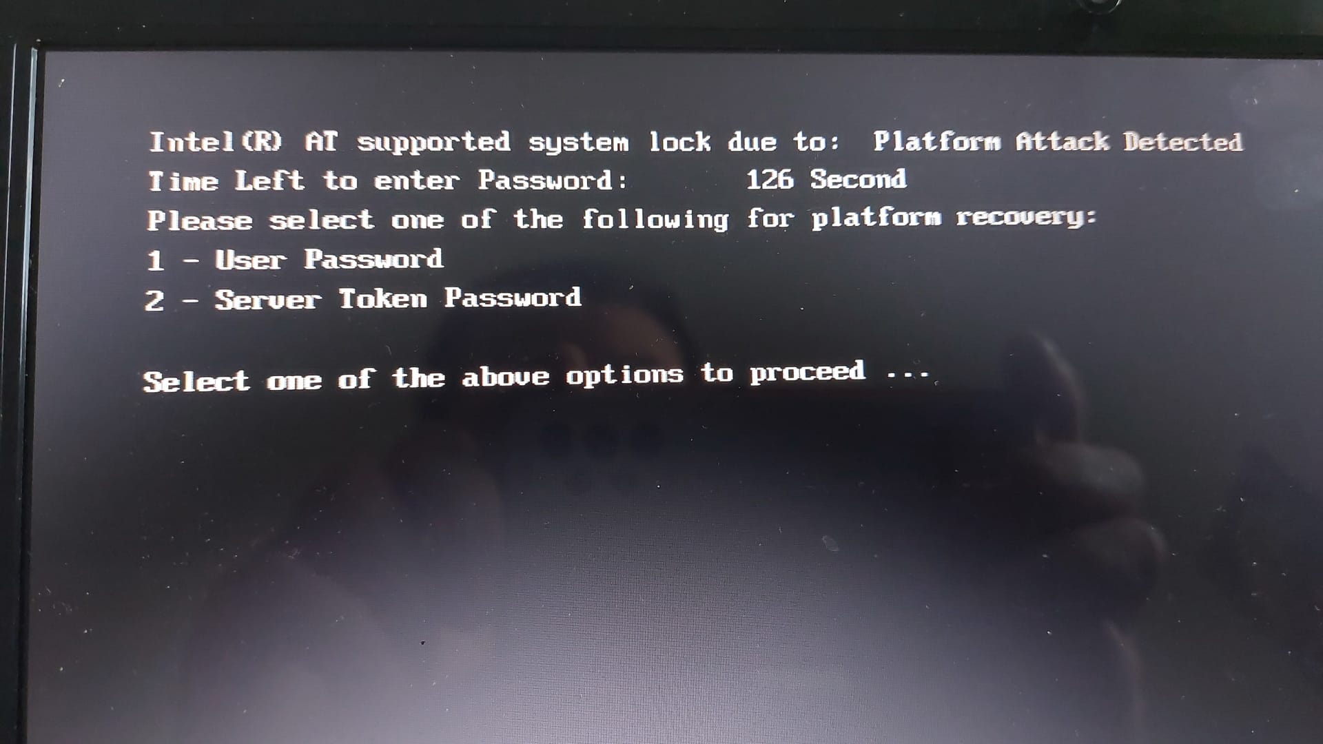

    Hello !!

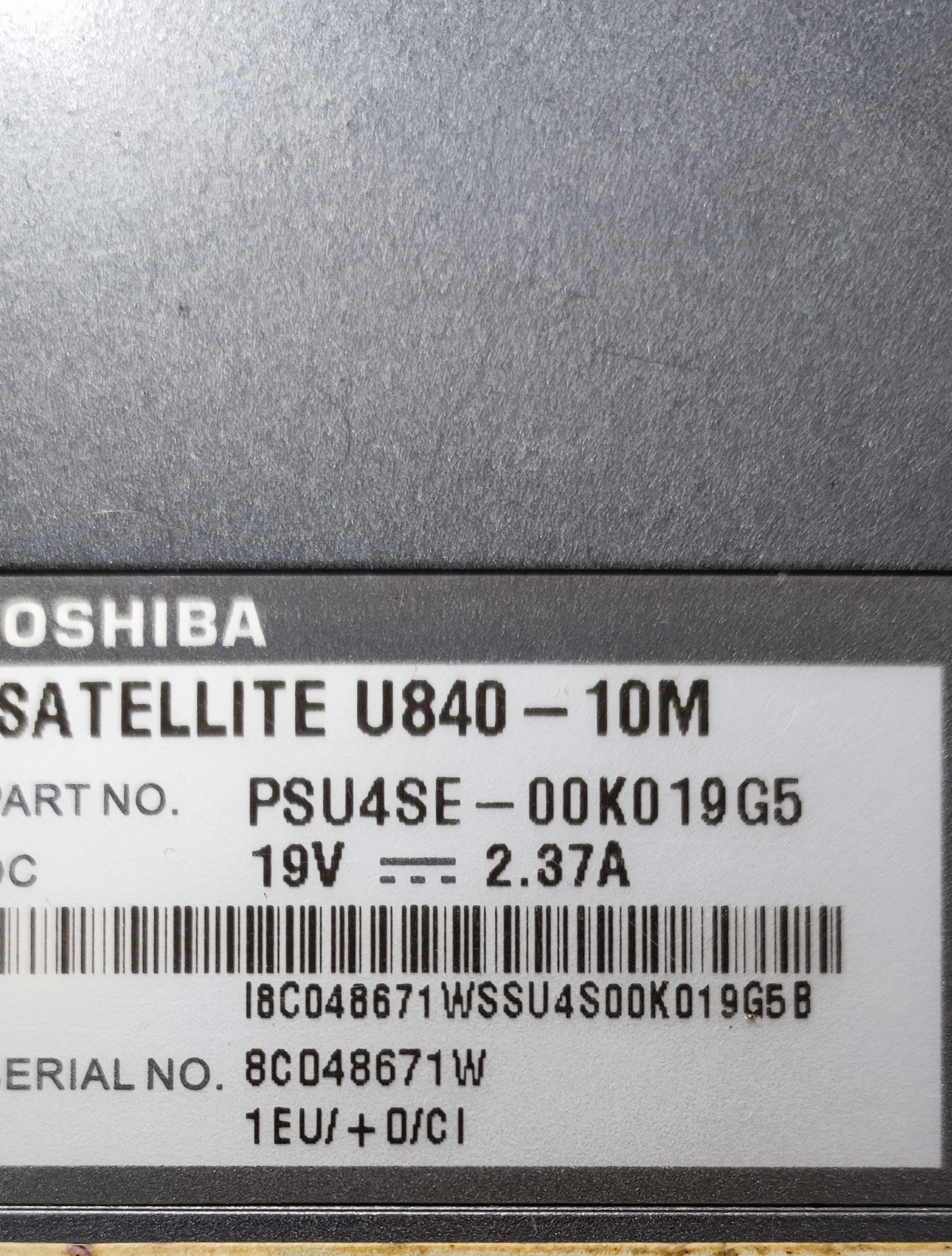

    I have a toshiba satellite u840-10m with the motherboard DA0BY2MB8D0 REV.D Model BY2, which after almost 1 year of being unused at startup, this error appears!!
    I can't enter the bios!! I tried to rewrite the bios but I can't find it for this motherboard model!!
    If someone can help me
    Thank you

    Upload your BIOS Backup here, write your Device Serial Number and someone will try to help you.

        This file is a Virgin BIOS from Toshiba with your DMI, I hope it fix your Problem.
          It works !!!!
          thank you very much for your help !!! I appreciate
