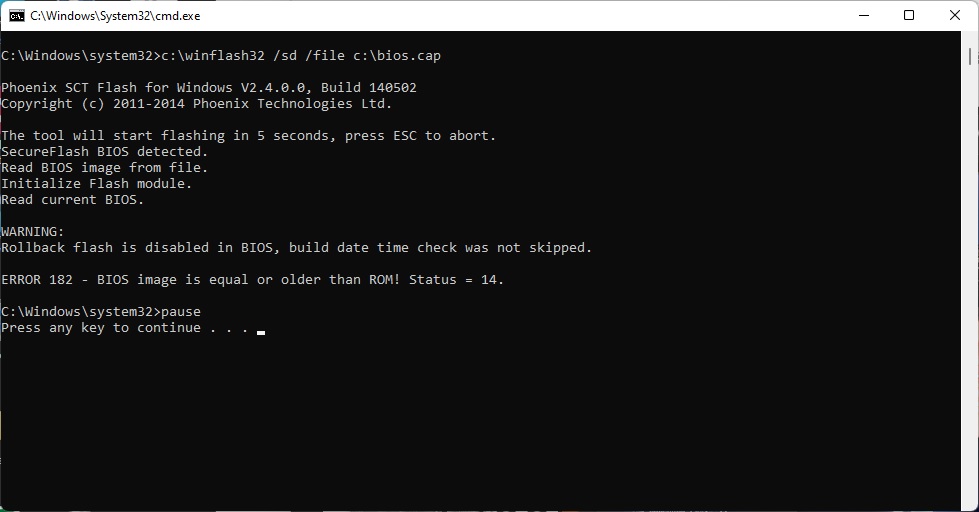

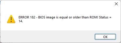

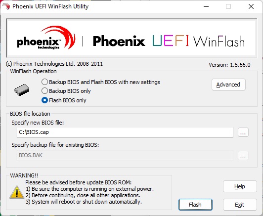

    I've been trying everything from every possible way to enter the bios, and it won't let me. So I reset the cmos battery, which didn't work.
    I tried SCT Winflash and winflash32.exe at the command prompt and i even went into Ubuntu 21.04 to try to do it but got too many errors, to no avail.
    I was wondering if someone here is genius enough to help me determine the filename needed for crisis usb bios recovery because everything i tried hasn't worked.

                        Re: How to fix not being able to enter the bios on Lenovo Ideapad 110-15ACL?
                        I used my sandisk cruzer glide 32gb and formatted fat32 and threw the BIOS.cap file on there and another of the same file named 1QCrisis.bin as I wasn't sure which file it was looking for as there is no documentation on the net of this specific laptop doing the BIOS RECOVERY.
                        Just throw the bios.cap on there and put it in the black usb 2.0 port, the usb flash drive. Turn off the laptop with it plugged in with a full battery and hold FN + R until it starts the recovery procedure. It fixed it for me.
