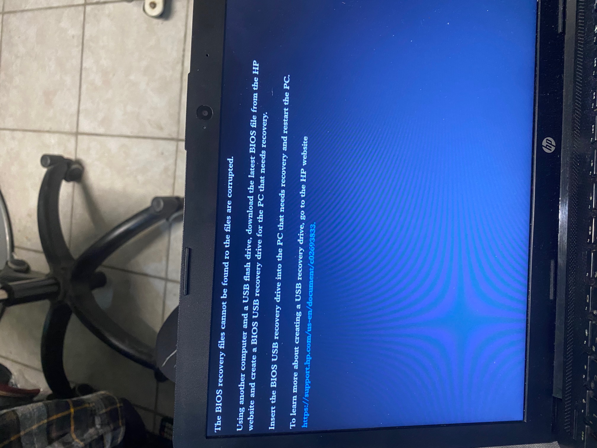

    Hello i need a bios dump for this model, sometimes screen goes on when power and say BIOS Corrupted.
    Laptop model : hp- 15-db1200ny

                • hackymc
                  • Feb 2017
                  • 33
                  • Romania
                  Re: hp- 15-db1200ny Bios Request
                  Thanks Hoaca, its turn, but same say its corupted, try from hp with bios recovery? or ? I attach photo, thanks in advance
                  • hoaca388
                    Badcaps
                    • Jan 2022
                    • 11508
                    • Viet Nam
                    Try replace with new SIP chip.
                    • hackymc
                      • Feb 2017
                      • 33
                      • Romania
                      I buy a new chip, and i flash the original ,and your dump, Laptop turn on, black screen, and caps lock led blinking. Any ideea?, with old chip, start but say bios is corrupted.
