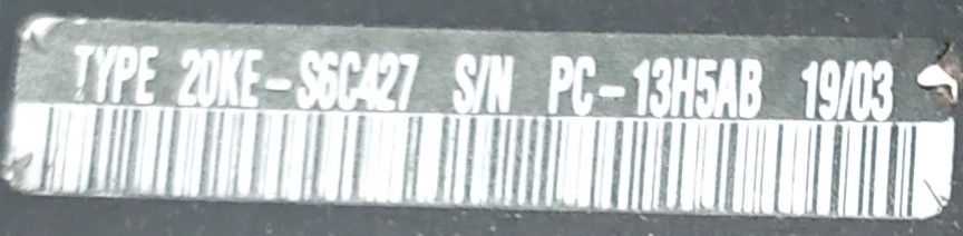

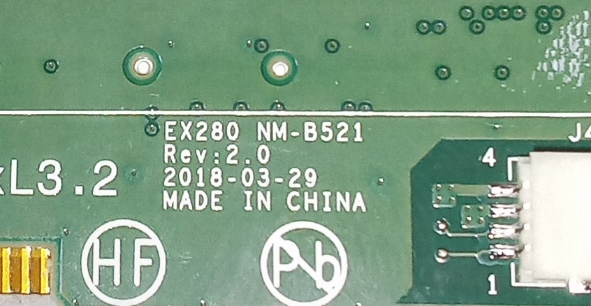

                    Can anyone please unlock this dump file. I have tried Lenovo Auto Patcher but it wont patch this file.
                    Make; Lenovo
                    Model: X280
                    S/NPF-0Y4SFE
                    Motherboard ID: EX280
