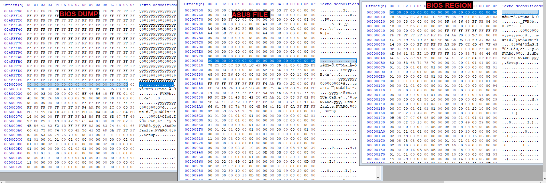

    hello; so, i have this asus fx506hm-az121, it's an i7-11800H with NVIDIA GeForce RTX 3060; so, this notebook received some liquid on him; all coil resistance looking good, all looking ok; i clean the oxides, and now, battery is charging, but when i press power button, led light up, and leds from keyboard light up but no screen.
    So, i think bios messed up; i try to download bios from asus site, but after delete those 2kb from beginning, bios image on start of the file they are very different; i think asus change the way bios appears/how they are build.
    So, any of you can make a Clean ME please? thank you very much.
    I attach windows and EZ flash utility downloaded from asus website.

    Greetings friend, the asus file is fine, you just made a mistake comparing the bios dump with the update file. You should compare it with the BIOS Region.
    I have attached the images for you to review.
    ME Cleared - NO DMI

      search for the word GPNV to find the DMI

        Thanks friend, I'll write it down in my notebook. As I see, the DMI would be from 5A0000 to 5AFFFF, although there is only information up to 5A28F0.
        Thanks for the knowledge.
        Dump attachment with DMI

            So, is not working, i think notebook has also another problem....but i cannot find anything wrong, and i spent i think around 2-3 hours on him...
            Saddly, customer was in a hurry, leaving Romania, so not much i can do anymore.
