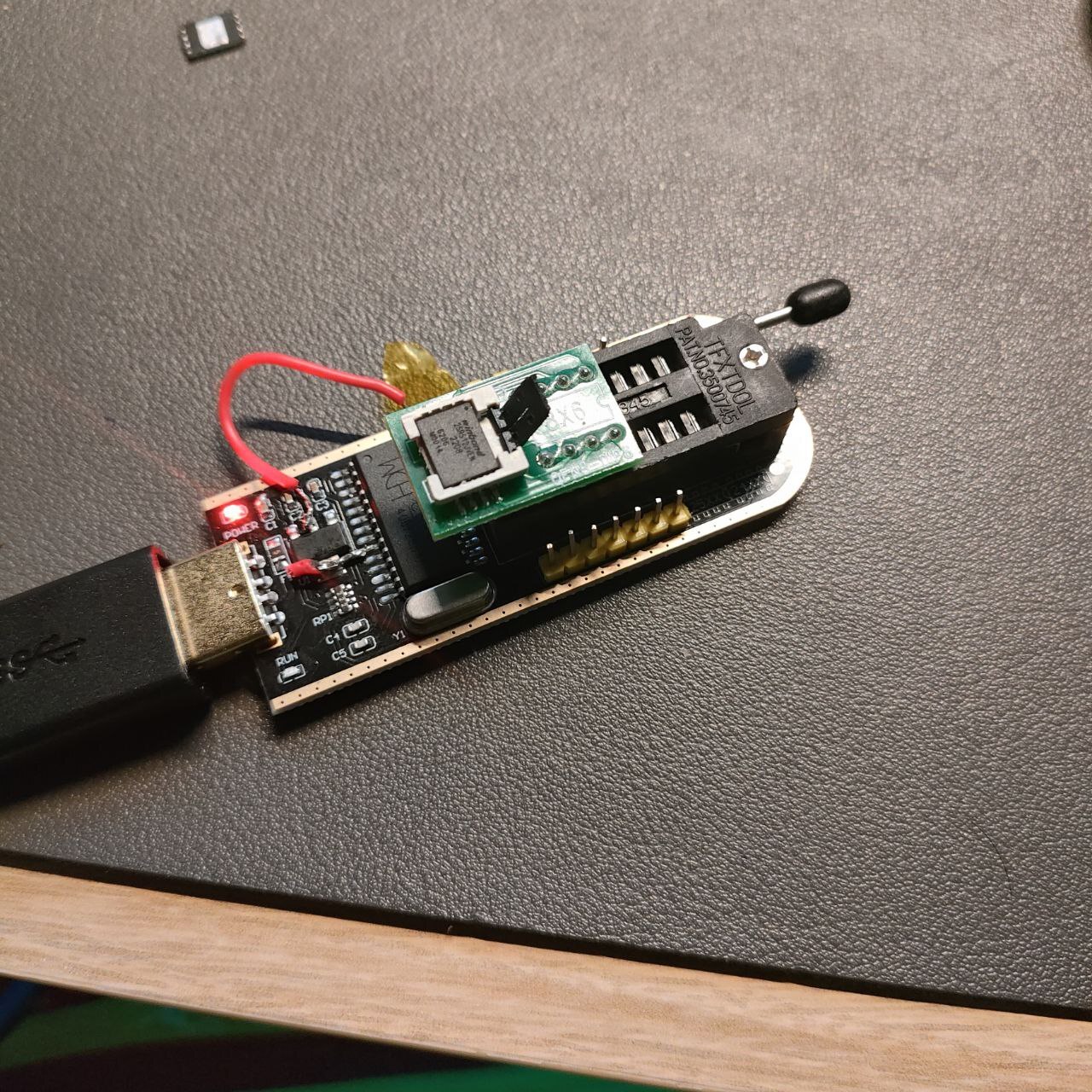

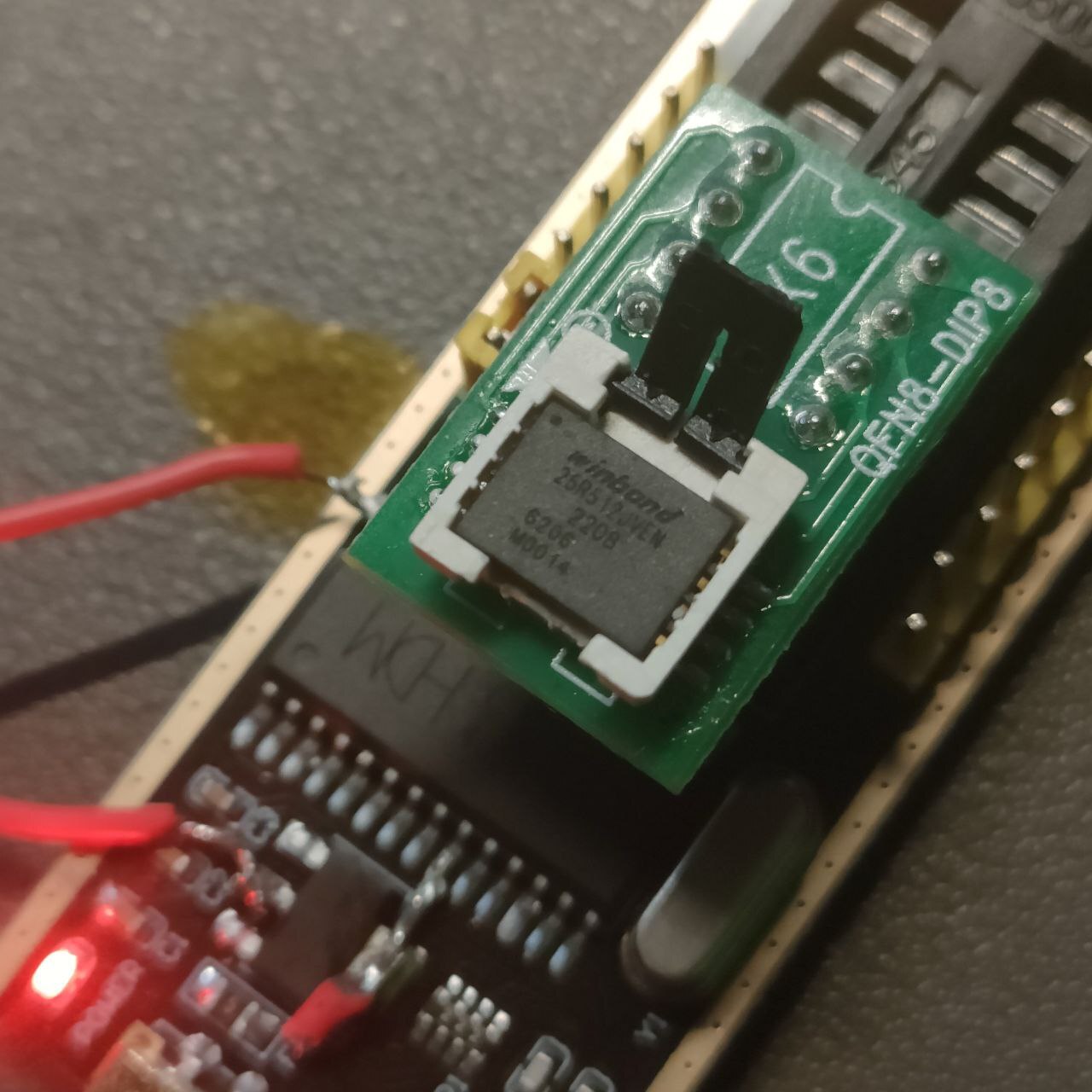

                HI friends,
                I really need help because I am a little bit desperate. I am trying to fix my son's computer because we cannot afford to buy another one.
                I have desoldered de Wson8 (25R512JVEN) Bios Chip, however I am not able to read it with CH314a programmer (Neoprogrammer, Ch31A program, AsProgrammer...)
                Also I have modified Ch314a programmer 3,3V but same result.
                I attach you some pictures, I don't really now If I am doing anything wrong.
                Please help

                      Thanks in advance.
                      you have three different files because you read them with errors..
                      The bios chip must be unsoldered from the board before writing or reading..
                      do not use the clip, you may have errors..if you do not have anything to unsolder it with,
                      solder wires between the programmer and the bios chip..
                      here is a video for example..https://www.youtube.com/watch?v=DWWi...nnel=ThisIsHow

                        this reads are with T48 programmer, Wson8 unsoldered and I have 3 different reads...
                        I have write all the bios here but no results look the video

                          The 3 files should be identical, otherwise you are doing something wrong.
                          What is the chip number? Need to see which adapter do you use with the Programmer?

                            25R512JVEN and I am using T48 programmer and Wson8X6 adapter. (Forget previous pictures of CH314a... in this thread).
                            I think i am doing well but unfortunatelly this chip is corrupted.
                            So I need a bios to write in a new chip
