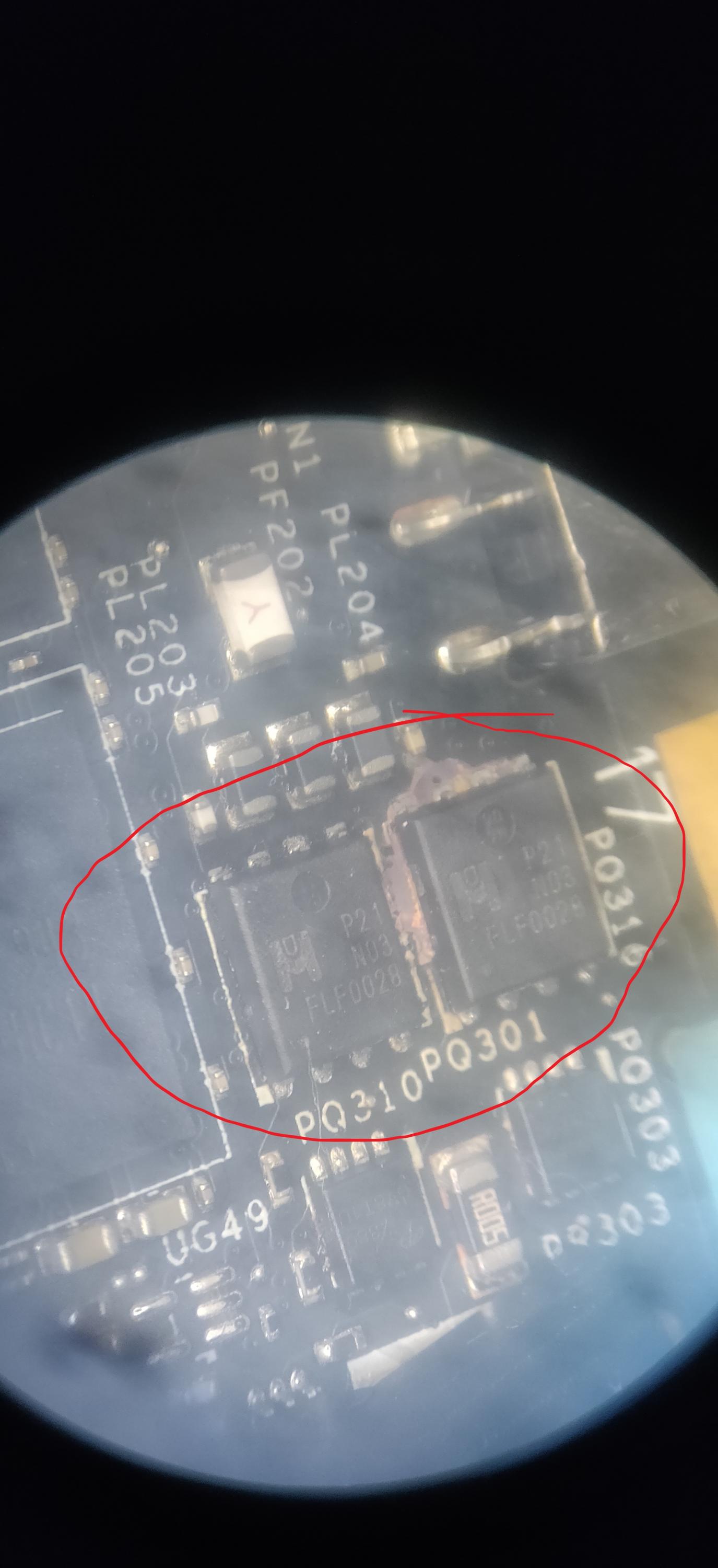

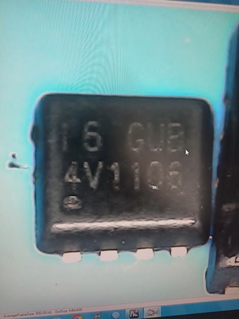

    Hello.
    Have this Lenovo legion Y740 that have burned main power delivery mosfets and i cannot identify this small mosfet.

    Re: Lenovo legion Y740 - need to identify mosfet
    Location code ?
      Originally posted by ktmmotocross
      Hello.
      Its made by NIKO-SEM or UNIKC Semi ,no idea yet what the part number is though
        https://www.badcaps.net/forum/showpo...65&postcount=4
        this is second mosfet. first is bigger NIKOS PK5N2EA, what mosfet can be paired with it?
          I don't know if this work with your board, but i have no problem using AON6414 for replacement PK5N2EA
          and your second mosfet is PE636BA, you can use A5 mosfet ( asus board ) or ao7410 for replacement, DWYOR.
            PK5N2EA is 50% stronger in continuous drain as AON6414 so no way for me and AO7410 cannot be even compared to PE636BA
            but thanks for identifying that second mosfet
              Hello! I have a similar issue on a Lenovo Legion Y740-15IRHg. Got 4 mosfets blown and I can't identify and find the values of the big ones from the picture. If anyone could help with that I would greatly appreciate.
                https://www.badcaps.net/forum/showthread.php?t=114173
                  Thanks for the quick reply! Not sure if I'm an idiot (probably am) but can't seem to find these mosfets in the PDF when I try to search for PQ301 or PQ316 marked on the board. I'm definitely not good at reading schematics.
