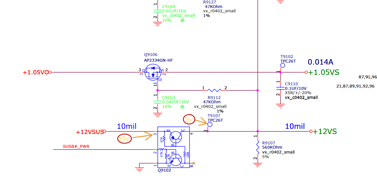

    TLDR:
    Are these voltage readings normal? What should I do next?
    Long story:
    I have an Asus FX505GT laptop that received a small amount of liquid.
    Since then, installing the Intel GPU drivers causes a black screen, then an infinite Windows loading until I uninstall the driver using safe mode.
    The laptop still works when using the default Microsoft display driver, but the video memory shows as unknown in hwinfo.
    Installing the GTX 1650 max-q drivers works, but there does not seem to be any acceleration.
    I don't see any physical signs of the liquid damage on the board, but I do know where it might have been. This is why I checked the voltage in that area.
    Thanks!
