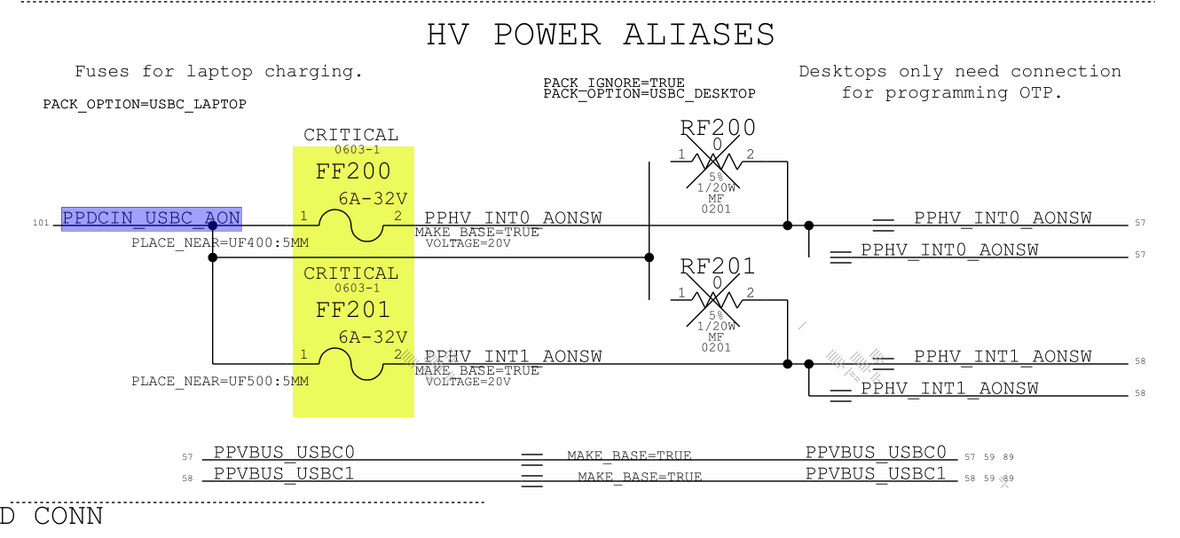

                          Re: Water damaged M1 MacBook Pro (820-02020)
                          The value is not exactly the same as in this table here:
                          https://openboarddata.org/?a=showboa...pple/820-02020
                          Perhaps of concern.
                          See attached. Check if the fuses are still working with a resistance check. If they are ok, remove each and check the diode mode reading again to see if it matches the above table of values.
                          Also, with no power -> meter in diode mode -> check the diode mode readings of each CCx line.
                          CC1 and CC2 pins on the Type C connectors are used for the single wire BMC power delivery communication with the external adapter. If the CCx pin is not functional - perhaps due to a transient surge which will then kill the TVS diode, then the default adapter voltage will of 5 volt will be static (not possible to reach 20v or any other value).
                          The CCx diode values can be compared against the above table of values.
                          From the above table:
                          USBC0_CC1 Default d 0.588
                          USBC0_CC2 Default d 0.569
                          USBC1_CC1 Default d 0.584
                          USBC1_CC2 Default d 0.584

                              The reading look very close to the reference document so they may be ok.
                              Suggest to remove the fuses and check if the 5 volt is then stable.
                              The video you posted does show some power cycling and the Type C meter may be missing it due to slower sampling rate.
                              You will have to check the 5 volt at the type C connector area once the fuses are removed.
                              If the 5 volt is stable, then solder back one of the fuses and check if the power cycling returns or not.

                                Removed both fuses and tested connector's 5V side and they were very nice smooth 5.1V on each one.
                                I've returned one of the fuses FF200 and tested on AON side and cycling is back..
                                What does that mean? Guess it means that the cycling is caused by the other side? What ever is after PPDCIN_USBC_AON, no?
                                • mon2
                                  • Dec 2019
                                  • 14664
                                  Each fuse is linked to a local CD3217 ACE controller.
                                  FF200 fuse is linked to UF400.
                                  FF201 fuse is linked to UF500.
                                  Remove FF200 fuse and solder in FF201 to activate the next ACE controller.
                                  Is the 5 volt stable or pulsing like before ?
                                  If stable with FF201 fuse, then it appears the CD3217 linked to the FF200 fuse is considered defective.
                                  Do you have a thermal camera? Perhaps the local CD3217 is heating up that is resulting in the power rail pulsing.

                                    FF200 fuse removed and I soldered FF201 on. I measured 5v and its pulsing.
                                    I have a thermal camera but sadly there isn't any heat or even amp consumption to generate heat whatsoever.
                                    Note: in the video I took it said somewhere like a 60 mAh was pulled apparently that was caused by the defective USB-C ammeter I took the video of. This does not harm the troubleshooting in any way or form because I used THIRD known-good ammeter.
