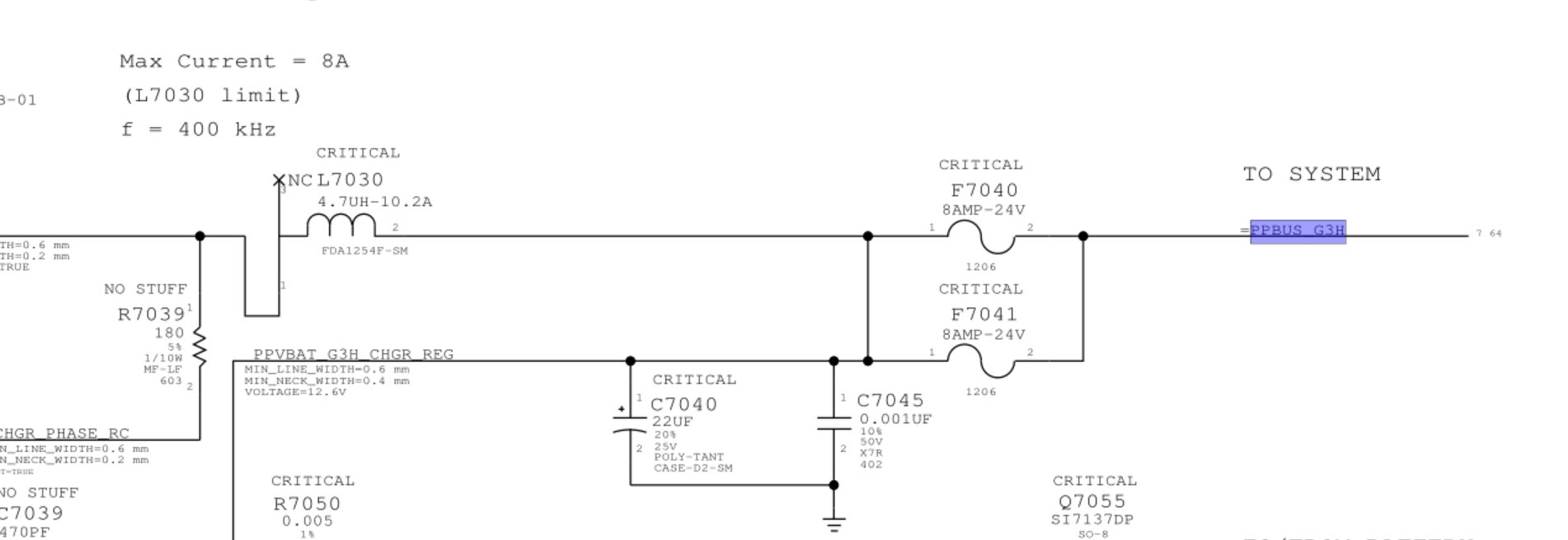

          Re: 820-3330-B suddenly doesn't power up
          The CPU may be defective but remove fuses @ F7040 & F7041. Do not lose them. Apply ample flux and remove with tweezers or slide over so they are no longer mating the PCB pads.
          Then power up again and check the voltage of PPBUS_G3H on both sides of the fuse pad @ F7040.
          Post each voltage measurement.
              So now with fuses removed this are the measurements:
              On pin 1 of both fuses (F7040 and F7041) I get 12.57V.
              On pin 2 it's 0.25V.
                PPBUS_G3H is now a good voltage but something on the consumer side is pulling down this power rail.
                It could be the CPU or a bad cap. Hope it is the cap.
                Remove all power.
                Meter in resistance mode -> check the resistance to ground of the side with the low voltage on the fuse pads.
                What is the resistance to ground of the consumer side ?
                Do you have an adjustable power supply ? That can dial up 0v8 for example?
                    Pin #1 is toward the ISL side which creates the PPBUS_G3H. That is, without the fuses in place, the regulator is working fine and doing its job.
                    Downstream is the other fuse pad = consumer side and is shorting with the ~22 ohms.
                    This resistance sounds like a bad capacitor (hence the name of this website).
                    Using an adjustable power supply @ 0v8 (you want to remain under 1 volt just in case that the CPU rail is mated with this rail). A higher voltage could damage the CPU if there is a leakage.
                    Once you have the power supply, dial it up to 0v8 (DO VERIFY IT WITH YOUR METER BEFORE USE!!) and apply the RED probe onto the fuse pad with the lower voltage = 'consumer side'.
                    Black wire to ground. NO POWER TO THE LOGIC BOARD.
                    This process will heat up the defective part with the low resistance. Hoping again that some capacitor on the board will crack / heat up and become visible. If the CPU heats up, then the CPU is toast but from this resistance value, do not believe it is the CPU.
                      As indicated in the "Begginer's guidelines: what not to do" section, DO NOT inject 19V. Check high-side MOSFETs for short, easiest way is to place one probe on the main power rail and the other probe on each large inductor of the board. If one is lower than 1 ohm, there's a possibility of high-side MOSFET short. If not, you can start injecting voltage *at 1V*, and double check none of the large BGA is warming up. If 1V is not enough, you can start increasing voltage, after making sure none of the large BGA is warming up again.
