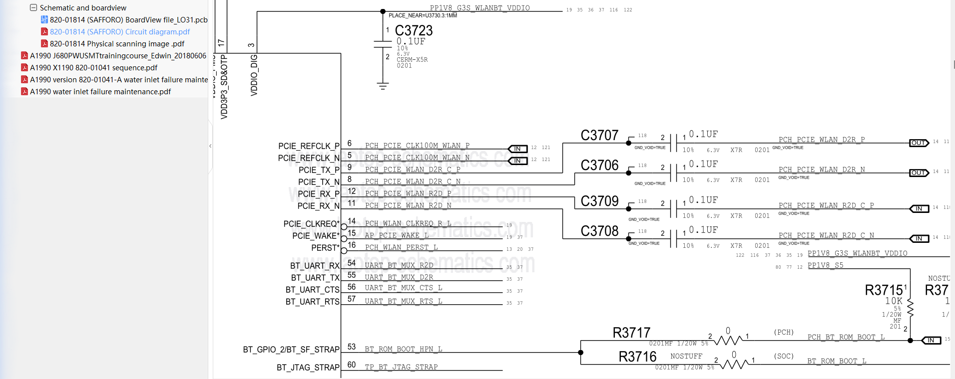

    a1990 820-01326 no wifi/bt
    hi guys! please help me! motherboard with shorted wifi, replaced from donor board + 2 eeprom...no luck...any idea?
    WLAN_PWR_EN
    PP3v3_g3s_wlan
    pp1v8_g3s_wlanbt_vdd
    all present

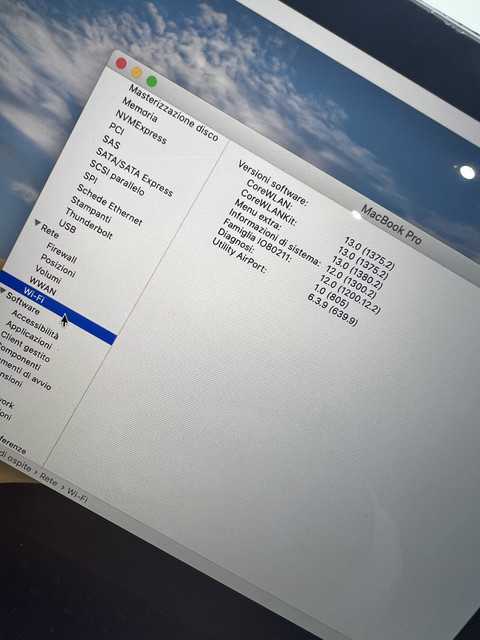

        Re: a1990 820-01326 no wifi/bt
        you are right: here it is!
        what do you mean with "wifi version?"

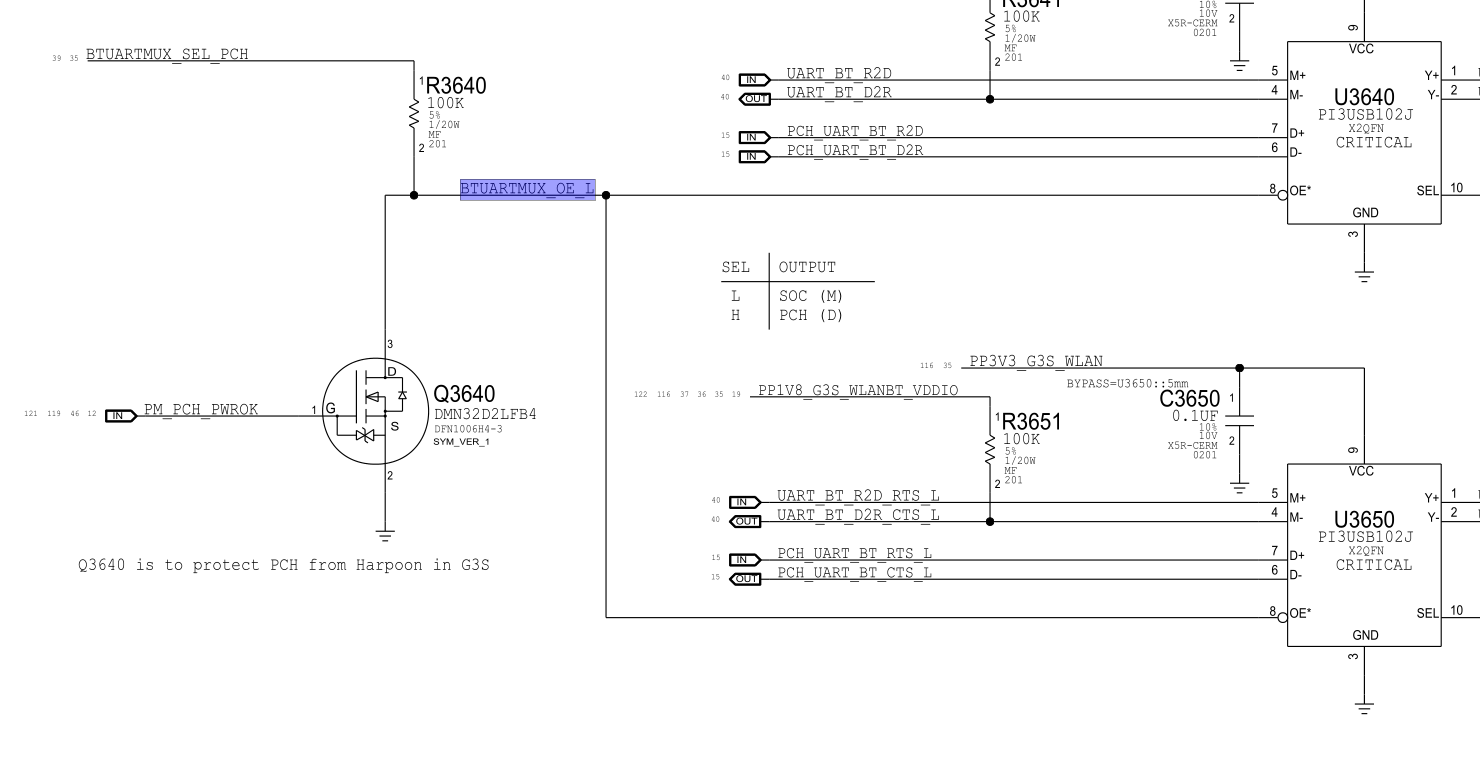

                  Personally do not have experience with this area but let us give it a stab.
                  The wifi / BT module will often be a stand alone unit that communicates with its master over UART or some similar interface (SPI / I2C / SMBUS). It appears this module uses UART mode with CMOS voltage levels (ie. NOT RS232).
                  In the schematic there are some multiplexers (MUX) devices shown @ U3640 and U3650. These devices must be enabled with the OE# signal. This is an active LOW signal.
                  If the pin #8 of each mux is LOW (0 volts), only then will the signals pass through the WIFI / BT module to the PCH (master).
                  Can you confirm the voltage to ground of the BTUARTMUX_OE_L signal ?
                  The MUXs have to enable so that the module can be configured & data can flow to / from the WIFI module to the host.

                    WiFi goes through PCIe, other busses are way too slow.

                      Confirm that each of the PCIe series caps are present onboard and that they are not defective. A defective / missing cap can halt the enumeration of the PCIe WIFI / BT module.
