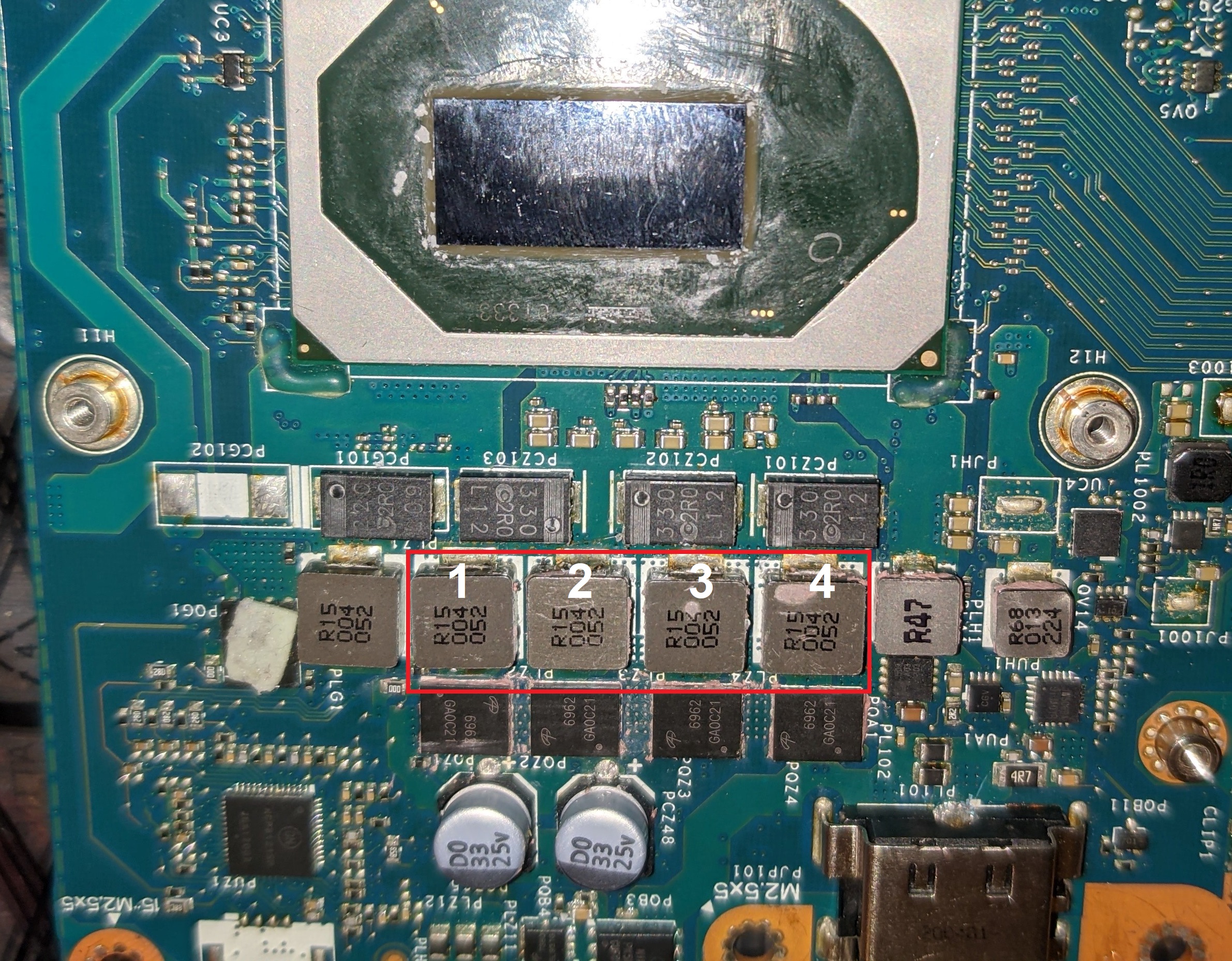

    Just an update and hopefully, one of the experts here can confirm my conclusion or point me in the right direction.
    I read through lots of threads on this forum regarding the diagnosis of bad/shot CPU and some of the common questions are in relation to the inductor resistance reading after lifting one side off the board.
    Unfortunately, in the threads I read, the numbers were not posted.
    I followed those instructions and lifted one side of the CPU inductors. I have shown the ones I lifted in the red rectangle numbered 1-4 in the attached picture.
    Below are the resistance reading the "front" refers to the side further away from the CPU as in the picture and the "back" refers the closer to the CPU as in the attached picture:
    1. Front = 0.836k Ohms and back = 1.3 Ohms
    2. Front = 0.836k Ohms and back = 1.1 Ohms
    3. Front = 0.843k Ohms and back = 1.1 Ohms
    4. Front = 0.822k Ohms and back = 1.2 Ohms
    Based on these measurements, I am concluding that the CPU is shot/bad.
    Is this an accurate conclusion?
    Thanks in advance.

      Seems like a gaming board with "H" Cpu. So resistance close to 1 ohms should be fine.

        in my opinion it's a little low... should be around 3-6 ohms in most cases for an intel cpu. but i could be wrong though

              After deciding it was a shorted CPU based on the YouTube video I liked earlier, I watched another YouTube video from another popular repair shop on YouTube (I will leave unnamed as some people will cringe ). The issue he was addressing was very similar to what I was seeing. However, his was on the GPU side.
              He seemed certain the shot wasn't the GPU, even when during voltage injection the GPU was getting hot. He said it was likely the power MOSFET was the shorted part and also said some MOSFETs are good at dissipating their heat so hard to tell with just voltage injection when they are shorted.
              With that I decided to test my board again and removed PLZ1 to PLZ4 inductors and retested. It pointed to a shorted MOSFET (PQZ1). I desoldered that MOSFET and there wasn't a short anymore. Bench tested the MOSFET and it was indeed shorted.
              I replaced the inductors and the MOSFET with new ones and tested for shot to ground and there was no short.

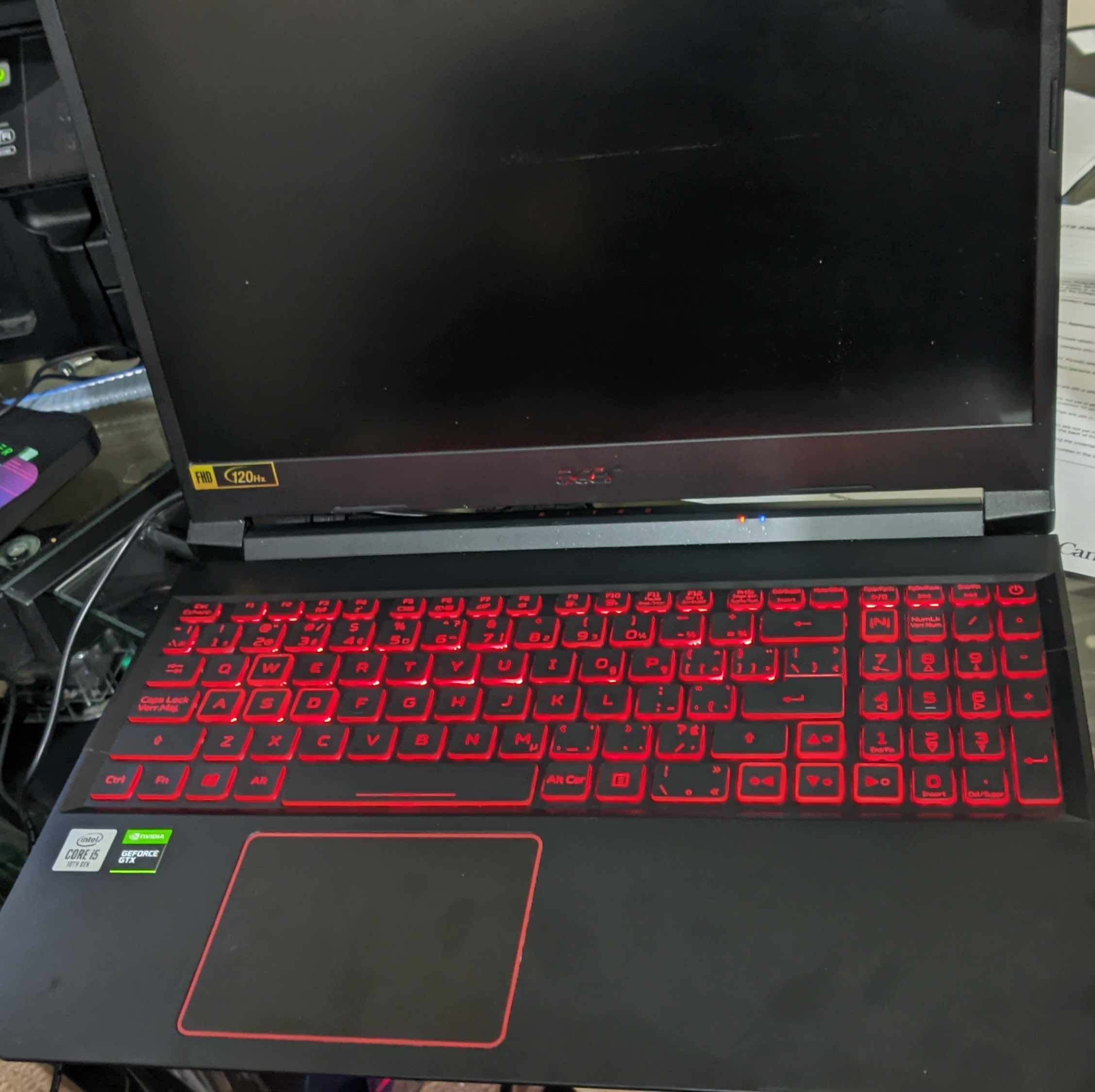

              I plugged in the charger and charging light came on. I turned on the laptop and the power indicator as well as the keyboard lights also came on.
              However, the display isn't working.
              Here are some things I have tried so far:
              1. Connected an external monitor/display and still no display
              2. I tried resetting BIOS (power off, disconnected main and BIOS batteries and hold power button for at least one minute) did not help either.
              3. Tried plugging in external USB keyboard and the number light doesn't come on when plugged into all three USB ports.
              4. Checked the display connector and plug for possible damaged and couldn't find any.
              5. Tried multiple working RAM sticks and same result.
              Additional notes is that the CPU and GPU fans spins for a few seconds when powered on then stops but after leaving it on for a few minutes, both fans kick on again.
              The battery charges fine (fully charged battery for testing and all was good) and laptop powers on with power adapter as well as battery with the same behaviour. When powered on with power adapter and then the power adapter is removed, it makes the notification sounds for when power plug is removed.
              Any help on what could be wrong or what next steps to take?
              Happy to take any measurements that may help diagnose the issue.

                It's a classical case of a so called "high-side short". In your case the main power rail was shorted with The VCC_CORE supply.
                The most bad news here that almost no CPU survives this kind of failure. For this reason you still can't get it back working even after replacing the shorted Dual-Mosfet. And probably still the same when you replace the whole buck converter (Controller, all driver, all Mosfets) as it is strongly suggested in such cases.
