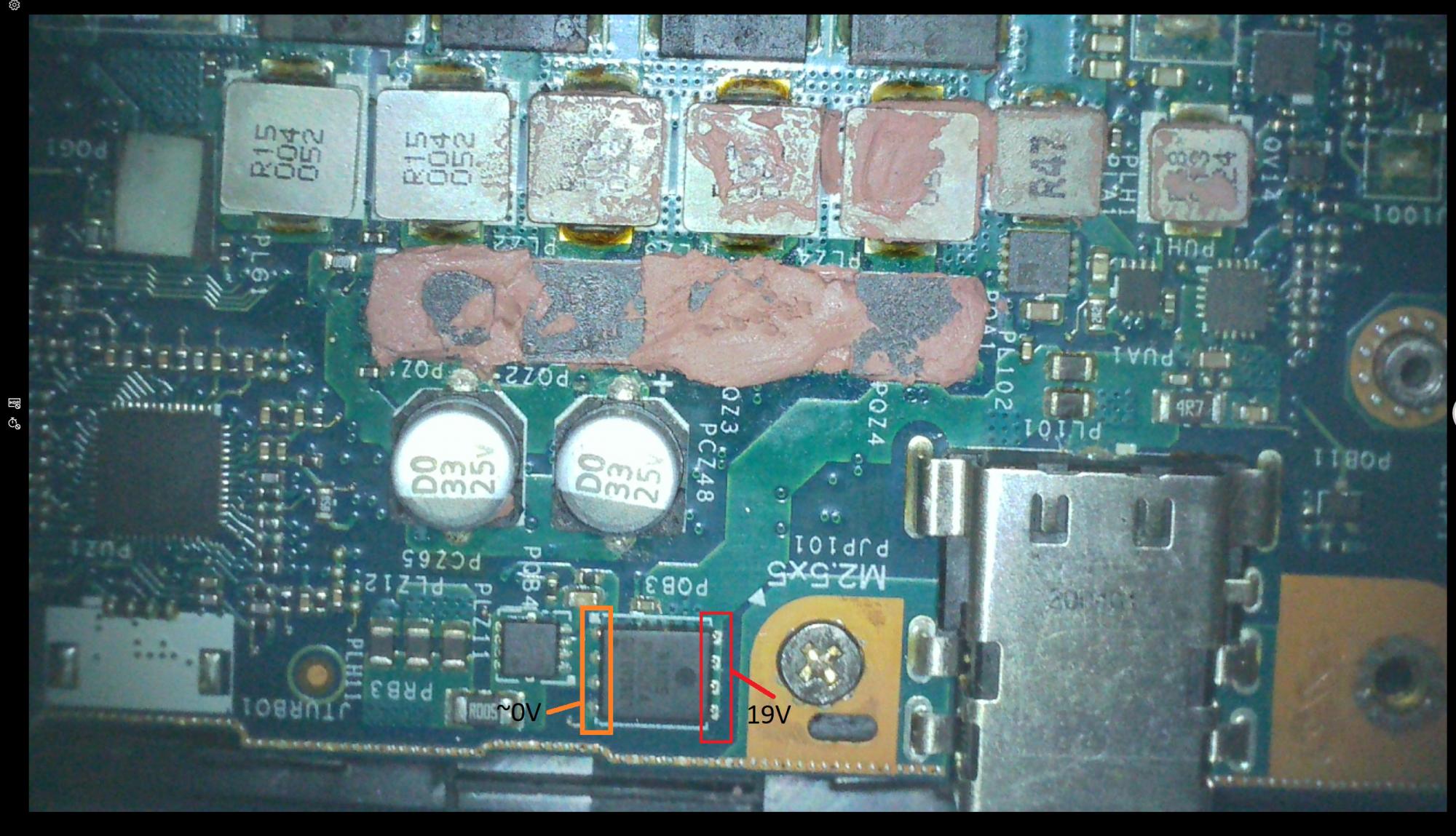

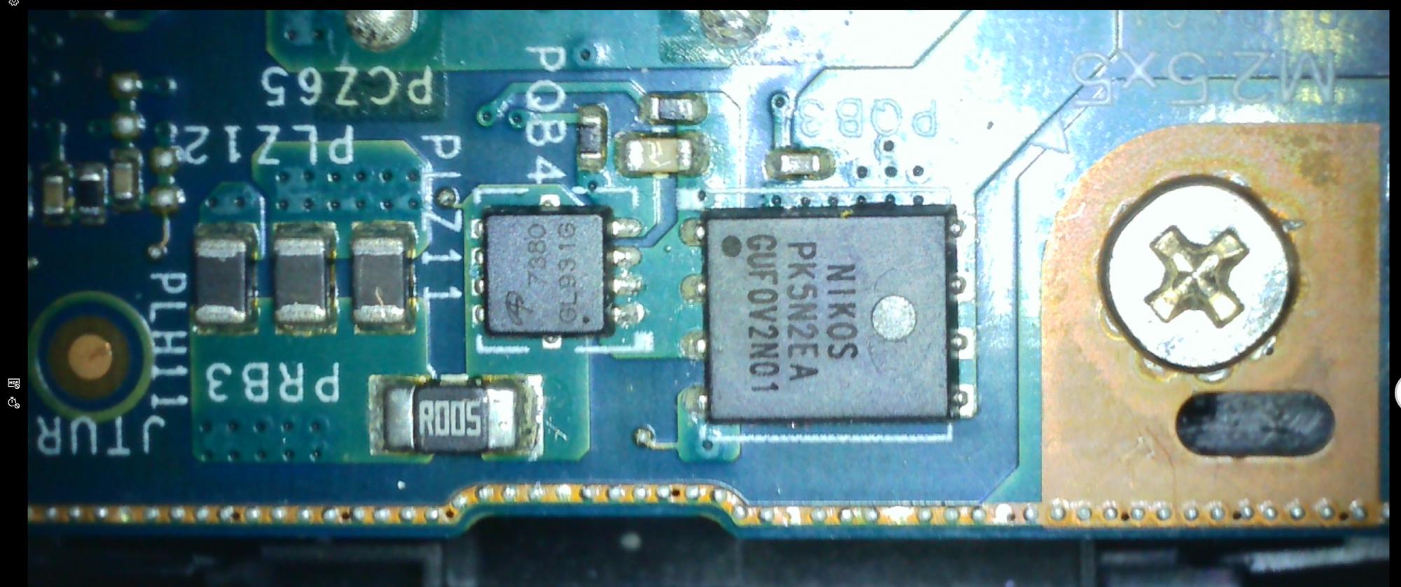

    Laptop is not charging and not powering on.
    Model details is AN515-55-517T
    Board is FH51M LA-J871P
    The circuit diagram and the boardview were generously posted by satishkumar.
    I have tried following the Beginner's guide to laptop troubleshooting and started by taking measurements on the charging system.
    I get 19V on the PQB3 MOSFET input and nothing on the output (pardon my ignorance of the proper terminologies)
    Does this point to a bad MOSFET or could it be another component?

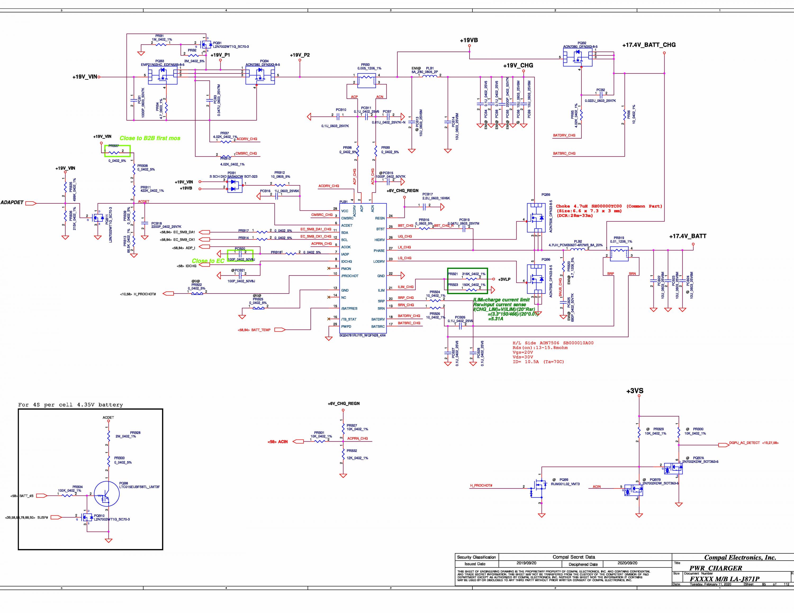

    I have attached the charging diagram and some pictures of the board.
    Happy to answer any question and take additional measurements as required.
    Hopefully, the experts here can help point me in the right direction.
    Thanks in advance.

    Re: Acer Nitro 5 N20C1 no power no charging
    Very good summary and quality pics.
    Yes, the dcin mosfets are the usual suspects. The charger IC is the BQ style which drives the N-channel mosfets.
    Being N-channel, the gate pin #4 of the DCin mosfets has to be higher than the voltage they are passing between the source / drain pins. For this logic board, the gate pin should be ~25volts to enable the mosfet.
    If you have 0 volts on the gate pin, the mosfet will be off.
    Measure the voltage of REGN pin of the charger IC.
    Also, ACDRV of the charger IC. You can measure before PRB7 resistor. If still 0 volts, power down, carefully flux and remove PRB7. Do not lose this part.
    Power up and measure the ACDRV pin again. Is it now ~25v ?
    The above sticky from @Piernov is a must read on the charger circuits and their operation. From his experience, often, the 2nd DCin mosfet gets damaged and needs to be replaced. After a few tests, we will know what is the fault of your logic board. If you have a spare or donor, replace the 2nd mosfet as a quick test. Best to debug in order and do post your measurements.

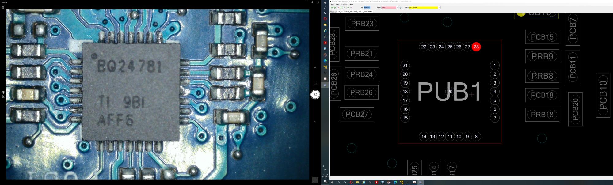

      Thanks, mon2 for the reply. Here are the measurements I took of the charger IC.
      REGN = 0.133V
      ACDRV = jumping between 0.035 and 0.058V
      I read through @Piernov's excellent write up on troubleshooting but I must say I am a complete noob and sometimes I get lost following.
      I haven't been able to take off PRB7 yet since I need some practice given the location. A hot air solder might blow out the nearby components.
      While I practice to try and take out PRB7, are there anything else I could try or that is the next logical step before anything else?
      Unfortunately I do not have a spare board.
          REGN is not correct and should be ~6 volts.
          Confirm the voltage to the charger IC at pin #28 (VCC).
          What is the voltage to ground on this pin?
          If you do not see about 19 volts here, the chip is not being powered through the dual diode. The dual diode accepts voltage from the external power adapter and the battery. The higher voltage between the two power sources is selected by the dual diode without contention to power this charger IC.
            My apologies mon2 for posting wrong data in my previous post.
            I measured the wrong pins as I was looking at the boardview on a single monitor and switching between that and the camera. I did not realize the image in the boardview was "vertically flipped". Only realized after moving to a dual monitor and having the boardview and camera side by side. I have attached a picture to show. I feel like a moron right now .
            The readings are as follows:
            Input Voltage = 19.3V (thought to include in case it is of any value)
            REGN = 6.04V
            ACDRV = 5.7V
            Pin 28 = 18.89V
            @Sephir0th, I will try and read through @Piernov's guide again to see how I can determine that.

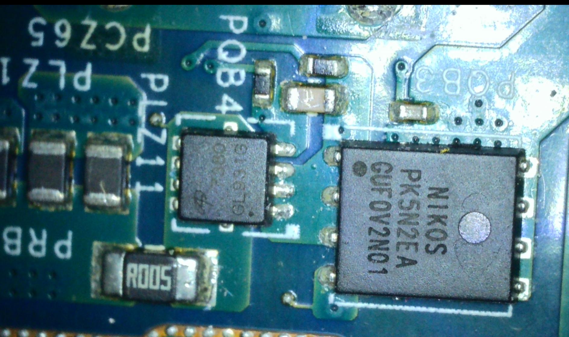

                Thanks again mon2 for your patience and detailed directions.
                I located PRB7 and the resistance is 4.02k ohms.
                I predictably used to alternative method since it did not involve desoldering
                Below are the numbers:
                PQB3
                source (1-2-3) & drain (5-6-7-8) = 4.1 3M ohms
                source (1-2-3) & gate (4) = 10.86 M ohms
                gate (4) & drain (5-6-7-8) 15.8 M ohms
                PQB4
                source (1-2-3) & drain (5-6-7-8) = 3.7 M ohms
                source (1-2-3) & gate (4) = OL
                gate (4) & drain (5-6-7-8) = OL
                I can also confirm there is a short to ground following the procedure you outlined.
                Not sure if this is the correct way of testing but I measured the resistance across PCB3 since it was the only cap in the vicinity and on the same line as PRB7 and ACDRV and it was OL .
                Does that indicate the cap is bad is something else is the culprit.

                  These are all good resistance readings. OL means 'over limit' on your meter. That is, the meter is stating the selected meter scale is too low for the resistance reading. Respectively, select the next higher scale and try again till you have a valid resistance reading. If you are on the highest scale, no fault here on the mosfets.
                  With your meter on resistance mode -> place one probe on PQB4, pin 5-6-7-8 (any of these) & other probe to ground.
                  You are checking to see if there is a shorted component on the output side of the mosfet @ PQB4. This is the side that powers the logic board.
                  Consider to think of these 2 mosfets like solid state switches (SPST) or relays. Only if they BOTH turn ON with the proper ACDRV voltage to the GATE pins, only then these mosfets pass the voltage to the logic board.
                  While doing resistance checks, what is the resistance of ACDRV to ground?
                  Never have power to the board when performing DIODE or RESISTANCE checks.
                  Still need to determine why ACDRV is not ~25 volts which is required to enable these 2 x DCin mosfets...

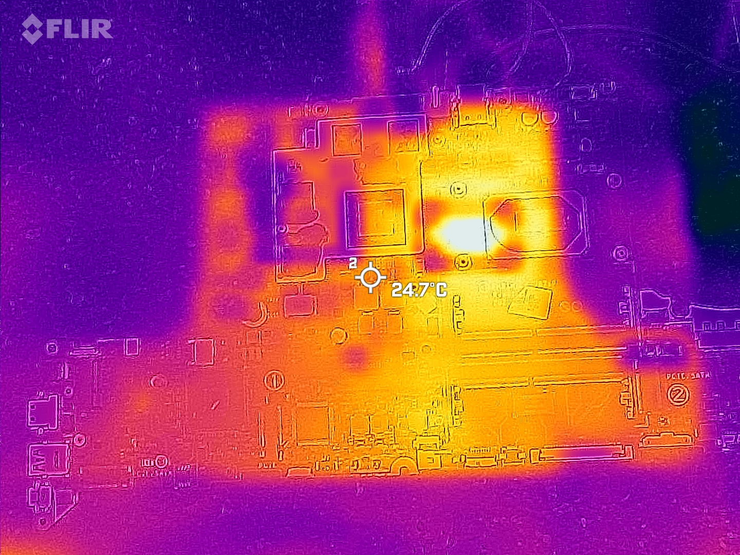

                              I tried feeling around the board with my fingers, but nothing stood out as being hot, both on the front of the board and back.
                              The CPU was the only part that felt slightly warm to me.
                              I plan on buying a thermal imaging camera on my way from work today to confirm.
                              My question is could the CPU feeling warm point to a bad CPU and so I shouldn't bother spending the money on the thermal imaging camera or that is normal under the circumstances?

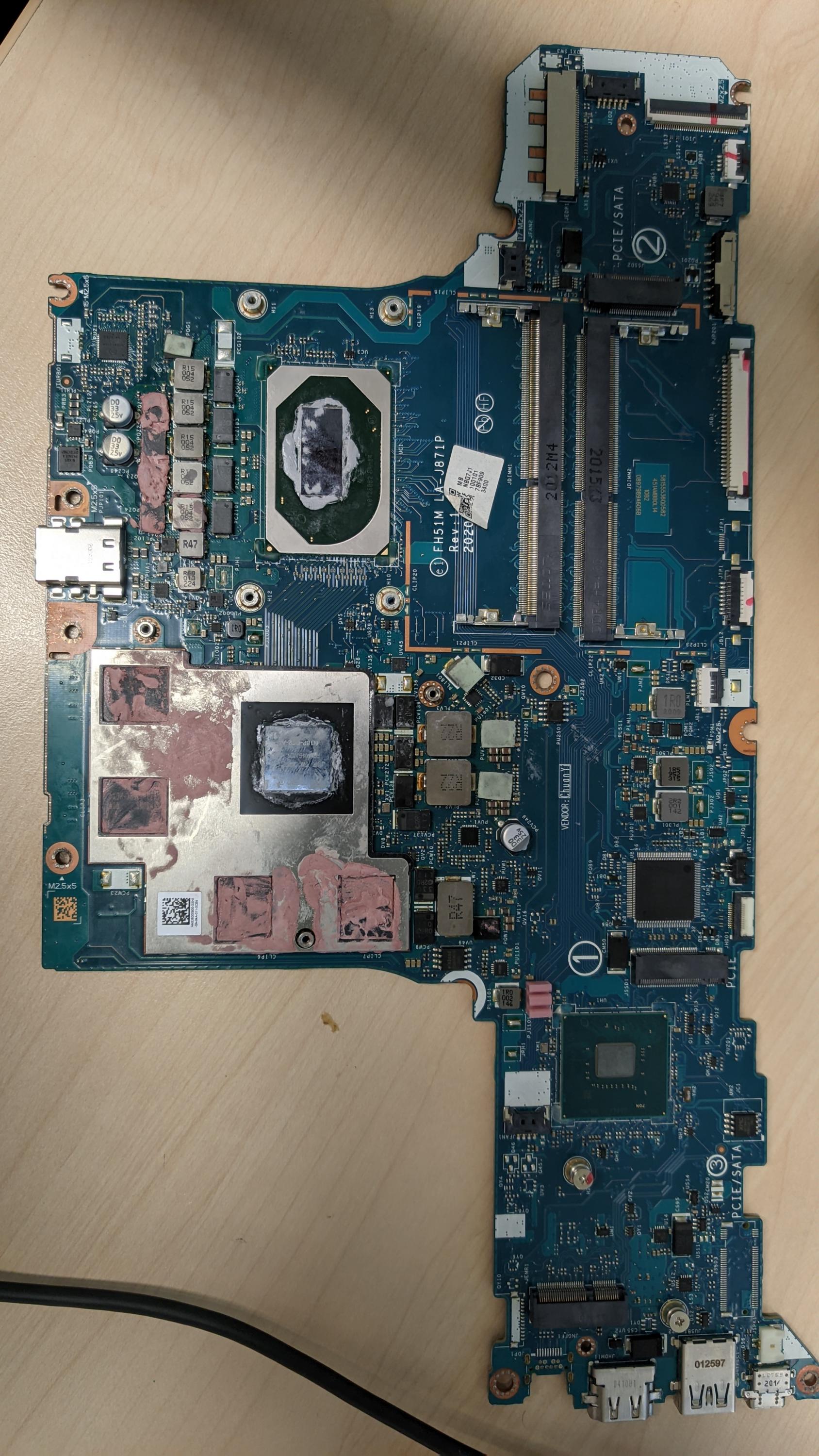

                                  The board I have doesn't seem to have the CPU and PCH on the same die (not sure if I am using the right terms here). I am attaching a picture of the entire board for reference.
                                  While I wait to get the new power supply, is there a way of ruling out the CPU as the shorted part?
                                  If it is a dead end due to a shorted CPU, I might as well throw in the towel now.
                                      Yours is a gaming mb and has separate PCH and CPU along with dedicated graphics chip.

                                        @sephir0th, I tried shorting the leads, but I couldn't trust the readings on the power supply. When the dial is turned all the way to max, it was showing around 4.7A when leads are shotted although the unit is rated 10A.

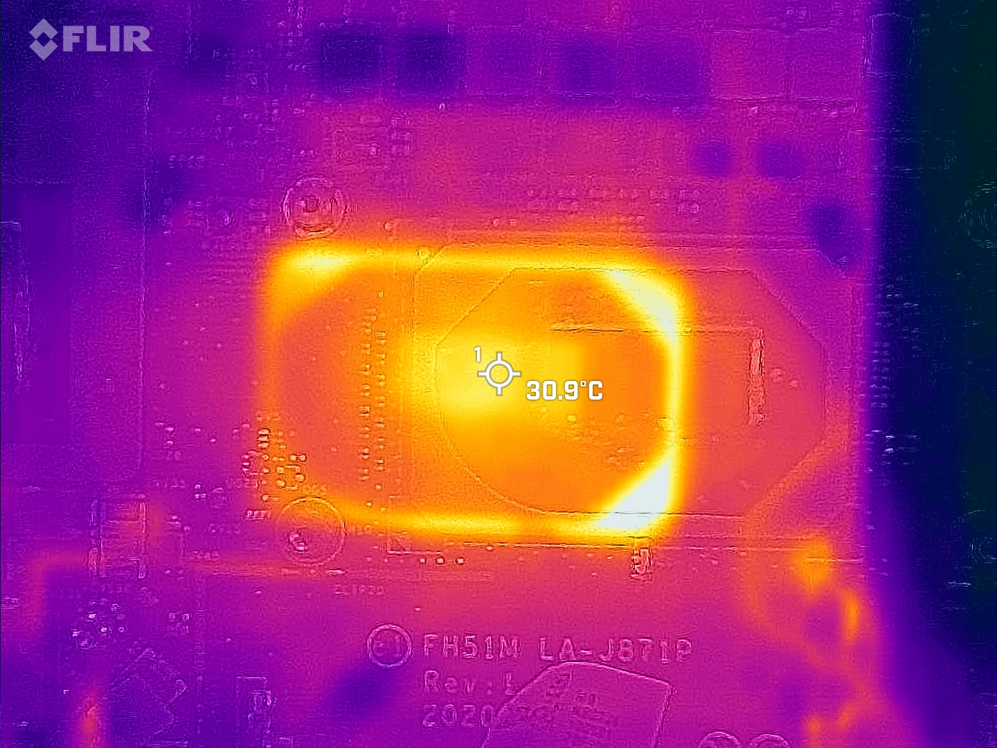

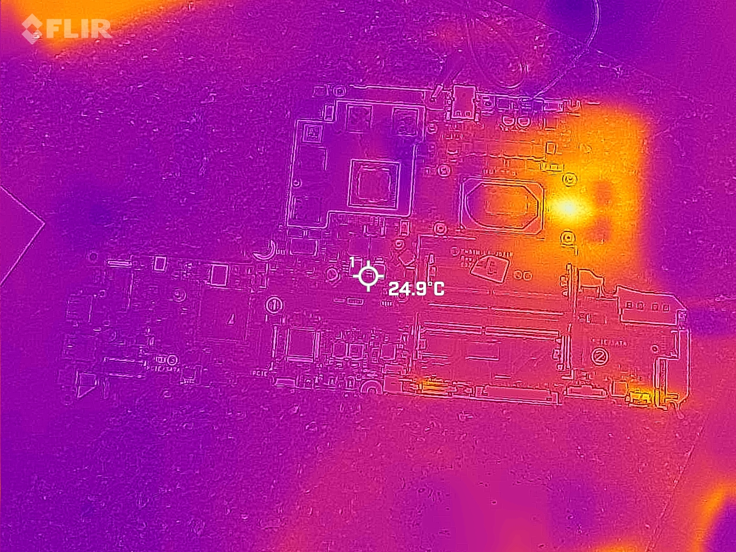

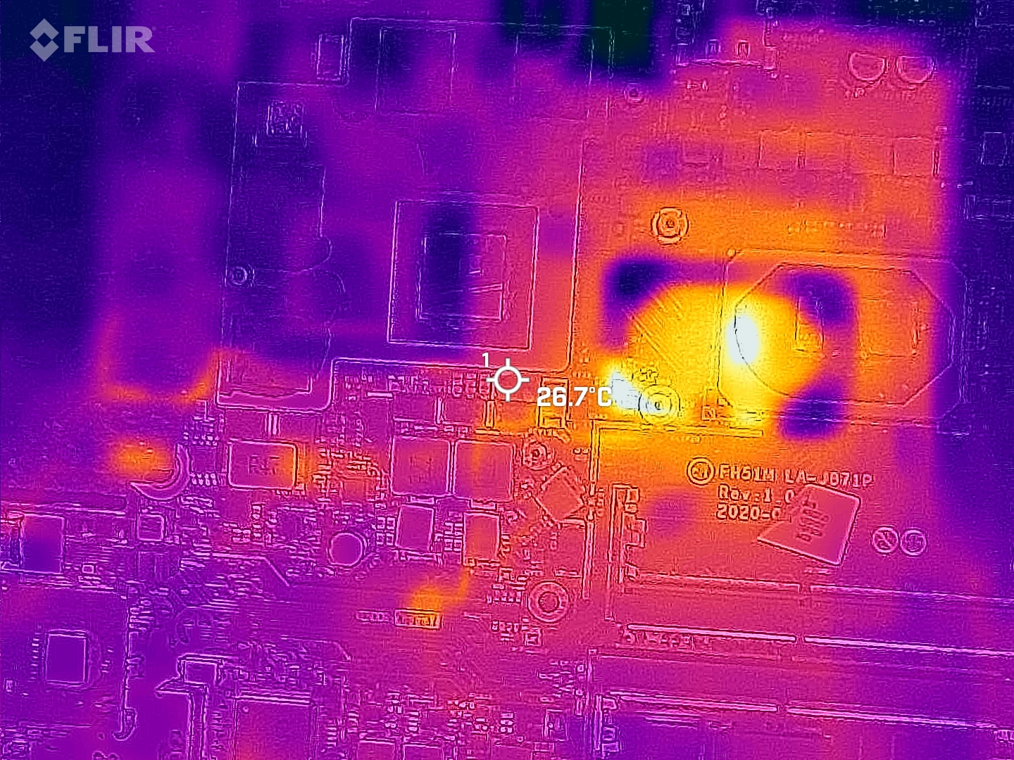

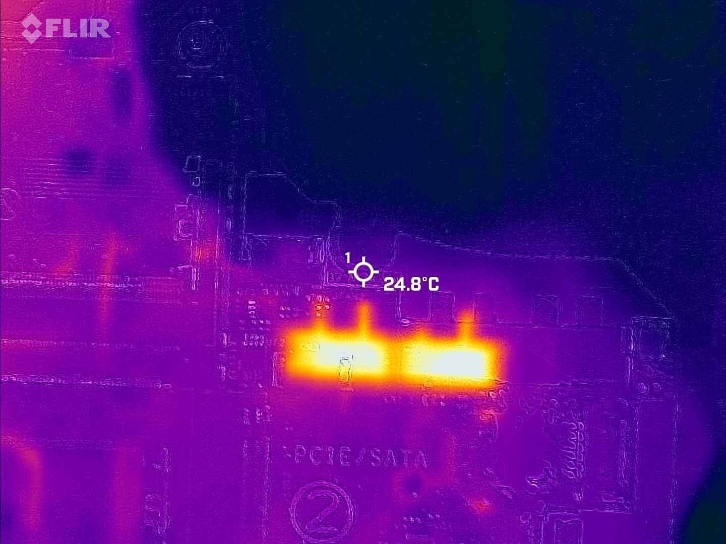

                                        I received the new one I ordered, which seems to perform much better, and I am able to set current and voltage at the same time.
                                        Below are the settings and readings from the unit during voltage injection.
                                        When I set unit at 0.8V and 1.0A, the output on the power supply during voltage injection was 0.81V and 1.0A
                                        Nothing felt warm to me when feeling around the board except the CPU, which was barely noticeable.
                                        I increased the amperage to 2 and the reading during voltage injection was 0.8V and 1.43A. Left it for a few minutes and the amperage never went up.
                                        Increasing the current to 3A didn't change the current draw. It was still 1.43A.
                                        Again, nothing felt warm besides the CPU.
                                        I tried using a thermal camera and the results were inconclusive (at least to me) as the only obvious hot part was the CPU.
                                        I took a few pictures, from the thermal camera, which are attached in case those with more experience with thermal imaging spot something that I did not notice.
                                        Any insights as to why the current draw is only 1.43A.
                                        I'd appreciate additional input on what I can try next in troubleshooting.
