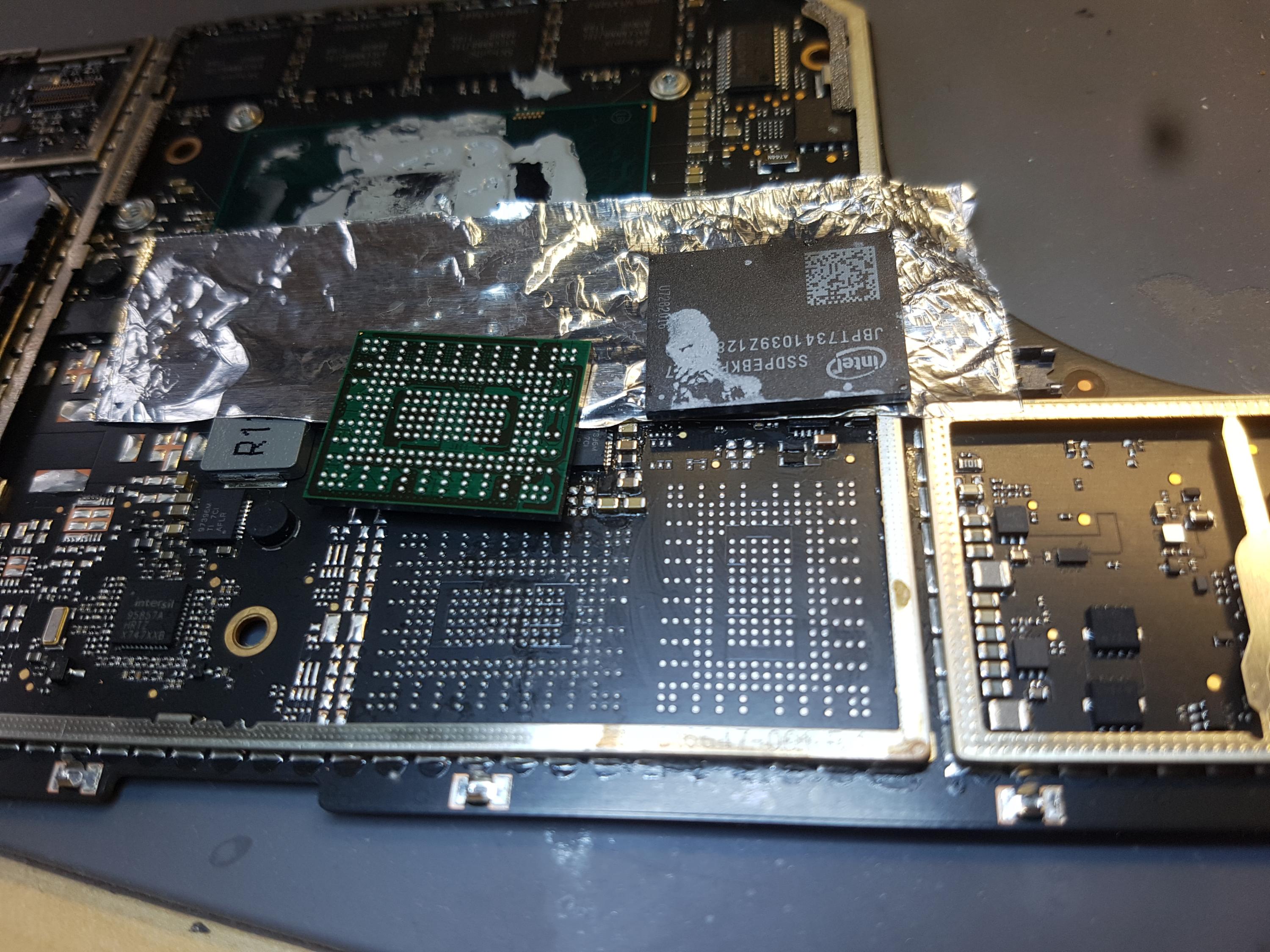

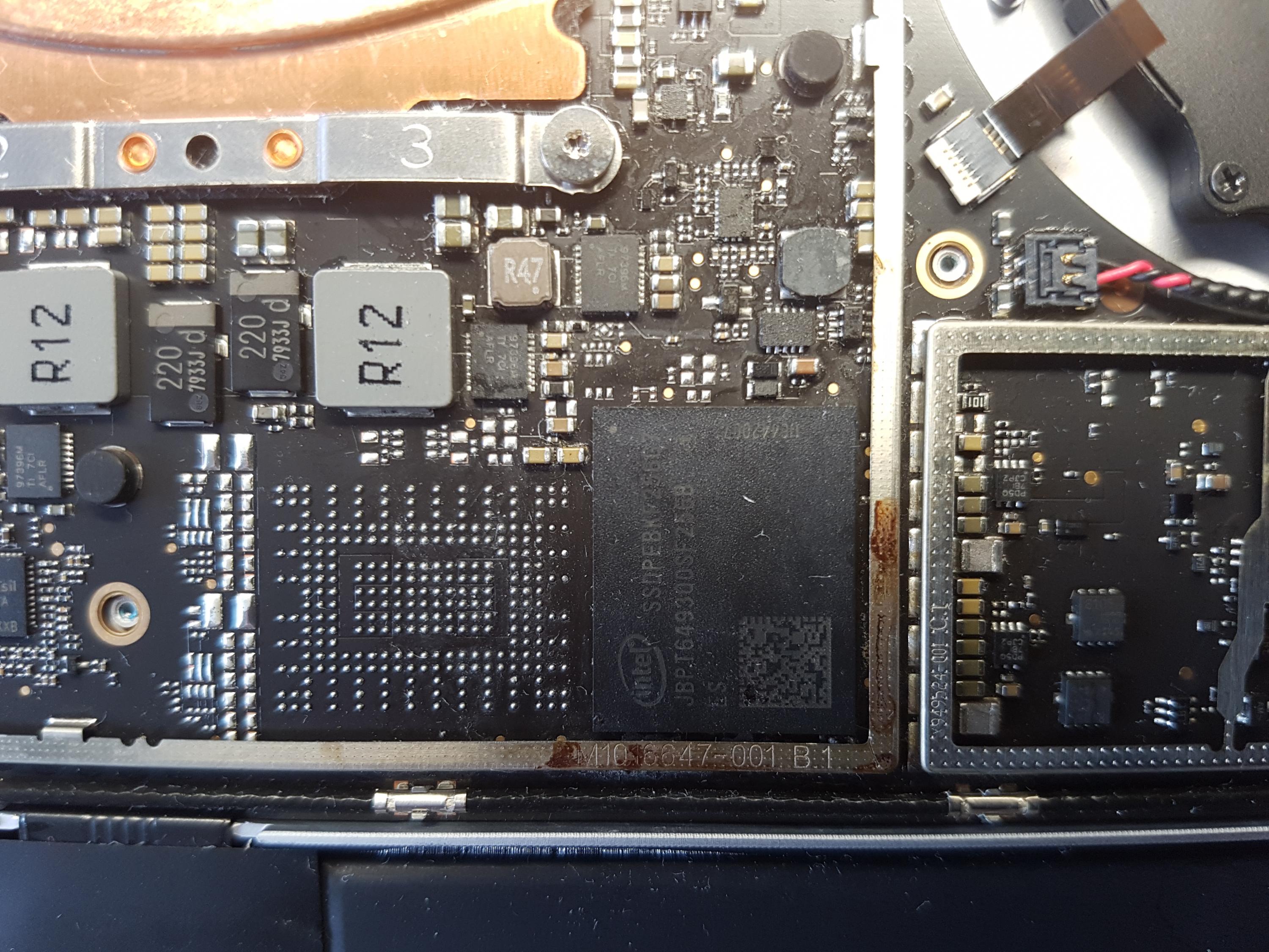

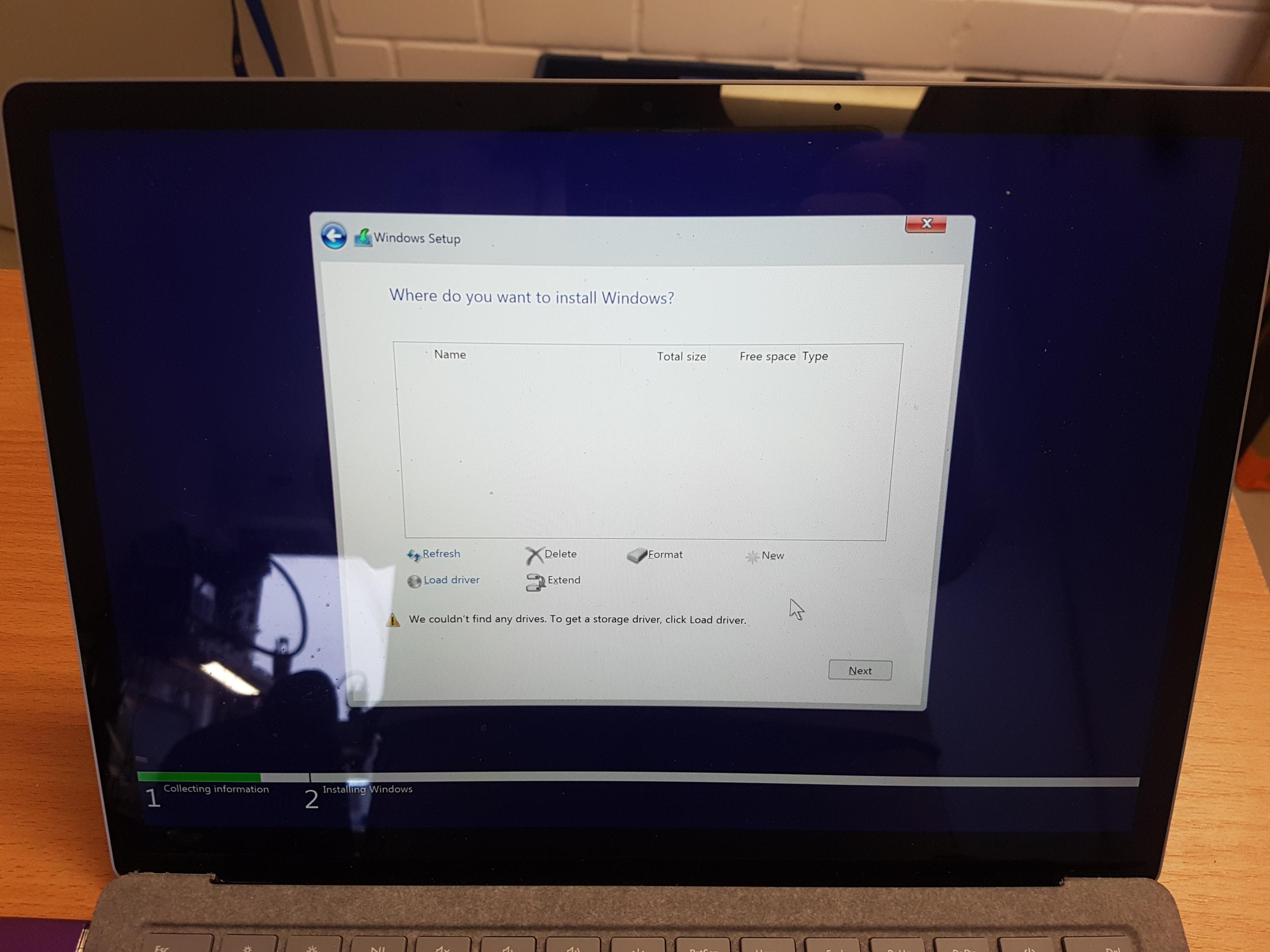

    Hello
    I got this surface with bad SSD, full of bad blocks.
    The original NAND is intel SSDPEBKF128G7
    Ive ordered an intel SSDPEBKF256G7 to double the hard drive space.
    NAND flowed in place well so I dont think soldering was a problem
    No shorts and resistance seems good in SSD line.
    BUT, when installing windows, no HDD detected on the drive list...
    Does the bios need to be worked?
    What am I missing?
    Has someone done these NAND replacements on these devices that could help me here?
    Thanks in advance
    Original Bios and photos in attachment

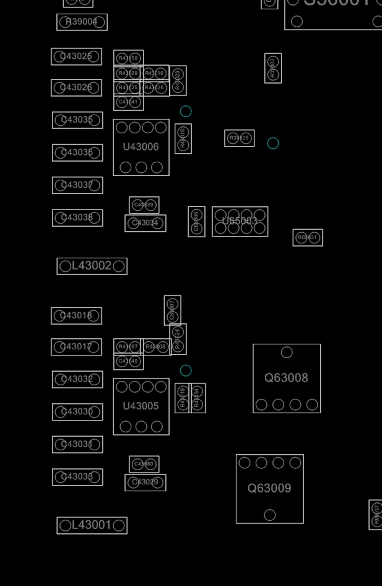

    Bad soldering, bad IC. It should work without any modification. Check voltage on L43002 and L43001

        Re: Microsoft surface 1769 SSD NAND replacement
        Thanks for the reply.
        1.2V and 1.8V SSD are present
        Soldered seemed fine as NAND flowed into place nicely
        But to be sure, reballed it and resoldered it , same thing
        No drive appears in windows install
                Got a message from the seller
                "The chip is brand new. It requires self programming"
                Can this be the case?

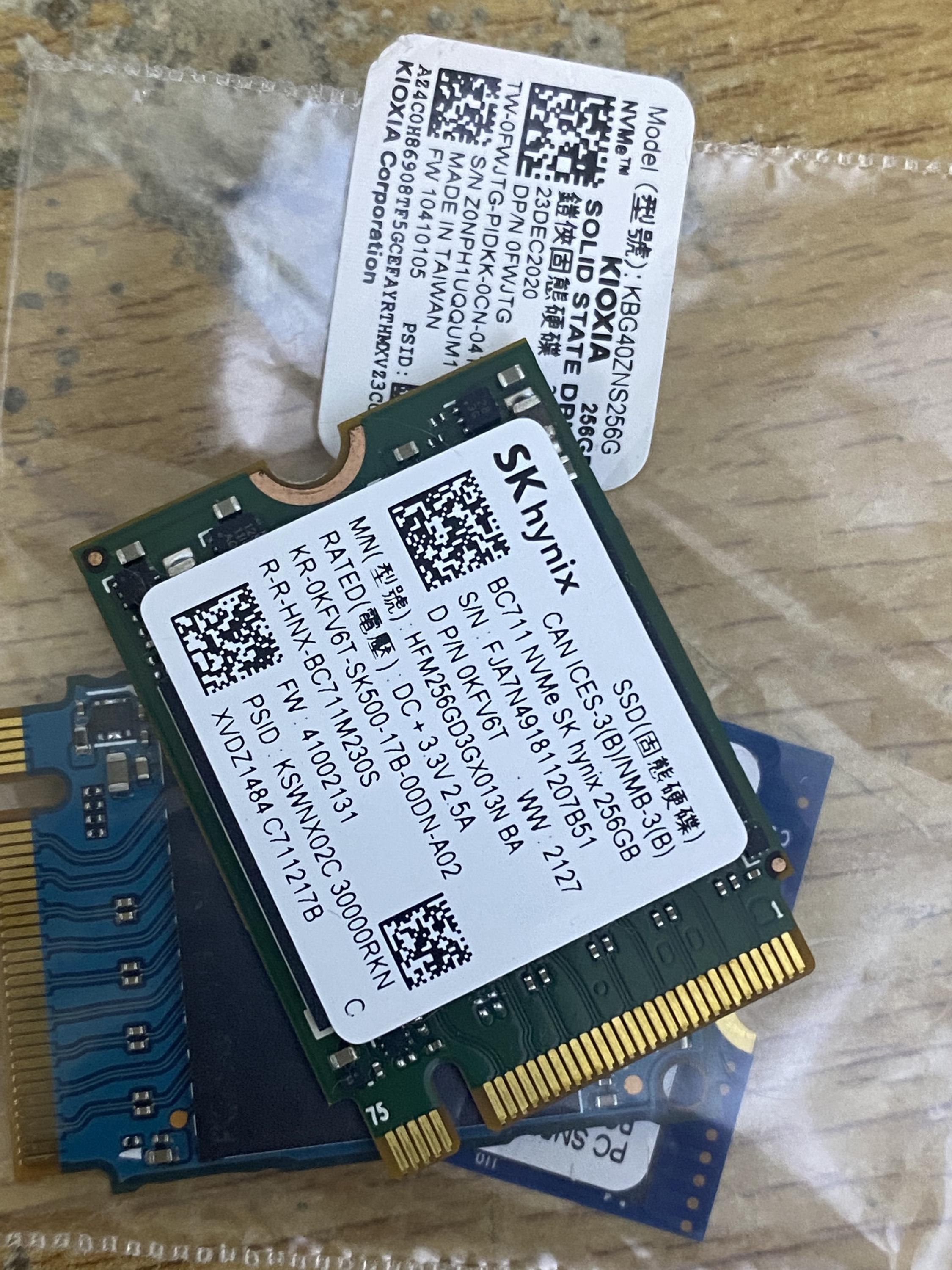

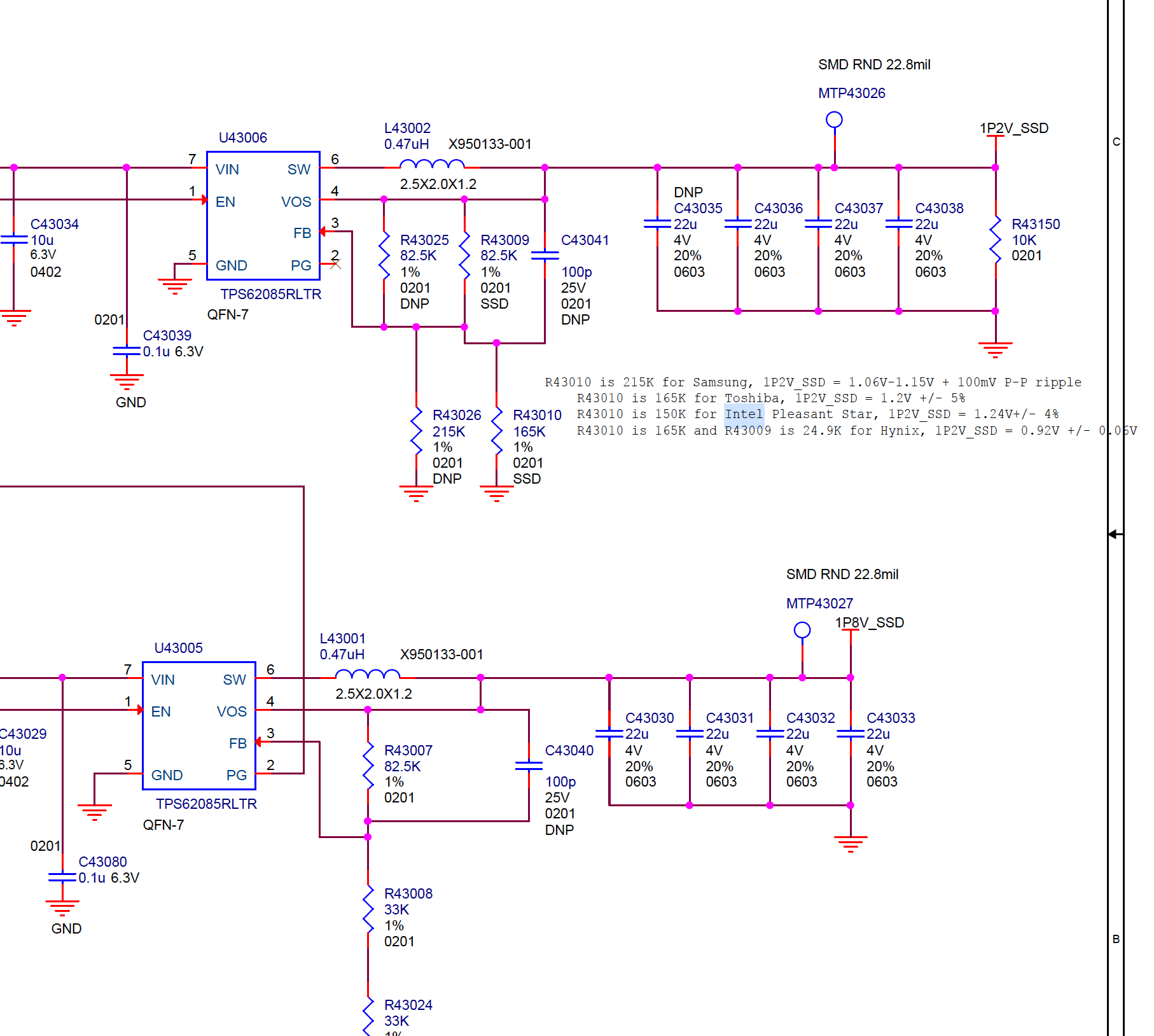

                    Suggest you buy drive like this and reflow IC to your board as I did.
                    I mean Kioxia (Toshiba)
                    or Hynix
                    but you should make modifications according to schematic I've provided

                      Very nice, thanks for the info.
                      I will get one Hinyx and change the resistor, if I can locate it.
                      Is there boardview available?
                      • zakin
                        • Jul 2013
                        • 5
                        • Moldova
                        Here you are
                        [MOD EDIT] Link to boardview https://www.badcaps.net/forum/troubl...matics-request

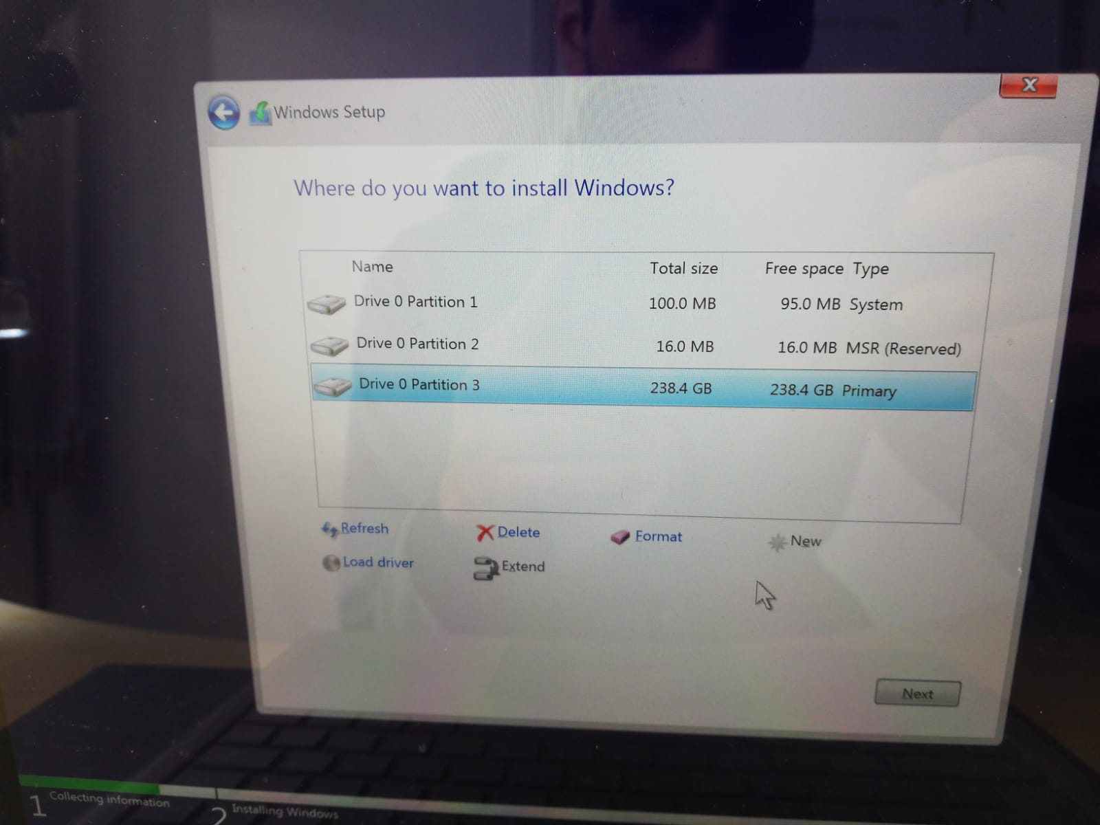

                            or Hynix
                            Thanks a lot Zakin
                            It worked fine after doing as you pointed out.
                            Hynix 256 GB installed with success.
                            Happy Surface again

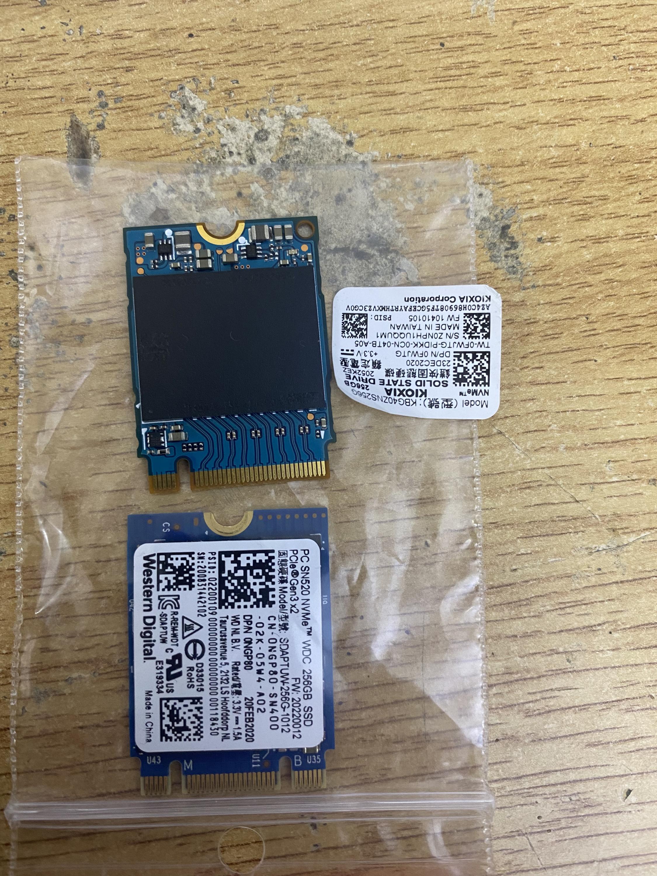

                                Hey good morning, I have currently working with the same issue.
                                But I have questions to ask about the resistor part, could you explain bit about the process?
                                Mine was the samsung 256gb and then I bought the toshiba brand installed, then found out the ssd was short circuit
                                so upon researching I found out the if different brand the ssd resistor should be modified.
                                • Valsval@abv.bg

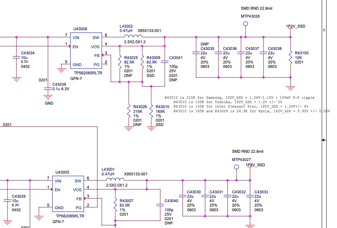

                                  Hello could you please provide also to me the modification needed? Thanko you!

                                    I found that maybe the answer is given here in the schematic diagram directly. Can you confirm please?
