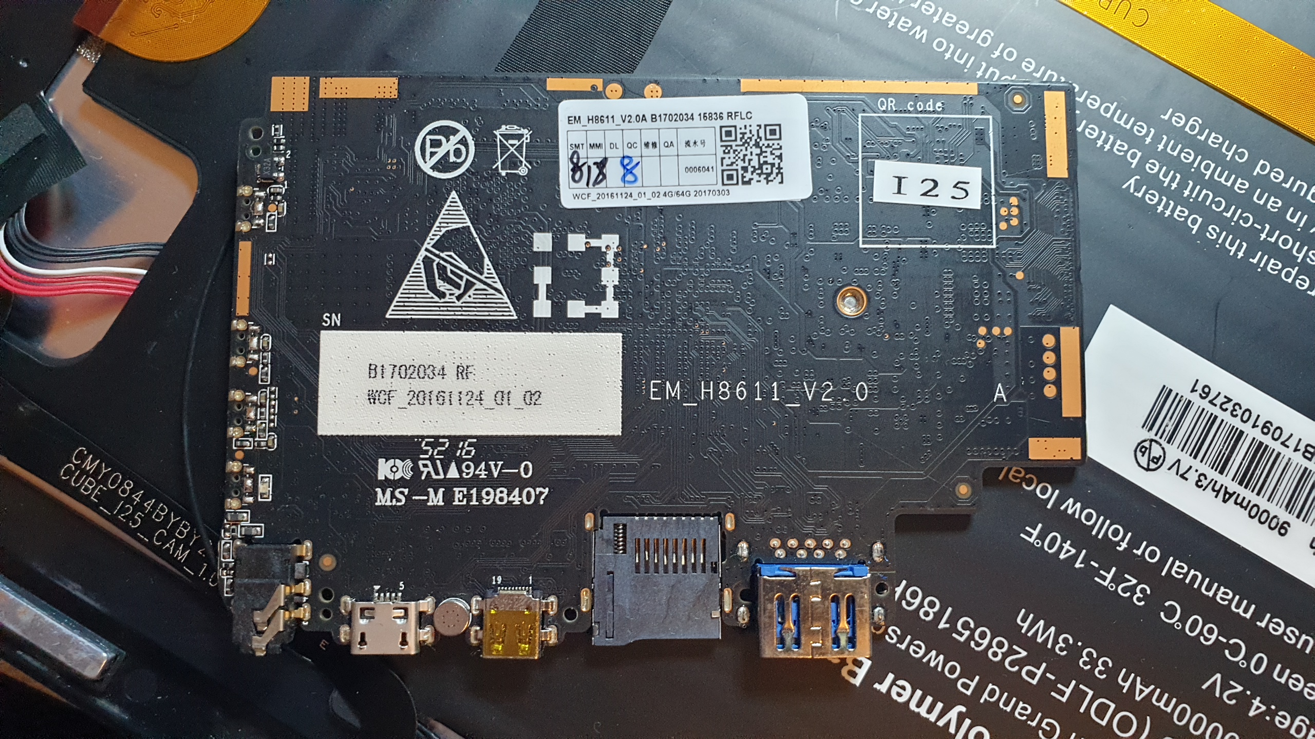

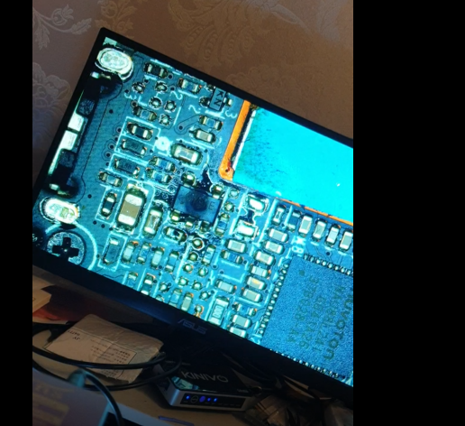

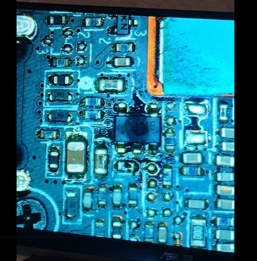

    hi everyone. i am new to posting here so ill try my best to be as descriptive as possible.
    i have 2 linx12x64 windows tablets in for repair. both need usb replacements. one had such a damaged port that it must have caused a spike that burnt the regulator. (ill attach an image) the regulator has "QW6SB" labelled on it.
    i did a bunch of research, and while i could not find an exact match, i did find a sot-23 3 that matched my needs....
    QW MCP809T-475I Microchip Technology
    SOT-23 Voltage detector IC
    4.625V+150mV, -Reset PPO
    considering its a micro usb port and the tablet is rated at 5v2a i think this does make sense. i will be looking for a sot-23 5leg variant, but i just wanted to make sure im on the right track.
    ive looked through digi key, but im quite new to finding parts like this so sifting through the results is a little difficult and confusing.
    https://www.digikey.co.uk/en/product...HliVoqAYxDjxQA
    these are the results i tried to narrow down in digikey. but i dont know what the min/max voltages etc are supposed to be.
    if someone could give me some pointers i would appreciate it.
    all the best
    immy

    Hi. No, this part will not be a voltage detector unless you know this from the schematics?
    A voltage detector is a reset supervisor IC that will check for a specific voltage value (threshold) to be reached. The output (reset signal) is often a logic LOW during the rise of the voltage being monitored. Once the voltage threshold is reached, the output is released = high impedance and an external pull-up resistor performs a soft high on the reset line.
    Then the CPU starts to do its job.
    Rather, suspecting that this fried component is a USB load switch. Still SOT23-5.
    There are many vendors including Microchip, Diodes Inc.
    Before going there, any schematics available for this board?
    Does this component mate with the VBUS line of the USB connector? If yes, then for sure it is a current limited load switch for USB 2.0 use.
      It could be a Silergy SY6280A .Can you post the motherboard part number
      https://www.badcaps.net/forum/showpo...1&postcount=12
      SY6280/SY6280A Datasheet https://cdn.badcaps-static.com/pdfs/...3e2de12517.pdf

        hi thanks for the response. i measured the vcc pin from the usb to that componant and it does indeed connect to it! thats fantastic.
        i tried looking for some schematics but i couldnt find any, i must not be looking correctly, but i did try.

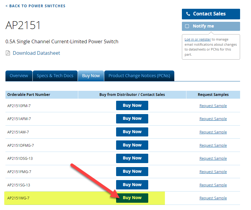

            There are many suitable replacements. The Silergy part appears to have a resistor feature to define the max current level for this load switch. However, for USB 2.0, the max current should be 500mA = 0.5A.
            Respectively, there are fixed current limit load switches on the market such as:
            (you need ACTIVE HIGH for the ENABLE pin)
            AP2151WG-7
            https://cdn.badcaps-static.com/pdfs/...d79531dcde.pdf
            see here:
            https://www.diodes.com/part/view/AP2...roduct-options

                AP2151WG-7
                see here:
                thank you so much for the help. genuinely appreciated!
