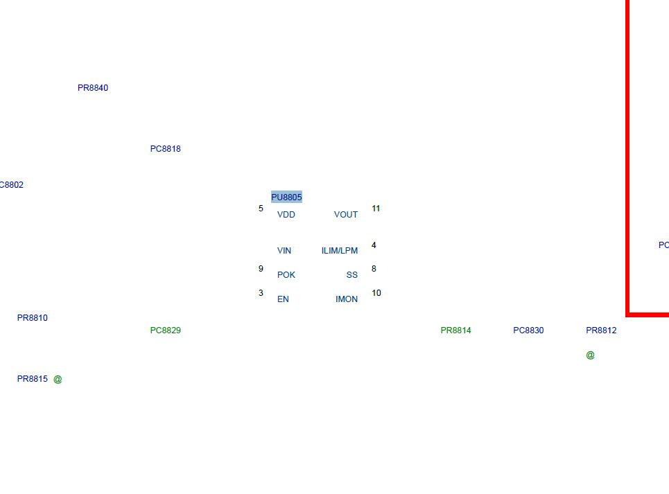

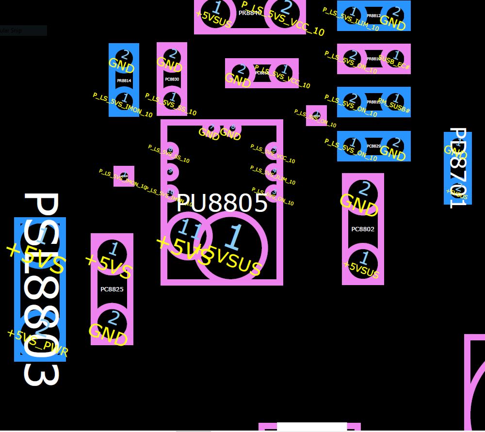

    asus tuf dash f15 no power
    does anyone know what ic on PU8805?...this ic getting burn...on schematic not mention what type of this ic
    this is the schematic

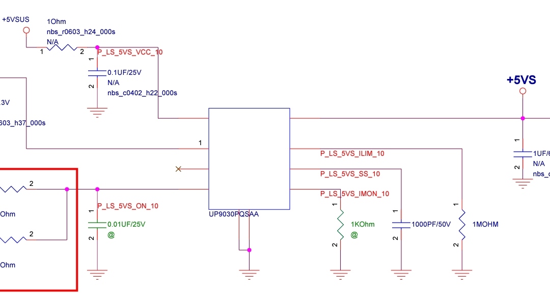

    Re: asus tuf dash f15 no power
    The pdf seems to be a bit buggy or corrupted but it is clearly the same like PU8807 for example, a UP9030PQSAA.
    It works as a load switch so you might be able to source a pin/-compatible controller.
