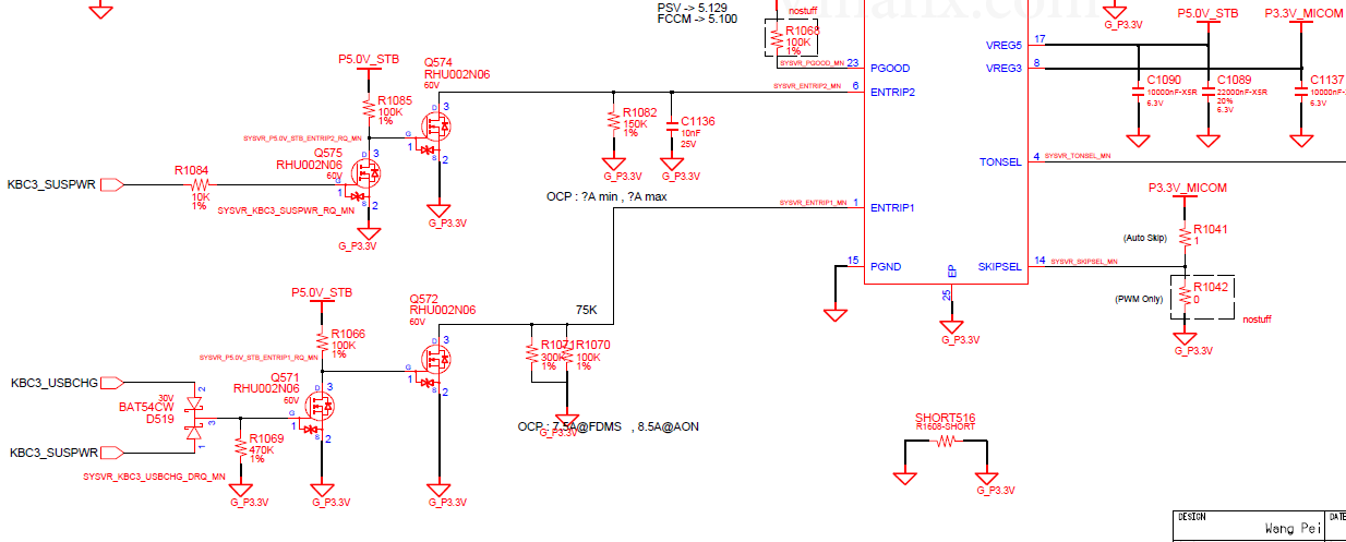

          i screenshot the schematic pertaining the entrip1 and entrip2. attached here as png file. you are correct, the kbc which happens to be MEC1310 is the one that talking to spi rom w25q32bv, and voltage reading on myspi rom is...
          pin1...2.156
          pin2...0.213
          pin5...1,0 -1.1
          pin6...0.210
          i know that voltage measurement does mean nothing, and i have used before my DS1054z to decode the MOSI and MISO out of this spi rom but i cant get a result even i flashed this from different bios dump from this site through other threads. and i noticed a no clocked input and CS signal coming from EC MEC1310. i checked the clocked generator but its ok, as i measures a 32khz output going to the EC.
          i also attached here the schematic as my ref.

                  Both, entrip1 and entrip2 are active high pins but unable to see how these pins will see a logic high to enable each.
                  The mosfets that drive these pins will only produce a logic low. Perhaps there are internal pull ups inside the tps device??

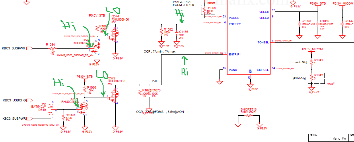

                    to enable both entrip1 and 2, is to have logic high on kbc3_SUSPWROR KBC3_USBCHR., but it is not happening.
                    PLS. SEE attachment for the desired logic.

                      To me, G_ = ground but maybe drawn strange.
                      What are the voltage readings of pin #2 of the mosfets that connect with the entripx pins?

                          Re: BA41-0938A PTC BOARD Model XIDAN-14 Rev 1.2 need help
                          Not sure since the first gate voltage is '1' (logic high).
                          Do you have a voltage on the pull up resistors with _STB labels?
                          There must be pull resistor or similar also on these entripx pins.
                          The mosfet will open = high impedance or close = pull the entripx to ground.
                          How will these pins receive a logic '1' status?

                            if pin1 of both q571 and q575 is high, AFAIK the P5.0v (with stb label) on both pin 3 will be pulled down, thus switching off both q572 and q574. and if that happensentrip1 and entrip2 will be left connected by r1082 and c1136 for entrip2, and r1071 and r1070 for entrip1.
                            ...and it is not happening now on the mainboard of my friend

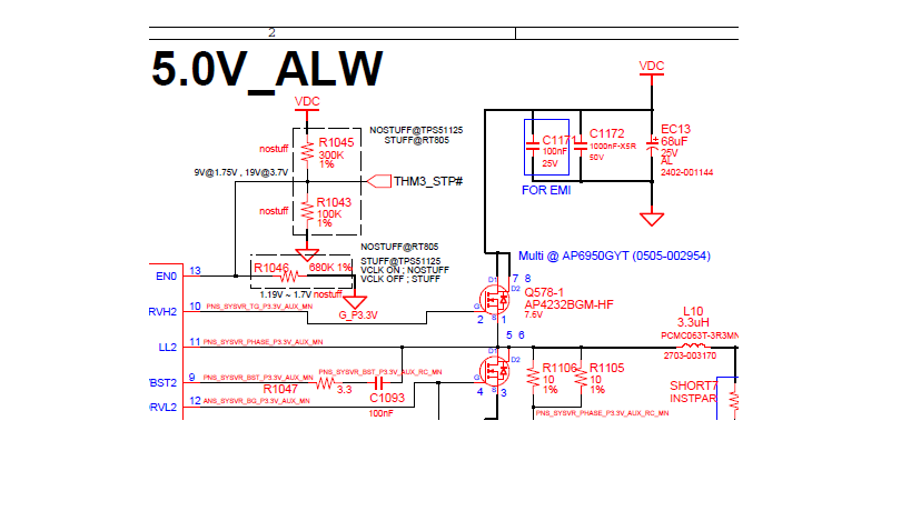

                                    r104, r1045 and r1046 are Not present on actual mainboards. and it indicates at 19v it should have at least 3.7v based on schematic. and upon checking it reads 4.6v.

                                        600kohms down to 50kohms then back again to 600k, maybe due to capacitor across L507 to gnd and L10 inductors to gnd. but definitely is not shorted.
                                        temperature is dead cold. as there was no 3.3v_alw and 5.0v_alw output from L10 and L507, the only outputi get is the 2.0v ref , 3.3v LDO and 5.0v ldo on pin3,8 and 17 respectively of tps51125.
                                        as per datasheet of tps51125, if entrip1 and entrip2 is enabled...it should produce an output on L507 and L10, andthats my problem i think. en0 is ok, VIN is also ok. the missing link is the entrip1 and entrip2 voltage. according to the the datasheet iread, if a 150k resistor is put acroos the entrip2 like in the given schematic, i should expect a 1.5v, but since the gate of the mosfet q574 was at high logic and the pin 6 goes directly to ground thereby negating the purpose of 150k pull down resistor, thats why im getting no voltage reading
