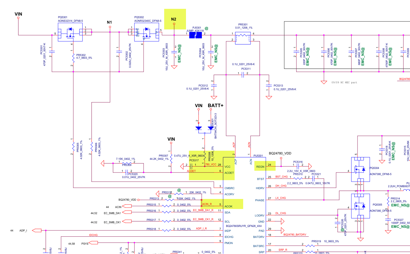

    Hi guys, I have searched for this particular issue for the NM-C781 board but all I could find were schematic and bios requests, so apologies if this has been asked before.
    I've got the above board from a friend, it appears to charge ok but as soon as you press the power button, the LED's on the side and on the button itself just flashes. I have checked around the board, there are some low resistance values to ground on some of the coils, mosfets and capacitors but they are not dead shorts (3.7 to 5 ohms) so im not sure if that normal.
    I was wondering if anyone else had come across this issue and what they did to rectify it (if it's even fixable). I did read that the issue could also be caused by bad BIOS, I'm still waiting for my eprom programmer to arrive.
    Thanks guys and gals
    Andy

    Re: Lenovo GS452/GS552/GS752 NM-C781 pulsing power led
    Hi. See attached.
    Carefully measure and post the voltage readings of the charger IC pins (highlighted) with the power adapter connected and logic board turned ON.
