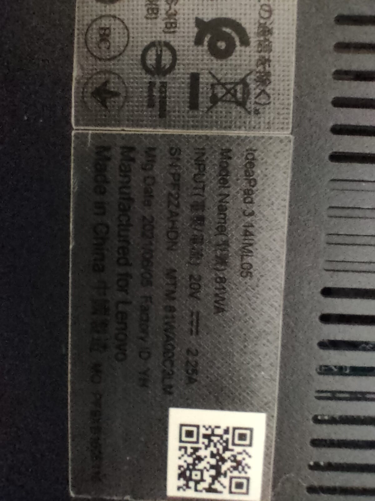

                          Re: ideapad 3-14iml05 bios GS452 GS552 GS752 NM-C781
                          I need help for my bios. Thanks guys!
                          IdeaPad 3 14lML05
                          Model Name - 81WA
                          SN:PF2AN3MT MTM:81WA00C0PH
                          Mfg Date: 20/07/29 Factory ID: JVHFC1

                              always when you make a bios request, post the original bios of the laptop, even if it is corrupted here, not elsewhere... if you read post #9, you had the bios solved 4 hours ago and we didn't waste any more time either...
