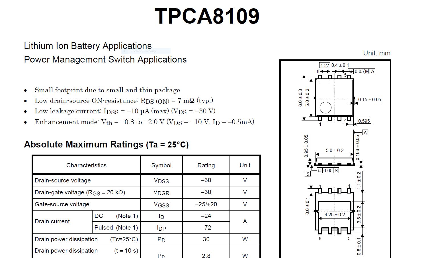

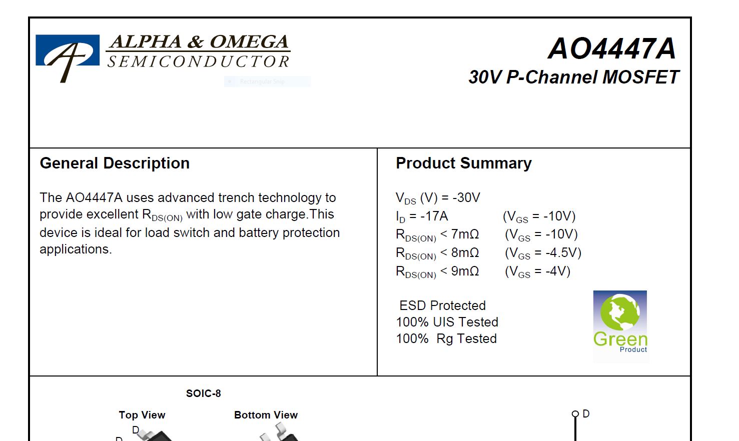

    i have acer Aspire ES1-432 DA0ZQFMB6F0 which is the mosfet tpca8109 damage...is that possible to replace mosfet TPCA8109 with AO4447A?
    Datasheet AO447A
    Datasheet TPCA8109

    The pinout is the same - both are P-channel.
    However, the replacement AO4447A is a lower current device @ 17A vs. the original @ 24A.
    Otherwise, yes it will work.
    You can try it and monitor the temp of this device. If your logic board consumes < 17A then this replacement part is a valid replacement.

        No. It is the opposite. The higher the current support, the better the part.
        To achieve the higher current support - the Rds value will be lower (this is the resistance is in milliohms). Here, the lower the Rds value, the better the part.
        Much like a car - more horsepower, the faster the car can run.
        But if the logic board does not consume the high current value then often you can replace with a lower current part. That is, the mosfet is often overrated to be safe and to allow the mosfet to run cooler.
