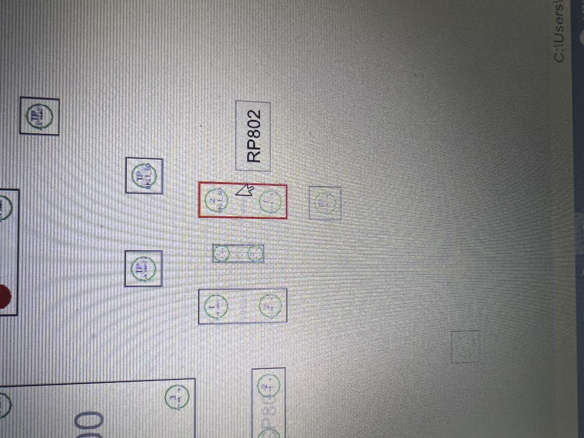

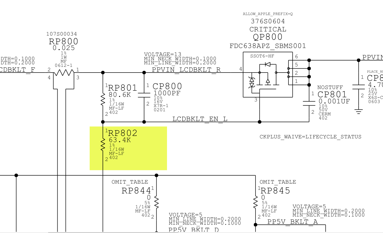

    Re: Lost Diode/Resistor RP802 MacBook Pro 2020 A2338 HELP
    Hi.
    1) it is an 0402 SMD size resistor that is very common and cheap to source.
    2) See attached.
    3) RP802 = 63k4 1% 0402 size resistor. The part does not have to be exactly this resistor value (but should be close) nor the 1% tolerance to function but best if you can source the same specification.

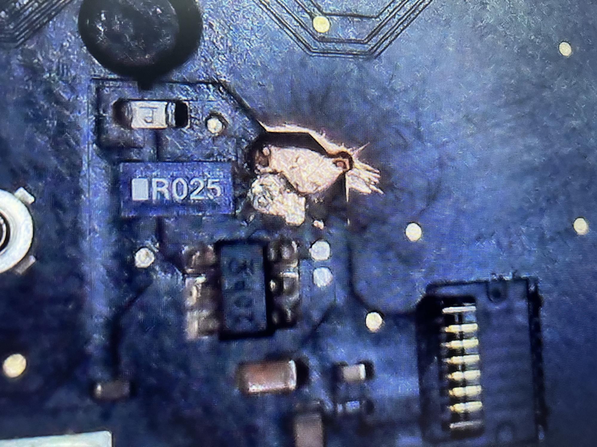

        Here is the photo:
        • XxMicroSoldering
          • Oct 2022
          • 38
          Here is the photo:
          As you can see I messed it up. Hope you can help me
          Regards
            Post a larger picture of this PCB area so we can determine where you are.
            It will be best to practice soldering on a donor or scrap board from Ebay or similar before attempting this repair. This is a very high-density board with cell phone size parts and are very difficult to handle for even the experienced techs.

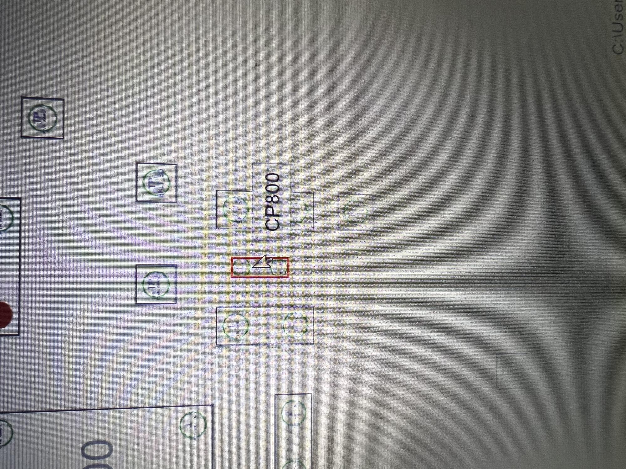

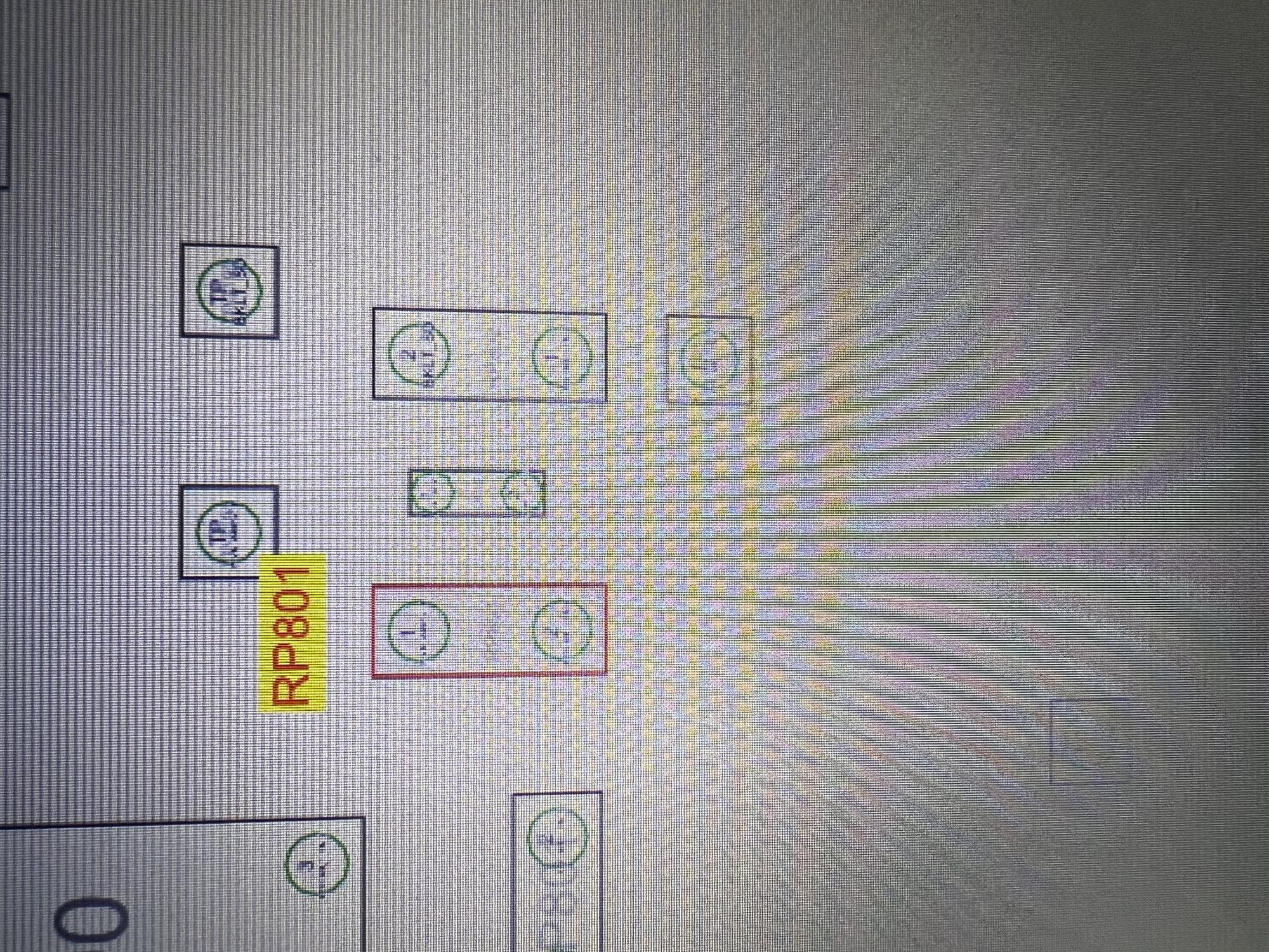

              Here are the photos. As you can see there are in total 3 diodes / resistors missing do you know the name of them so that I can take them out of the donor board and install them in the good board. And how about the mess I made on the pcb how can I fix that
              Regards
              • mon2
                • Dec 2019
                • 14813
                RP801 = 80k6 = 80.6k resistor 0402 size 1% tolerance
                CP800 = 1000pf capacitor 0201 size 10% tolerance; 16 volts or higher rating; X7R dielectric (this style defines the capacitance and how it will remain steady as the temp changes - too hot or too cold)
                RP802 = (noted before) 63k4 = 63.4k resistor 0402 1% tolerance
                Each of the above parts are with no polarity so they can be soldered in either direction.

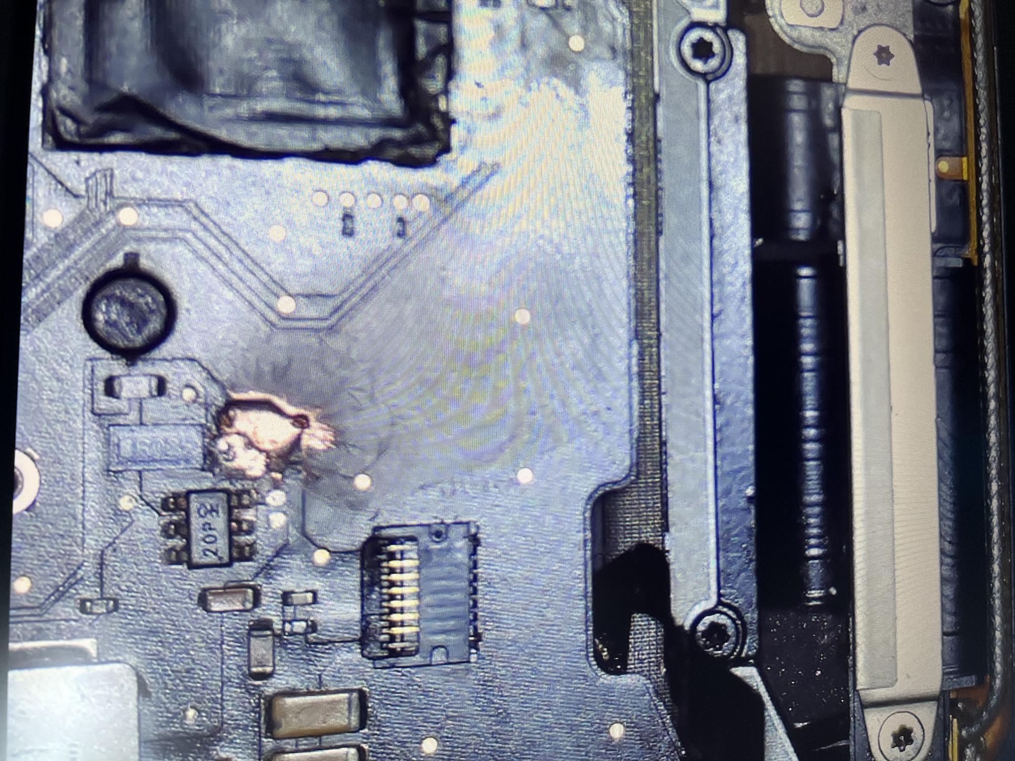

                      How to fix this (MacBook pro M1 2020 Motherboard
                      Hey Guys
                      I'm a newbie to microsoldering I messed up the board a little bit when replacing the backlight diodes and resistors does anybody know how to fix this coper part of the motherboard or is it good to go
                        You have exposed some copper by removing of the topside solder mask. The solder mask is used to insulate the copper. It is not mandatory to have the solder mask so no issue there.
                        It is hard to see where the traces are on your board so you have some options:
                        1) using a meter, you can confirm if the traces on the PCB are properly connecting the components in this pic. Compare the connections with the schematic / boardview files for this logic board.
                        2) plan B: consider to remove some more solder mask so you can clearly view which traces are linked to this exposed ones in your pic. Then confirm the traces are ok with the meter (diode mode) testing again.
                        At a quick glance, do not believe you have any issues here other than some solder mask has been removed. Best to test the continuity before proceeding.

                                  • adamski
                                    • Feb 2018
                                    • United Kingdom
                                    Hi, I would scrape all bad solder mask and then reapply liquid solder mask mask then cure it under uv. You should not leave so much copper exposed. I mean you can, but the repair will look bad. Also make sure you have no shorts to the ground before powering anything.
