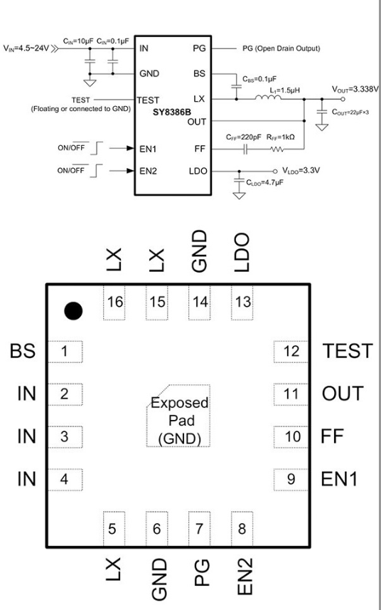

    Hello I need to know what is that element PU401 and where can I buy it.

    Re: Lenovo LA-H105P element identification
    https://www.aliexpress.com/item/1005002712638544.html
    https://www.aliexpress.com/item/1005...920002059922_1
    https://www.ebay.ca/itm/174495343658
