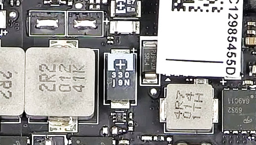

    Found a better frame, now the diode is visible, though I still don't know what it is. Schottky maybe?
    Cheers,
    sect-sin
      Re: Razer Blade 15 (2020) missing components
      You're saying, there are no unexpected shorts around the 3.3V/5V controller? Missing components are usually a bad thing if the board was powered on, but in this case it shouldn't be responsible for blowing a fuse.
      However, there's definitely something wrong in charging area and "no short found" just isn't enough to work with from here. We need measurements and in best Case a (self written, maybe partial) schematics to understand what is going on and what connects to where. The guess work ends here for sure.

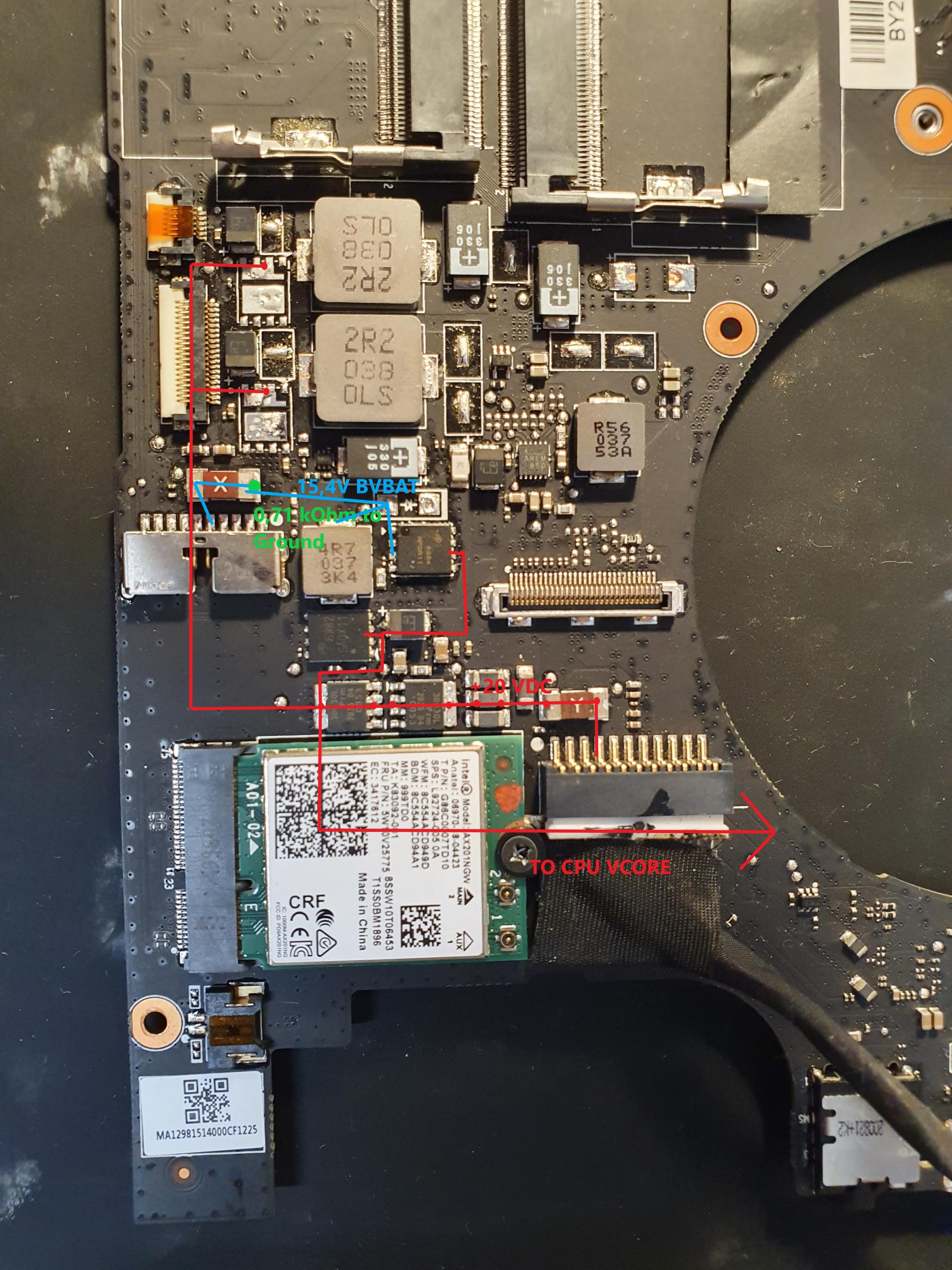

        I made a small schematic of the power-in area with some rudimentary traces, see attached. Now that you mention shorts, I checked again, and the board side of the blown fuse marked X shows 0,71 kOhm to ground, which may be a partial short. Voltage injection brings me nowhere though, as it is drawing 0,2 amps only, and nothing lights up.
        Of particular interest to me is the AON 6854 MOSFET which connects VDC from the adapter with the battery - is this a MOSFET responsible for regulating the voltage charging the battery?
        Please let me know where to go from here or what to measure further.
        Thank you very much in advance!

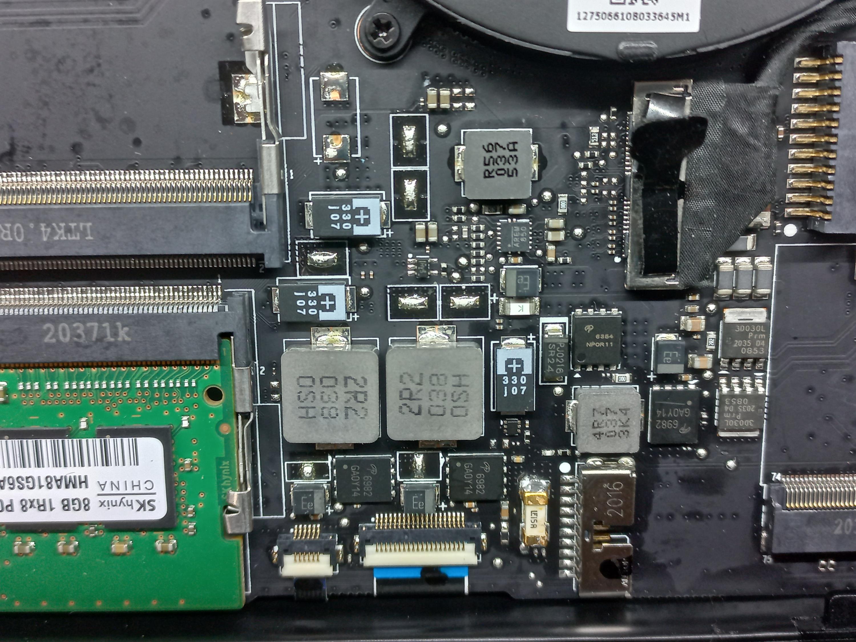

          Currently working one of these boards. Attached the picture you requested.
          In this particular case there was a blown battery fuse and a bad cap near the processor. Replaced both and the board turns on, but LED only blinks green and the CPU gets hot, no POST; so there may be component damage.
          In your case, have you tested all the fuses? This board seems to have a lot of fuses.

            Hi boster27,
            You are a DEMIGOD, thank you so very much for your photo. I now know that my missing diode is an SR24 schottky. I will be eternally grateful for your help.
            Yes, I checked all the fuses, all are fine except the battery fuse marked X, which keeps blowing. There probably is a partial short somewhere, which I need to track down.
            Could you measure the resistance to ground of your battery fuse?
            If you need any measurements from me, I am happy to do them, just let me know.

                Of course the board won't work by just adding the missing components. They were obviously removed for some reason.
                So now the real troubleshooting begins:
                Full overview of the board, each coil and main power rail, voltages and resistances to GND. We'll move into the direction of the issue from there.

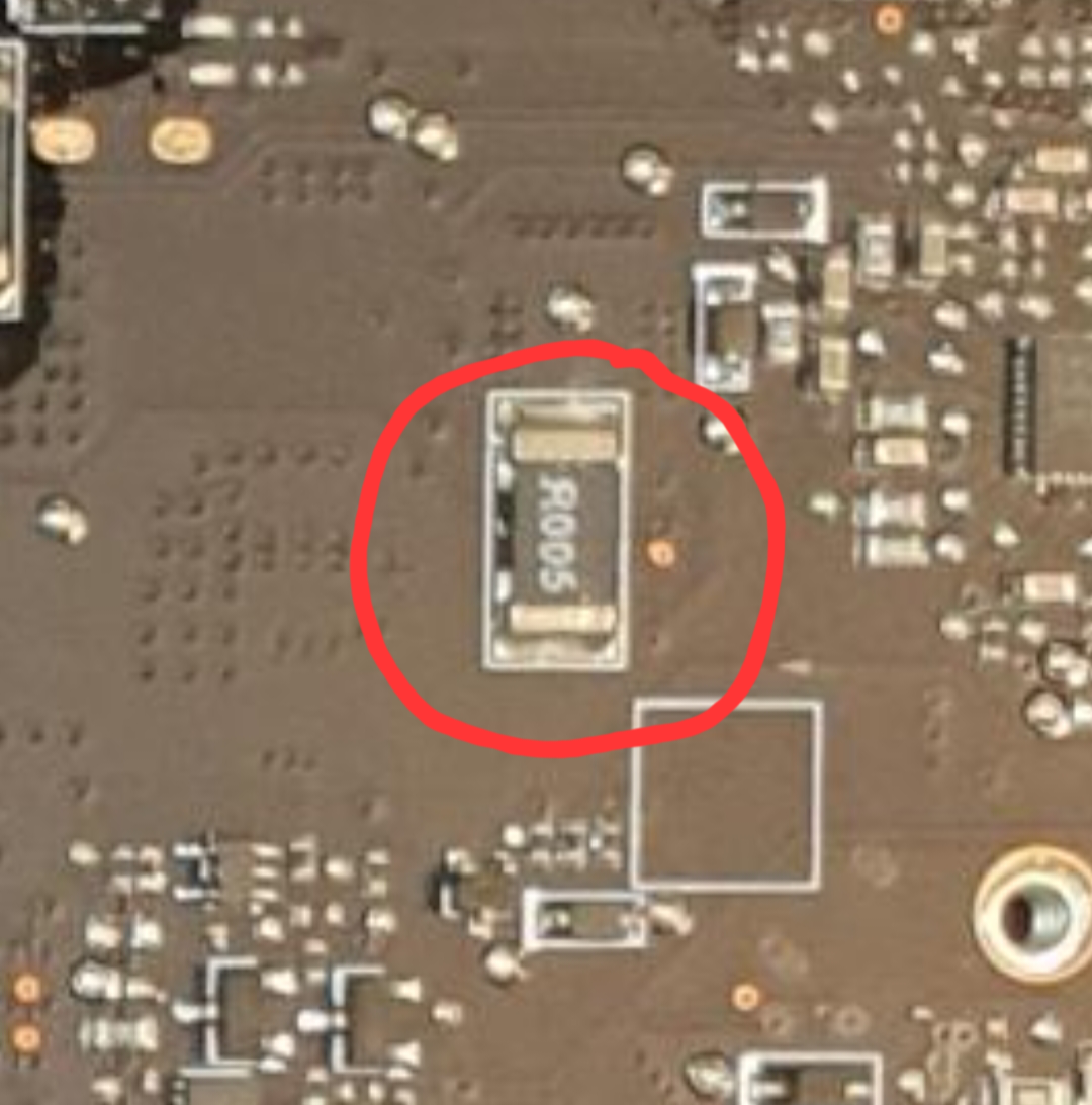

                    Check this resistor out. I guess this is the current sense resistor for the main power rail (or the other one upper left of this one. One of the them is connected to the coil for battery charging, but we're looking for the other one which is NOT connected to the battery coil.)
                    Voltage and resistance to GND please. We work from there, backwards or forward.

                      Hi Seph,
                      I am sorry about the resolution, it was fine on my machine, I guess the Badcaps forum engine scales it down. Need to take that into consideration for the future. Anyway, I have redone it, with larger red characters, see attached.
                      Resistance values of both CSR's check out. The bottom one is indeed the one connected to DC. When powering the board, no voltage is present on either CSR. Then I measured resistance to ground on the one CSR you mentioned, which shows 2,5 Ohms. This seemed awfully low to me, so I took the liberty to inject some voltage. This drew 1,5A @ 1.0V, and one of the five GPU dual MOSFET's (AOE6930) lighted up.
                      I have a good feeling that I might be onto something here. If you agree, I will order a replacement MOSFET, and keep you posted.
