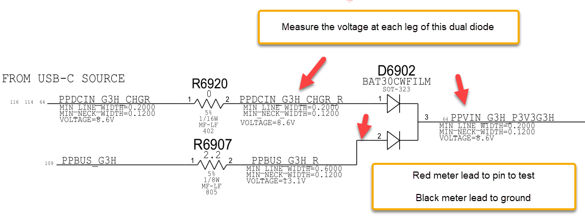

                              1) Confirm the input voltage to the U7000 (ISL9239) @ PPDCIN_G3H (see the left side of the schematic page with U7000).
                              What is the voltage ?
                              Any liquid damage / corrosion in this area of the logic board ?
                              2) See attached. Post the voltage readings of D6902 pins (although you have listed that PP3V3_G3H is present in an earlier post).
                              3) Confirm again the presence and voltage of PP3V3_G3H.

                                Re: a1707 820-00281 no power stuck at 5v
                                PPDCIN_G3H 5c i confirm
                                Pin1 5v
                                Pin2 0v
                                Pin3 4.8v
