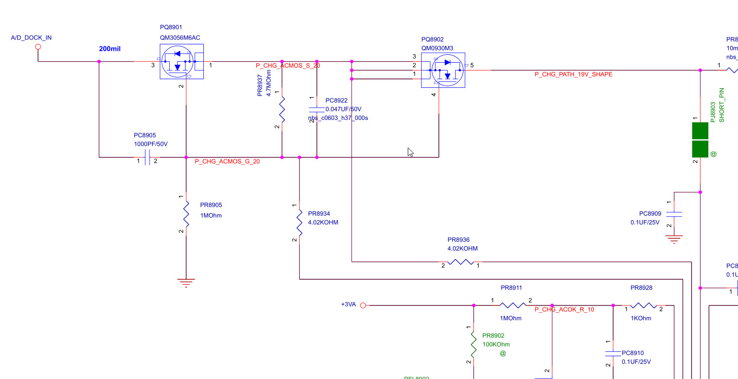

    Hi
    Newbie here. Reading as much as i can.
    I have this asus board with missing voltage on the gate's ac/in Mosfets, so it's "dead". From similar posts, gate's voltage should(?) come from BQ74780S, that i think is pu8091 on the boardview found in the forum.
    1 - 0v
    2 - 0v
    3 - 0v
    4 - 0v
    5 - 0v
    6 - 2.63v
    7 - 0v
    8 - 0v
    9 - 0v
    10 - 0v
    11 - 0v
    12 - 0v
    13 - 0v
    14 - 0v
    15 - 0v
    16 - 0v
    17 - 0v
    18 - 0.05v ????
    19 - 0.15v
    20 - 0.15v
    21 - 0v
    22 - 0v
    23 - 0v
    24 - 6v
    25 - 5.91v
    26 - 0.15v
    27 - 0.15v
    28 - 19.30v
    On a side note, board works and boots windows the Sorin way.
    TIA

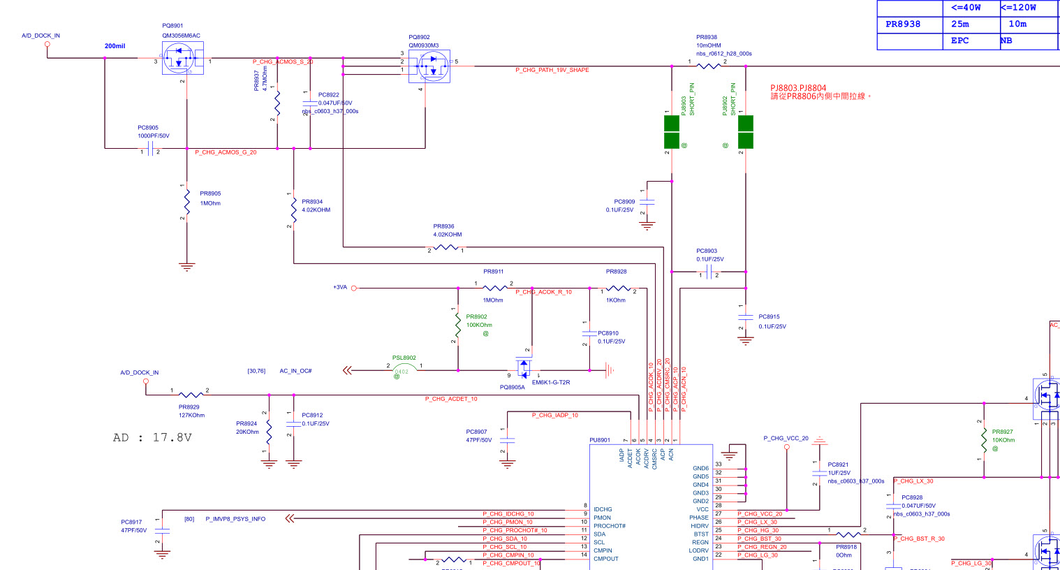

      So, if i'm getting the guide right, i have this :
      DCIN/VCC: pin 28 - 19v, ok
      ACIN/ACDET: pin 6 - 2.63v, ok
      REGN/VDD: pin 24 - 6v, ok
      CMSRC : pin 3 - 0v, (comes from source of first mosfet, that is not switching on, so OK ????)
      ACOK: pin 5 - 0v (not OK, right ?)
      ACDRV: pin 4 - 0v (not OK, should have 24v, right?)

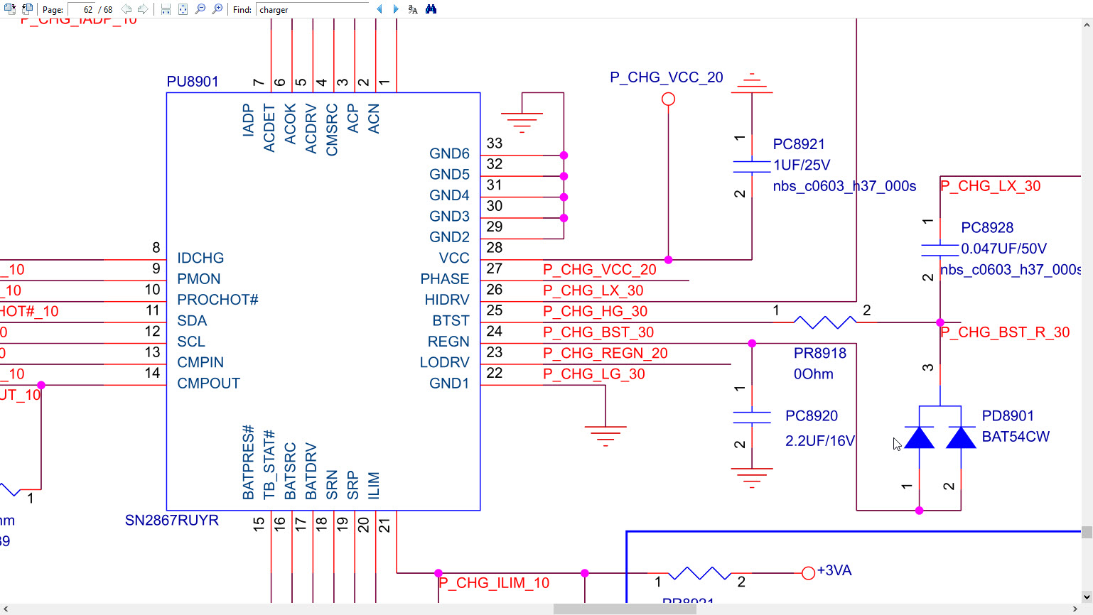

      • mon2
        • Dec 2019
        • 14662
        Re: Need help on a Asus x541uvk rev 2.0 board, please
        It is PU8901 ( I think you meant the same ).
        See attached.
