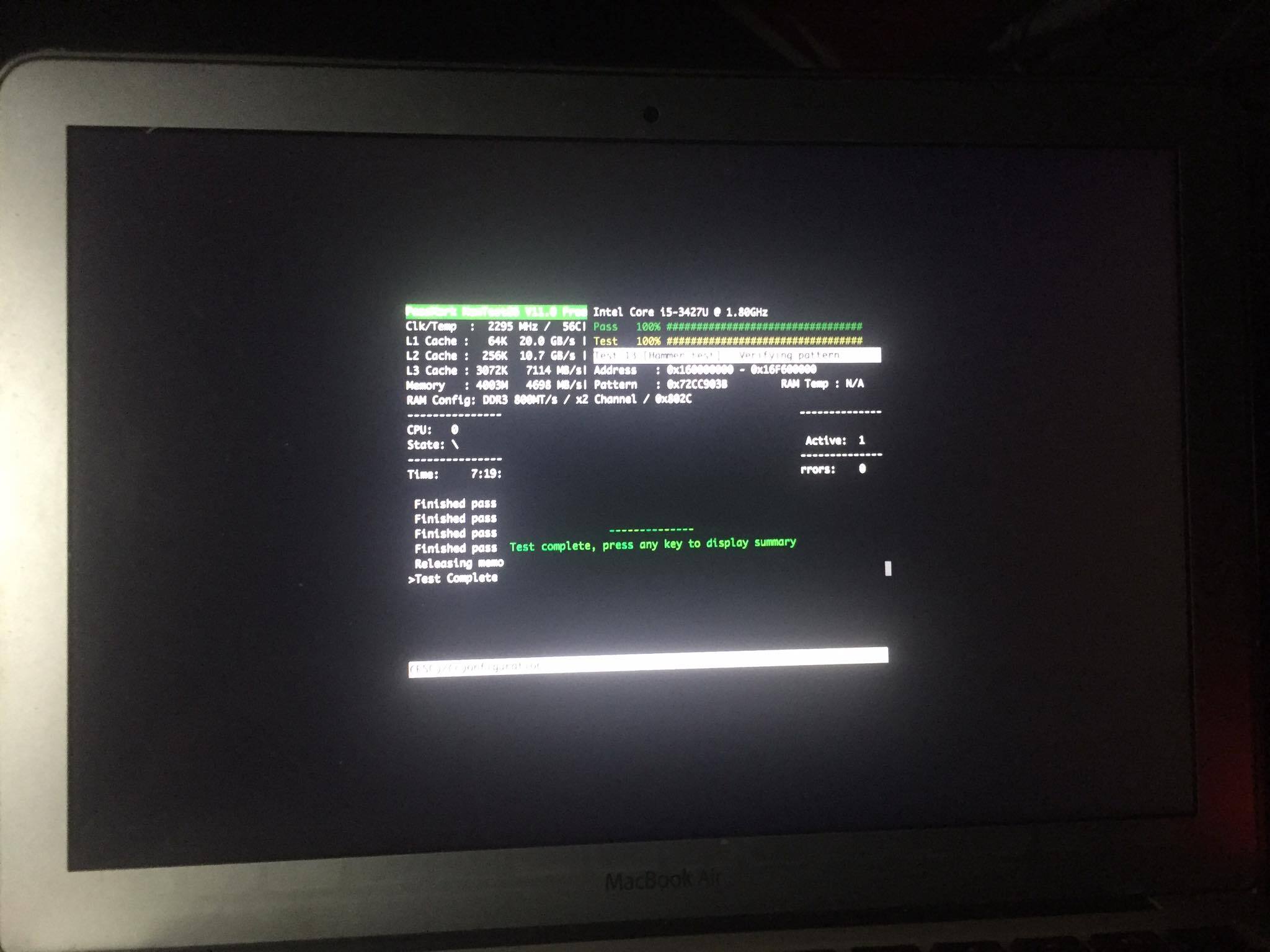

    i got a MacBook Air 13" A1466 820-3209 the history is that the battery Swells that it bulged the top case badly surpassingly it work after battery replacement but while testing it like restart or shutdown for testing purposes i will get a intermittently 3 beeps ram issue. the bizarre thing is it will work if you SMC Reset like 2-3 times then if you shutdown for a long time or do a PRAM reset it will 3 beeps again then SMC reset it will work.
    is this normal?? or someone experience this issue??

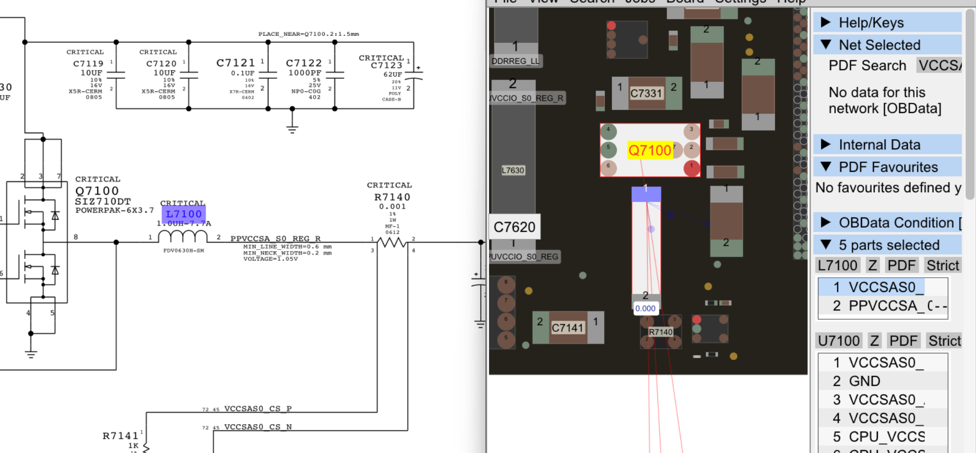

            i got another 820-3209 with the same issue measured all coils then i i found L7100 = PPVCCSA_S0_REG = 0.78v. it should be 1.05v?? said by the schematic??? also no errors with memtest?? the board when it is on it works fine no issue but after shutdown you need to perform again the SMC RESET 2-3times. same as before

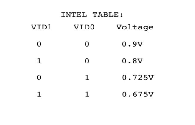

              checking the SCH i fount the VID Set TABLE i think the L7100 = PPVCCSA_S0_REG = 0.78v is within spec
