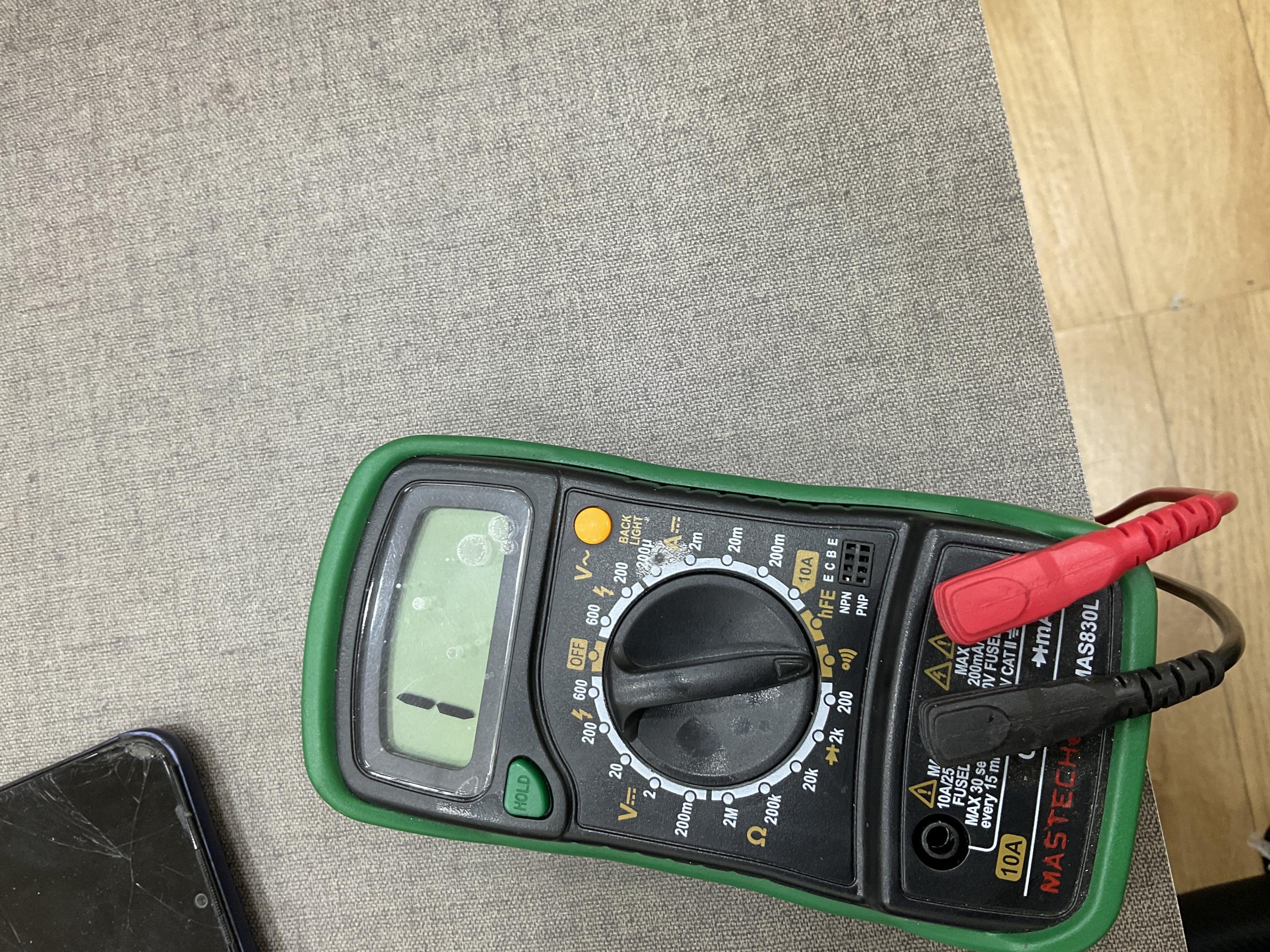

            What is the meter scale used for the resistance scale ?
            Is the reading ~5 k ohms ?
            You are unable to see any graphics even with a flashlight / phone torch mode on the display ?

              Re: Macbook 820-00165 No Image , No Backlight
              Hey!
              We have set the meter scale to this. I hope this is right to test the resistance. PFA below !
              We are unable to see any graphics with a flashlight also. We were able to see the apple logo previously before we had replaced the chip.

                  Ok. The meter is not in resistance mode.
                  When checking resistance -> start with the WHITE text 200 scale (lowest on your meter) -> check the resistance.
                  If you see '1', this means the meter is trying to tell you the resistance is higher than 200 ohms. So switch to the next higher resistance scale till you have a reading.
