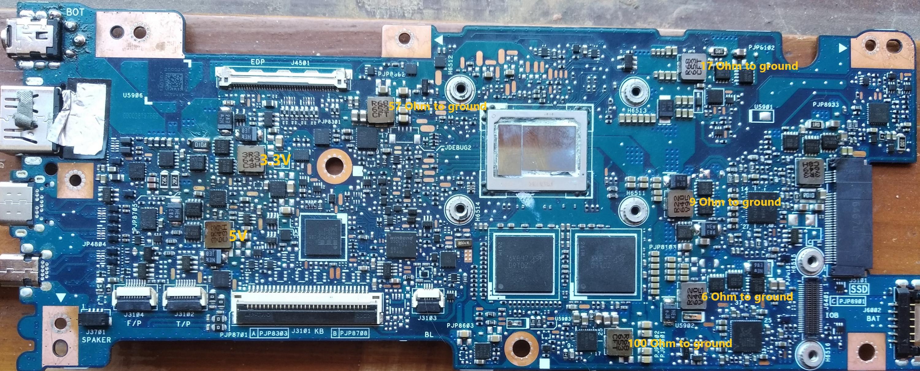

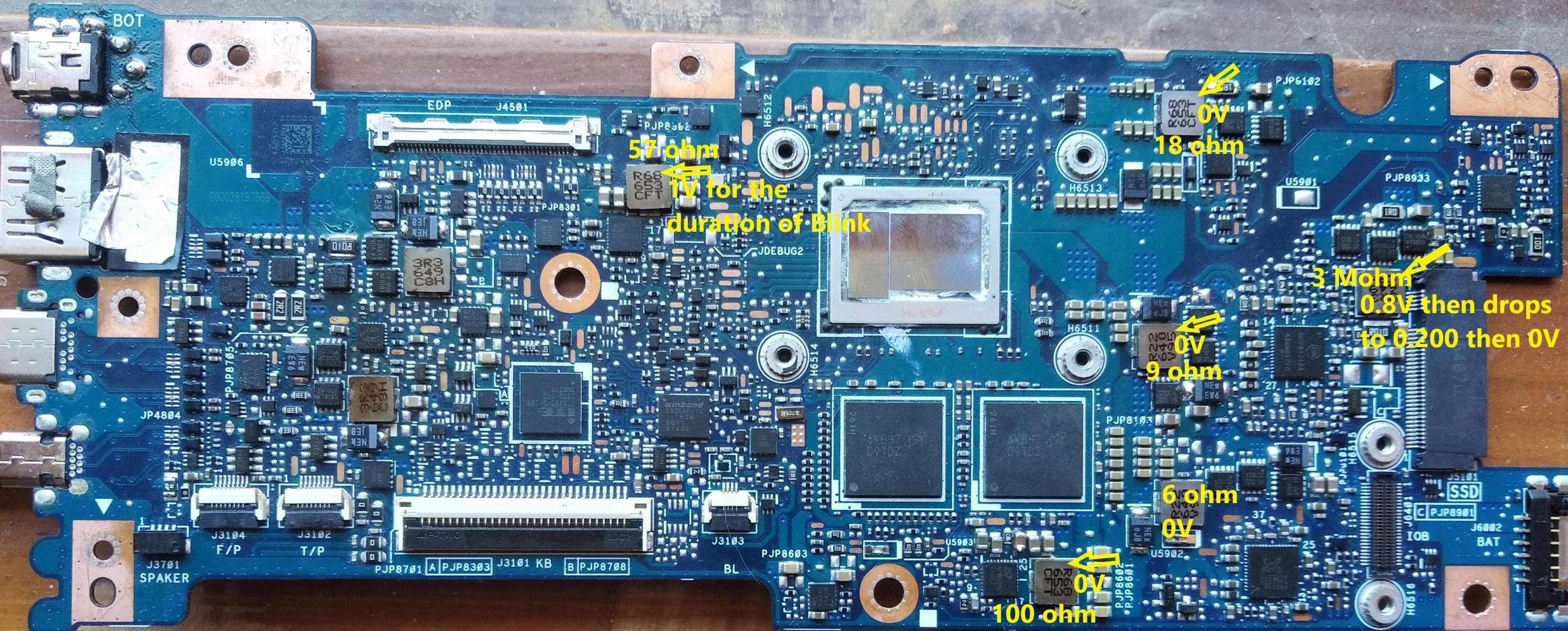

                • doros88
                  • Dec 2015
                  • 12
                  • CYPRUS
                  Re: Asus UX330CA Rev2.0 1Short1long1Short 19V No Power
                  Cannot remove the RAM.(D9TDZ) The SuperIO (ithink) is ITE IT8995VG-128.
                  i attach a pic of the board with the Measured Voltages and resistance to the ground.
                  Next to the 2 coils (the 57 ohm and 100 ohm) is APW6002 which i didnt find datasheet.
                  Also i cannot find the Datasheet for SuperIO ITE IT8995VG-128 so i cant measure any voltage or signals!
                  Thanks Again !
