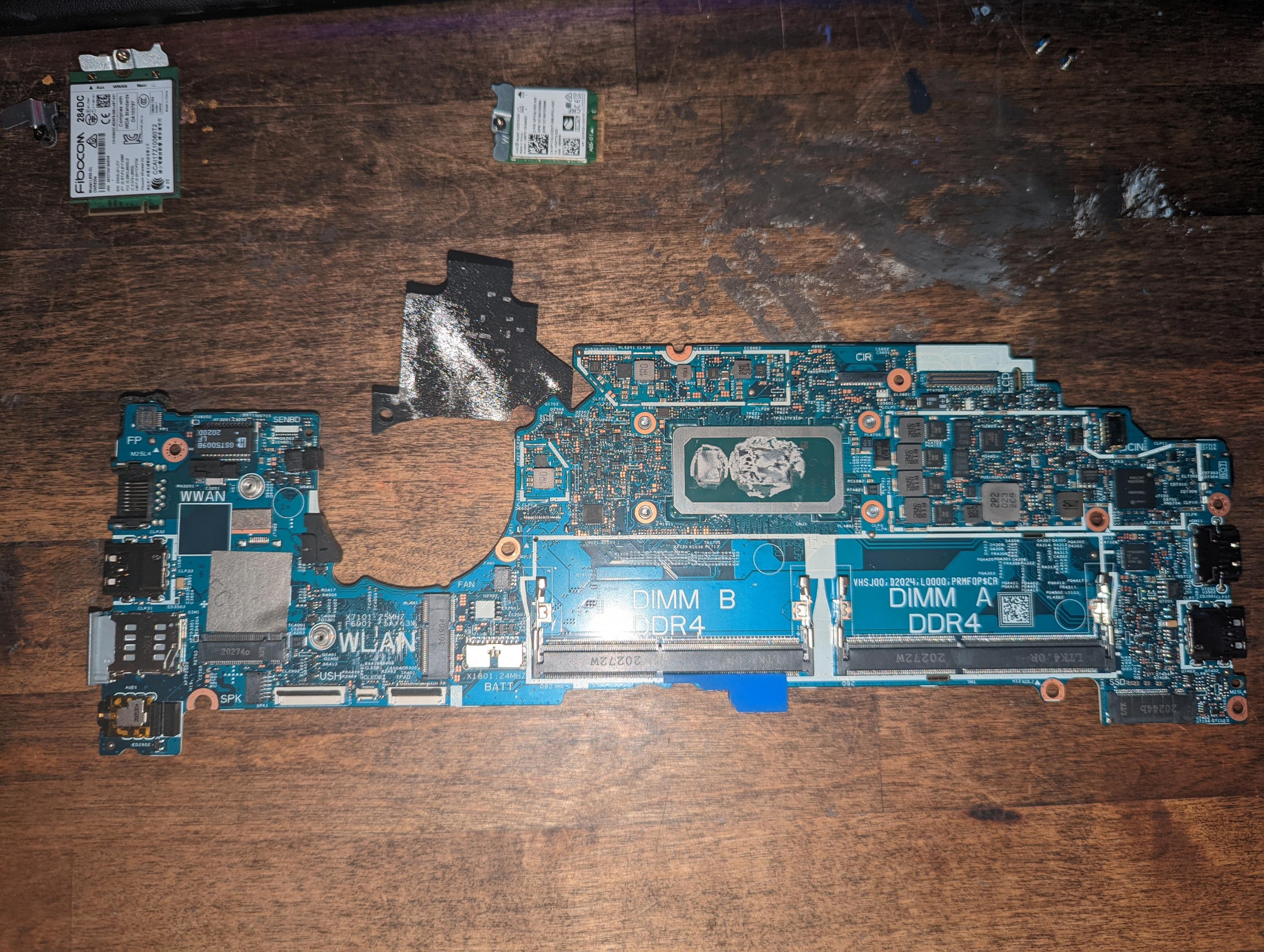

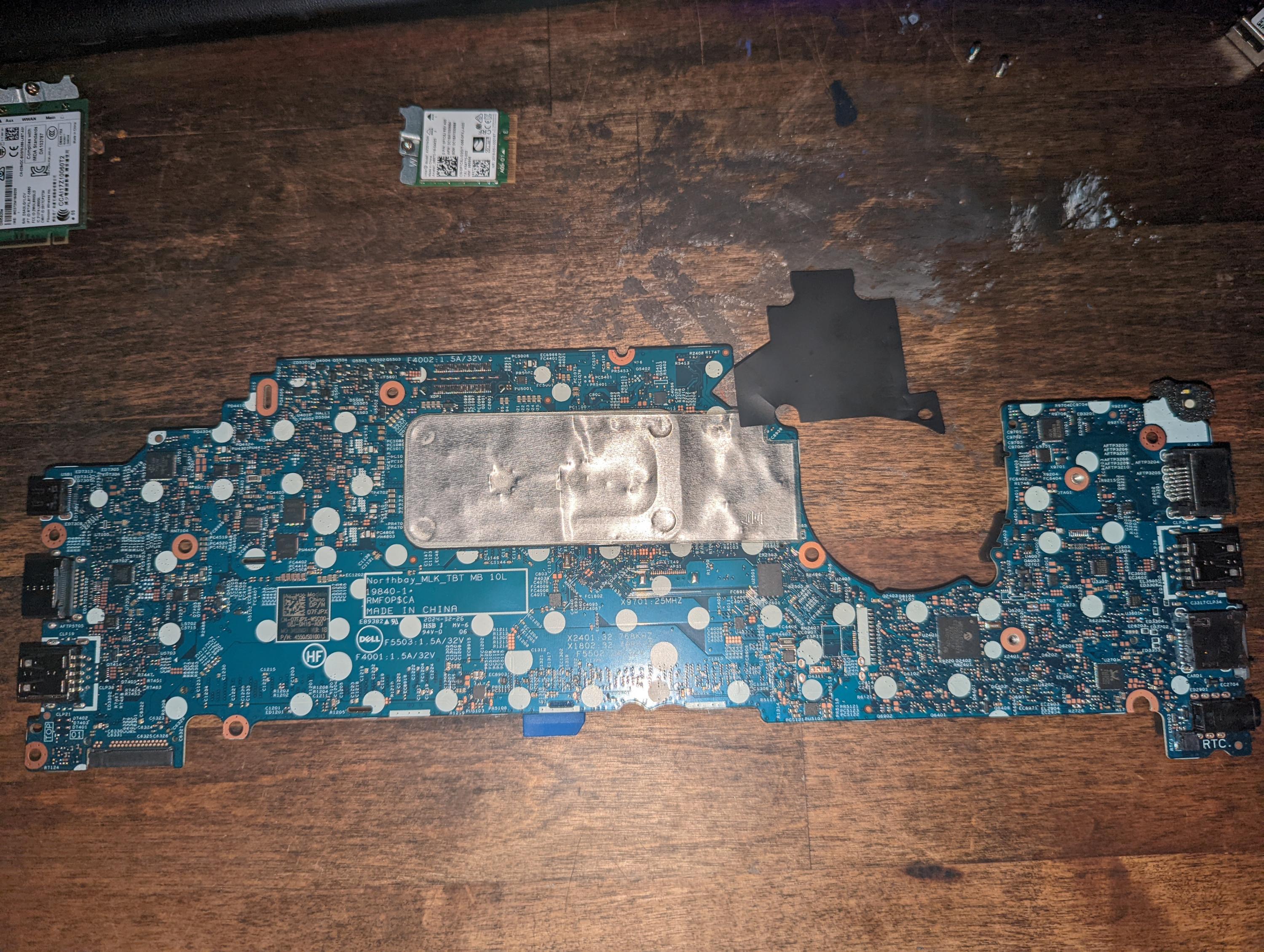

where is my bios chip pics included dell 5310
  • jaydang
    • Jun 2022
    • 6
    • usa
    images attached

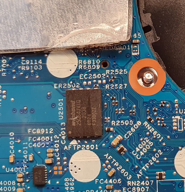

    Re: where is my bios chip pics included dell 5310
    Probably U2501, i need marking of that ic
      i could not find u2501 anywhere only u2502 and its blanch with no chip.
      also which chip do you need marking for and i can get that for you not sure which is ic

        IC is integrated circuit. U2501 is located under right edge of the foil that covers cpu backplate.
          awesome i found it the bios chip, still not sure which the ic is located on board if you direct me i can find it for you.
            I just meant that bios chip is also an ic, cuz it have complex internal structure.
              xmc qh256bxiq pp832300 01 2004u f08. trying to disable computrace thanks for all the help

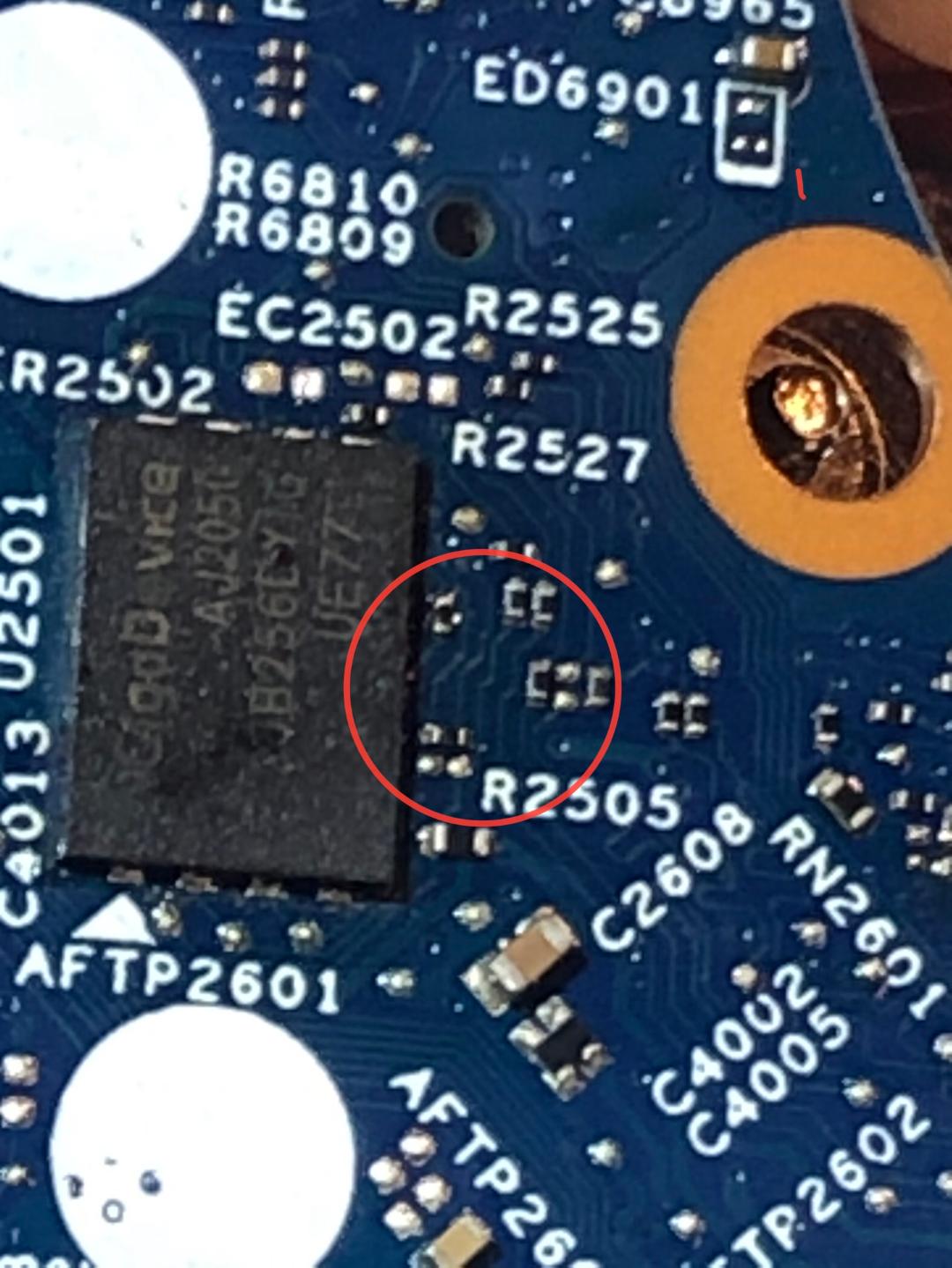

                Hello
                Ineed to know if marked resistor it is placed in proprer positions.near bios chip 25b256d
                Thank you
                Dell latitude 5310 i5gen10
                Northbay_mlk_non- tbt mb10L
                19842-1 g23p6$ka
                  Originally posted by girolamo
                  Hello
                  Thank you
                  19842-1 g23p6$ka
                  This is the correct placement
