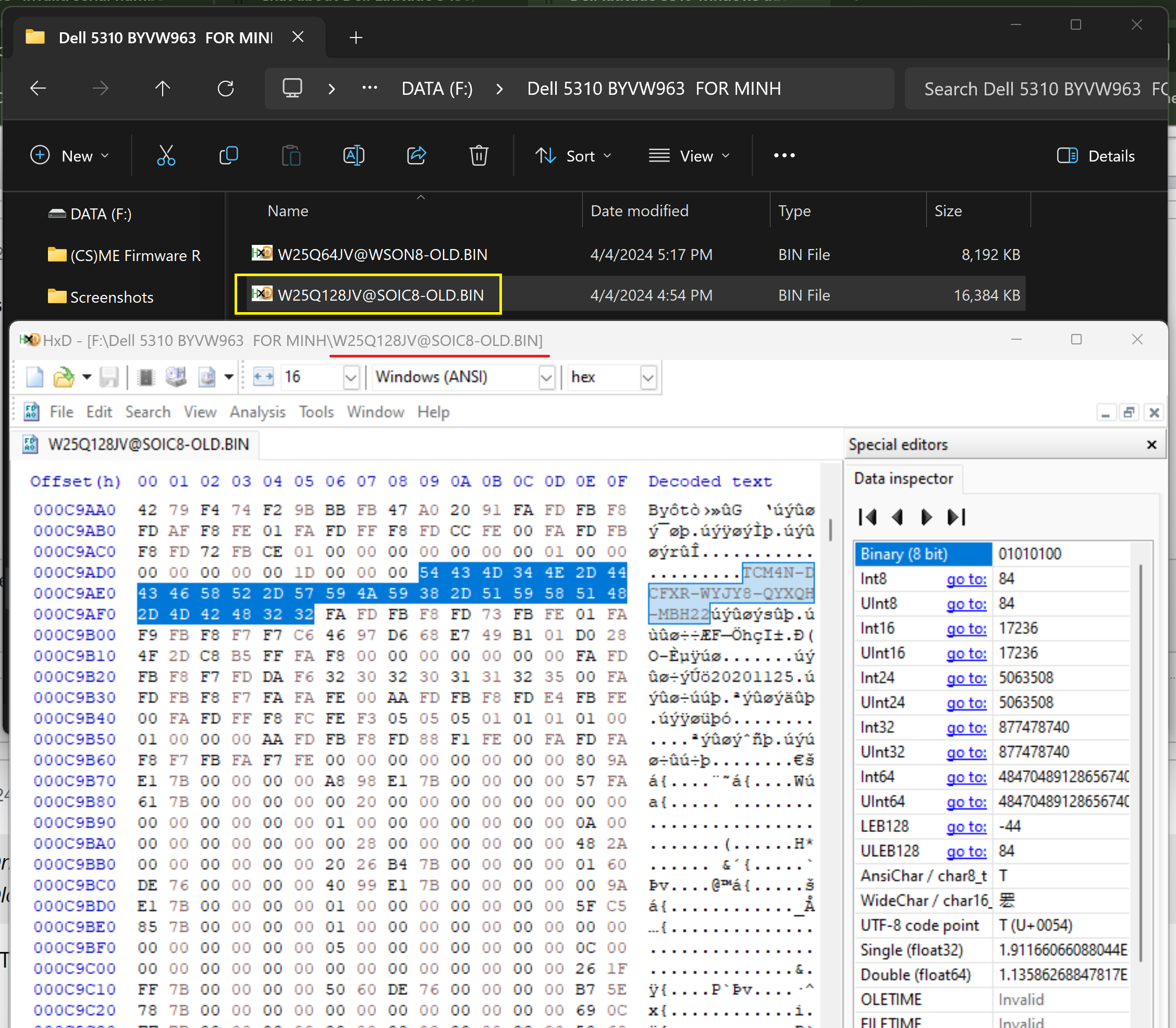

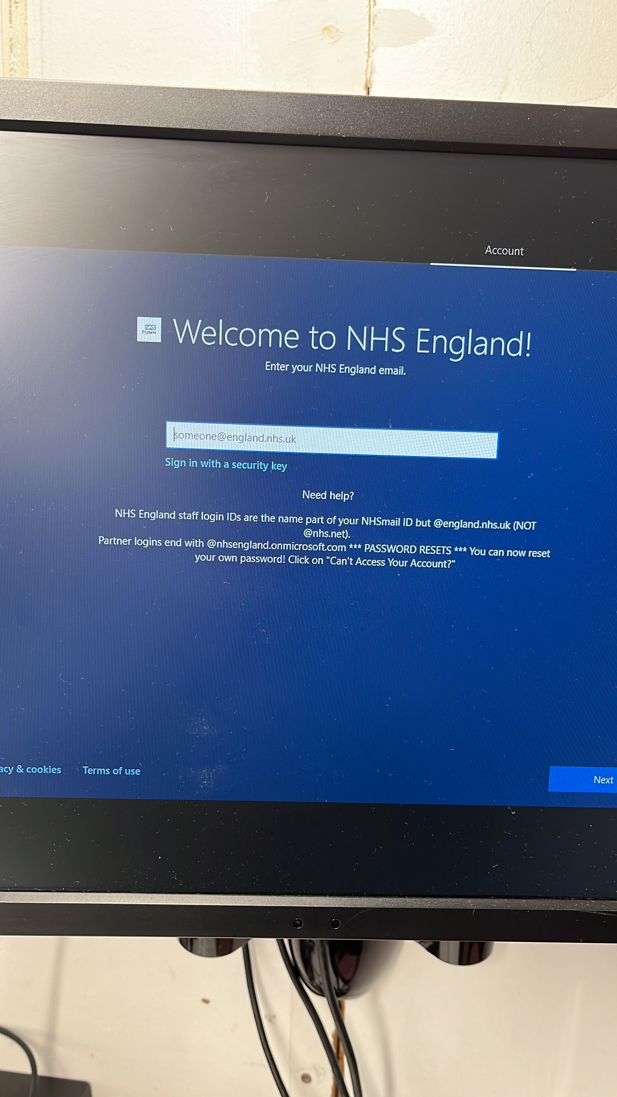

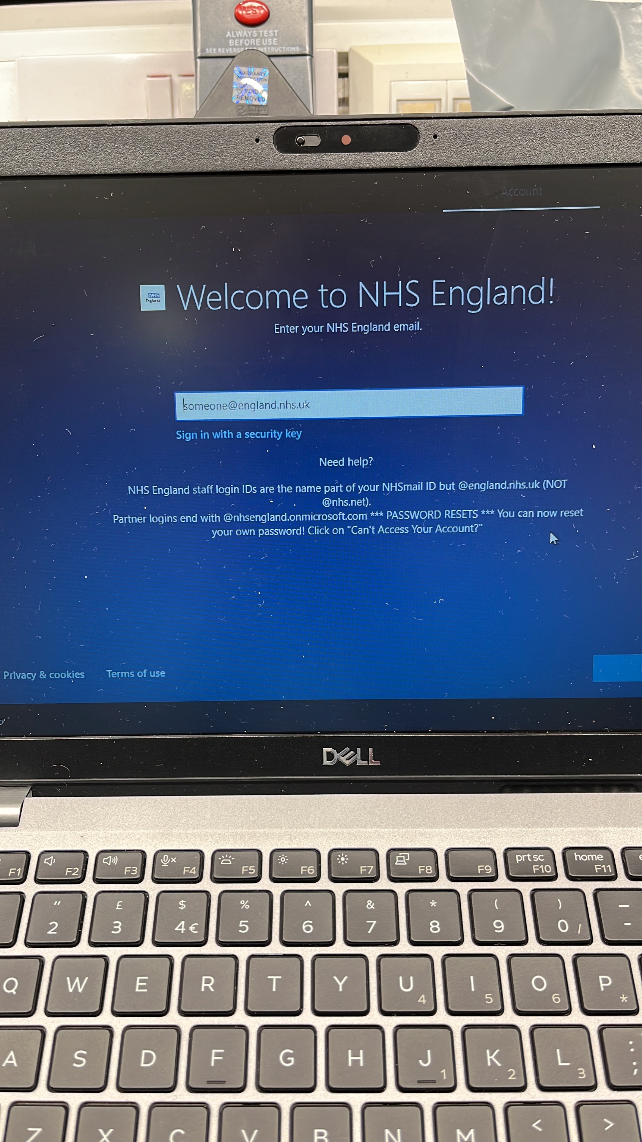

    I have laptops with problem windows autopilot does anyone know how to solve this problem
    I can install Windows if I indicate that I do not have the opportunity to connect to the Internet. But I would like to remove it completely Dell latitude 5310
    Dell latitude 5310
    motherboard Northbay_MLK_non-TBT MB 10L 19842-1
    service tag BYVW963

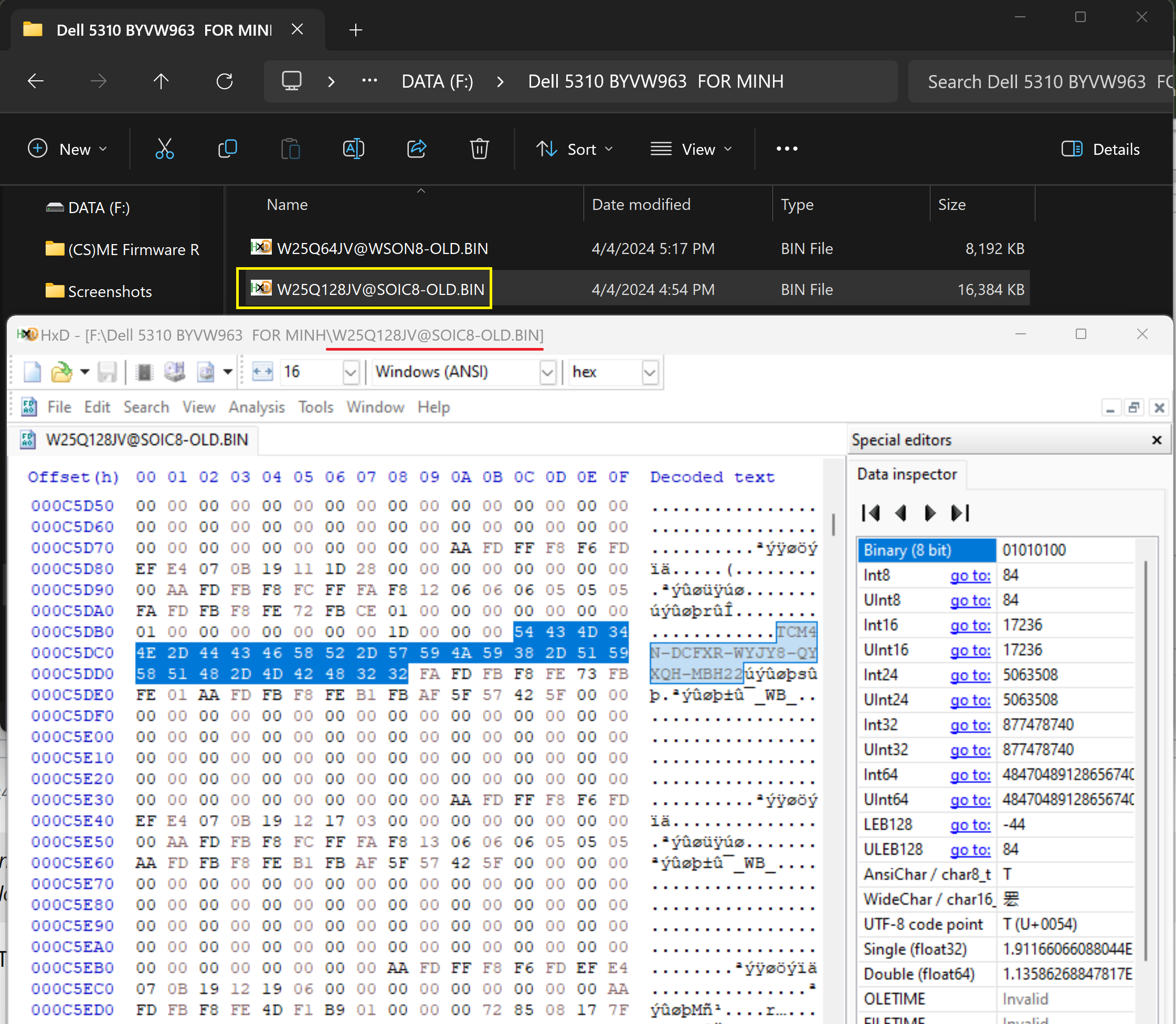

                  hi the same problem if i install Windows 10 pro but when installed Windows 10 home without problem i think need put Windows 10 key in bios
                  • hoaca388
                    Badcaps
                    • Jan 2022
                    • 11713
                    Look at the pictures
                    • reamon
                      • Aug 2020
                      • 24
                      • United Kingdom
                      thanks for the help and advice, I will replace the key in the bios with Windows home. I did not know that the key was registered twice

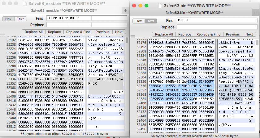

                              Hi Please,
                              Could you help me with my Dell Latitude 5310 Service tag: 3xfvc63
                              It has autopilot, I am trying to change the asset tag, I believe that would help.
                              All advise appreciated. Thank you.

                                the other chip
                                • TIOP
                                  • Mar 2024
                                  • 7
                                  Originally posted by danito
                                  the other chip
                                  Thank you so much, I am trying to read that chip but the clamp always slipping of, I hold it on the chip still cannot detect it, but the NeoProgrammer knows the 25Q64JV chip. As soon as I managed it will post the reading. (I might need to buy a different programmer.)
                                  Thank you.

                                    No need to change Asset tag, just delete AUTOPILOT MARKER and invalidate it (is in 2 places)
Name:	Screen Shot 2025-01-21 at 17.18.18.png
                                    • TIOP
                                      • Mar 2024
                                      • 7
                                      Thank you so so much, that is a really big help!
