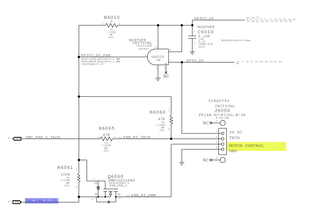

    Hello, i have a Macbook Air A1466 820-000165 where the fan is constantly running 6200rpm, as soon as i hit the power button.
    I already tried a different fan, reset of SMC and PRAM. No difference.
    So i measured the voltage on the connector
    1:5V PP5V_S0
    2:1.6V TACH
    3:4.6V Motor Control
    4:0V GND
    I checked HW Monitor temperatures are in the normal range, no missing signals.
    What can i check next?

    Measure the voltages on the following:
    SMBUS_SMC_3_SDA
    SMBUS_SMC_3_SCL
    and post the readings.

      Thank you for the fast reply. Both signals are 3.3V

            Focus on mosfet @ Q6060. Apply flux and reflow it.
            Confirm the resistance and presence of R6061.
            Confirm the connections in this area to the fan connector.

              I already found that thread and switched with a known good one.
              Resistance of the Resistors in this area are right.
              Then i reflowed it as best as possible with the connectors nearby, but no difference.
              I also measured from SMC_FAN_0_CTL to R6061 using a testpoint on the backside near C7601 and i get 400/500KOhm depending on which side of the resistor i measure. But reading the schematics there should be no resistance, since it is a trace on the board. Or am i thinking wrong?

                Confirm prescence of fan tach using a scope to the SMC. If it’s missing, fan will be driven at full speed.

                    I already tried another Fan. I have no scope to Check tach but with mac Fan control it displays RPM Signal.
