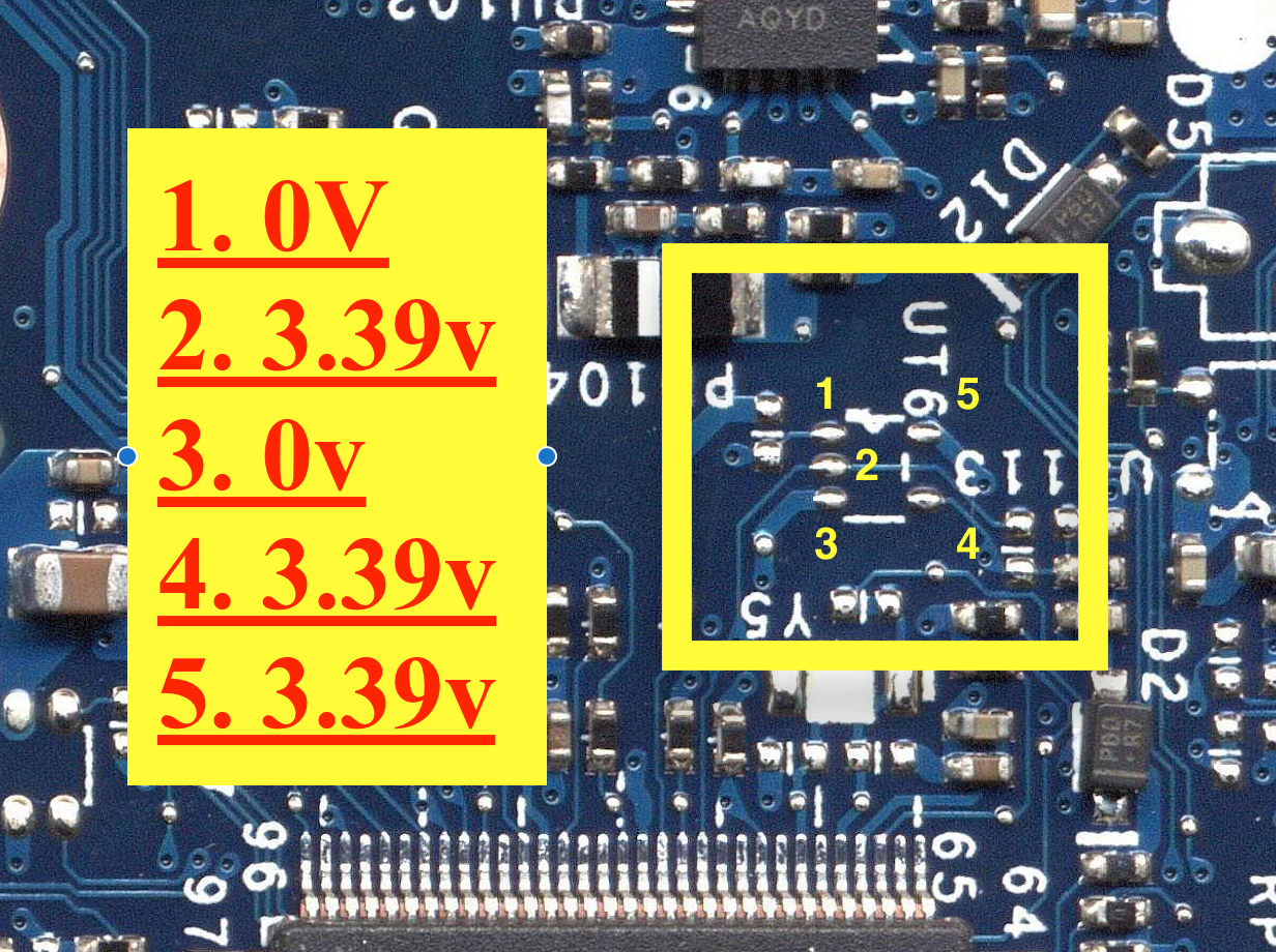

    Measure and post the voltage readings of each pin of UT6 AND gate.
    • sikocan
      • Oct 2019
      • 344
      Re: Ask HP ProBook 450-G2 No Backlight LA-B181P
      The readings are:
      1. 0
      2. 3.39
      3. Ground 0
      4. 3.39
      5. 3.39
      I could be wrong on numbering, there is no IC in this location, just pads. I've attached the image.
          Ok. Appears to be not stuffed so is bypassed.
          Confirm the voltages to ground on pins 8 & 9 on the LVDS connector.
