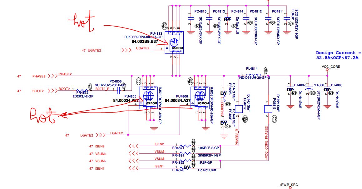

    hi
    inspiron 1540 comes withe black screen and 7beep
    first i flash the bios but same problem
    then i check CPU vcor
    vcor appears but goes off after 5 seconds and mosfets becomes very hot
    i check all the mosfets and caps in vcc track no shorts
    i change ISL62882 becasue the origin one has damaged pins
    but same problem the laptop powe on the cpu becomes hot the vcc core appears but goes off and mosfet on phase 2 becomes very hot .
  • mo000
    • Nov 2017
    • 273
    • algeria
    Re: DELL 1540 black screen
    the problem solved
    the replacement ic is defective
    i return the original ic and solder the missing pins
    vcor appears
    the laptop works fine now .
