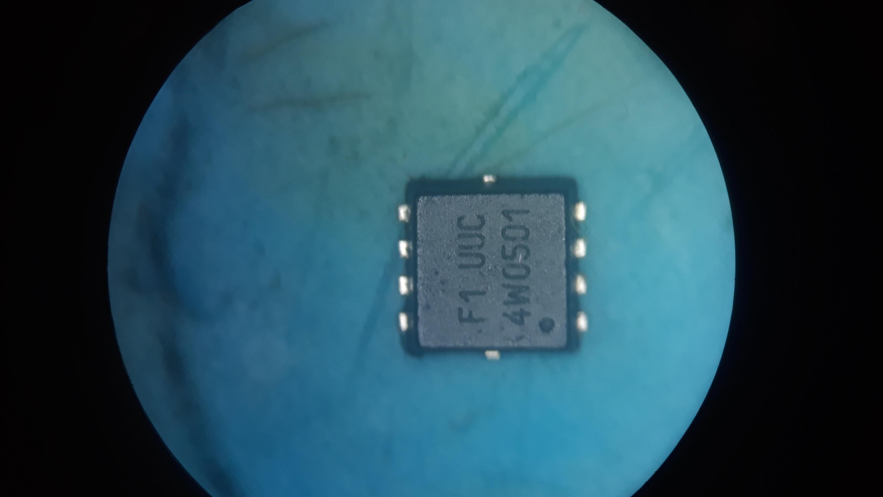

Help me find the value of this mosfet. Asus FX506L Board code is: DABKXDMB8E0
  • vienzen
    • Feb 2015
    • 112
    • PHILIPPINES
    Help me find the value of this mosfet from a Laptop Asus FX506L
    Board code is: DABKXDMB8E0 REV. E Thank you
    • 21577
    Re: Help me find the value of this mosfet. Asus FX506L Board code is: DABKXDMB8E0
    F1 *** PE600BA
    https://www.badcaps.net/forum/showpo...65&postcount=4
    Datasheet https://www.badcaps.net/forum/showpo...91&postcount=4
