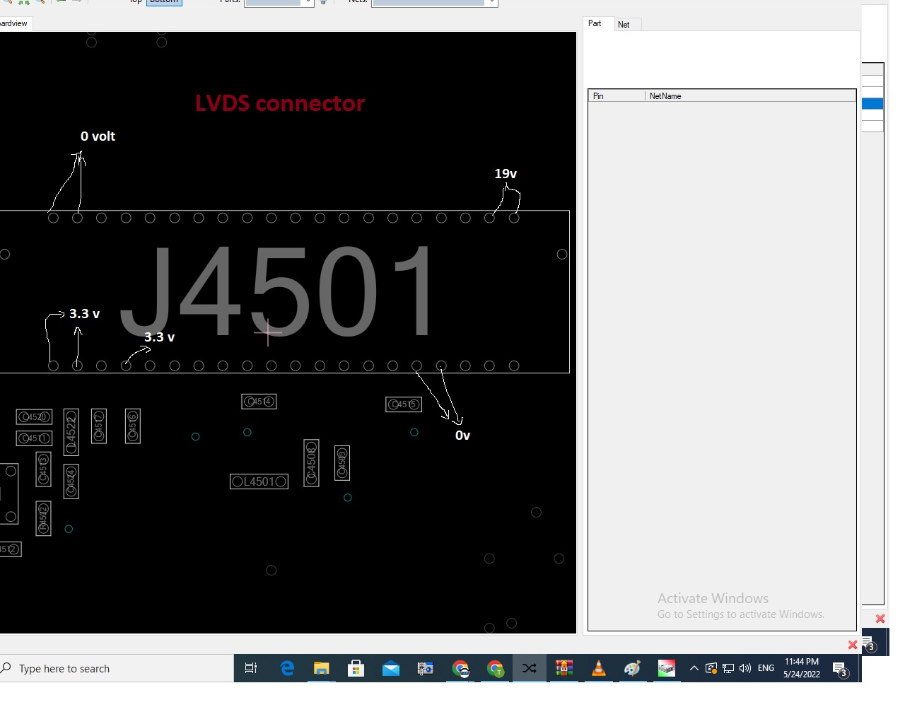

please help toshiba c850 no display just work on external
  • doctormasry
    • Dec 2019
    • 108
    • giza
    toshiba c850
    plf/plr/csf/csr DCS mb rev :2.1
    no display but it work in crt conn

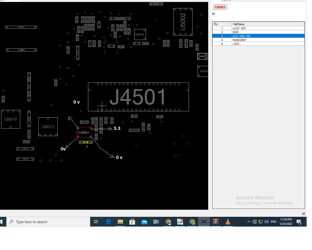

    when i connected to lcd monitor (crt external ) work good and data and boot win
    but there is no data on it's monitor (internal)
    i changed screen but no new
    i changed i/o but no new
    reprogram bios but no new
    two pictures attachments for LVDS connector voltage measurement
    thanks

            The dude in the video is using hot air to temp fix the the video controller. If your unit has one then he is claiming that 99% of the time it is the fault.
            Perhaps consider to test in the same way with the heat gun to see if your LCD comes to life or not.
            BTW: Do unplug the adapter (which he did not do) in this video while he was working with the logic board.

              thanks for you @mon2
              i converted it from dis to uma and work well
              thanks again pro
